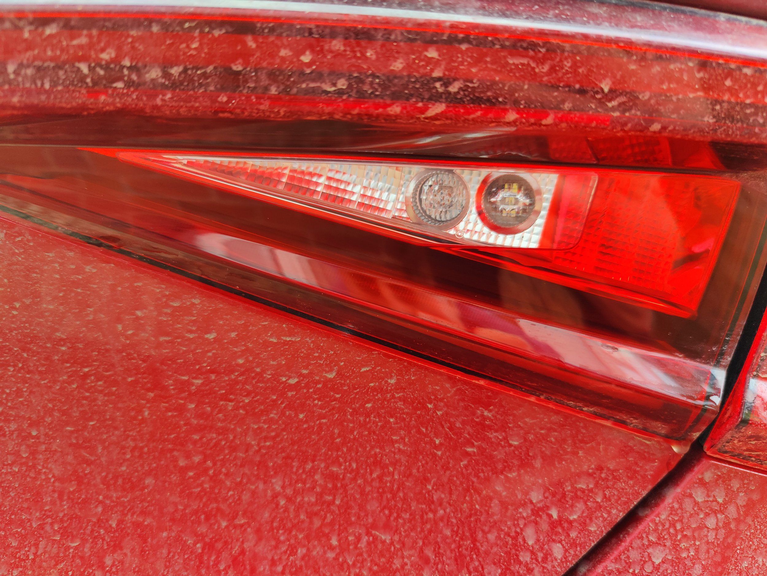

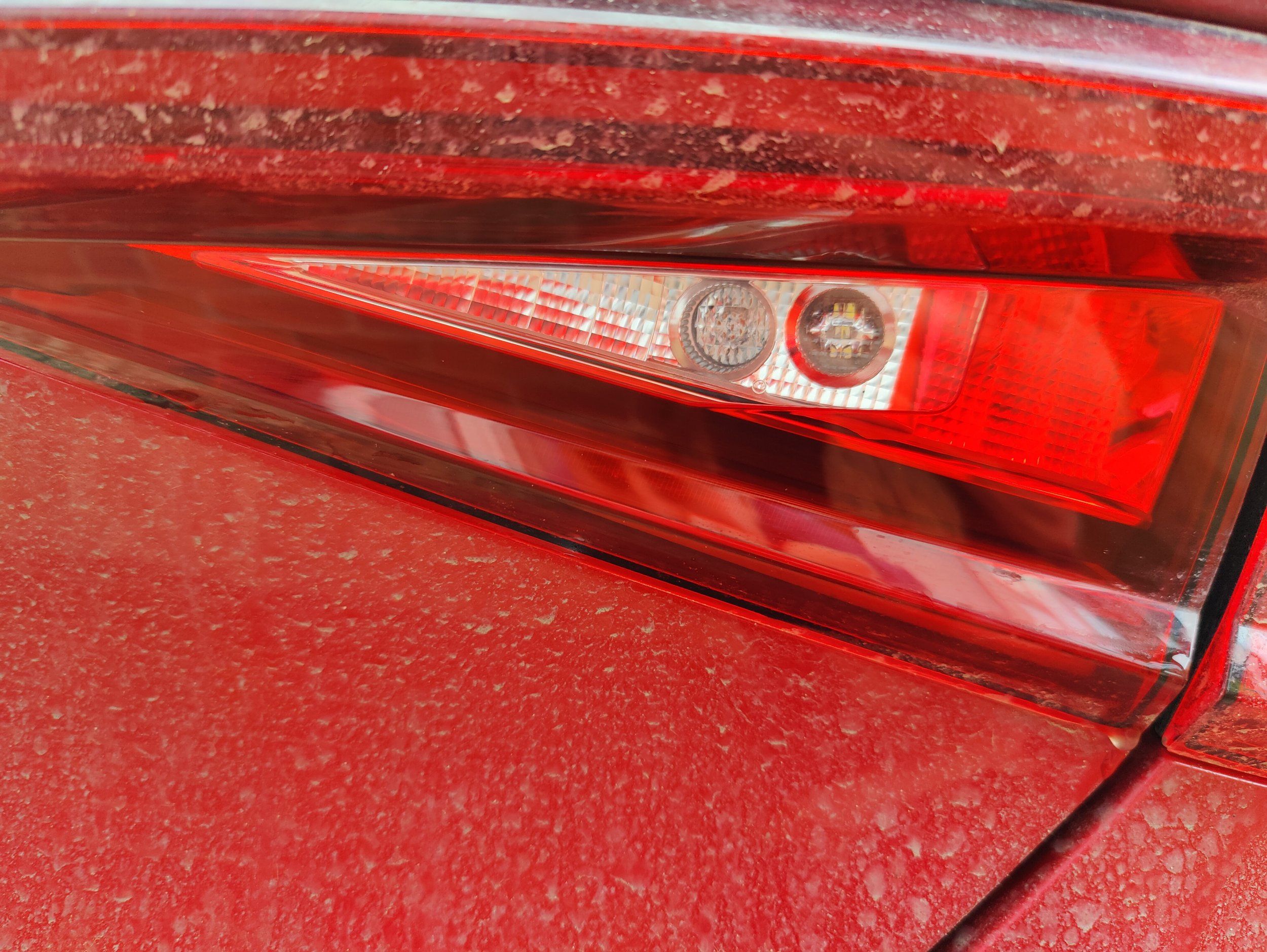

Off:

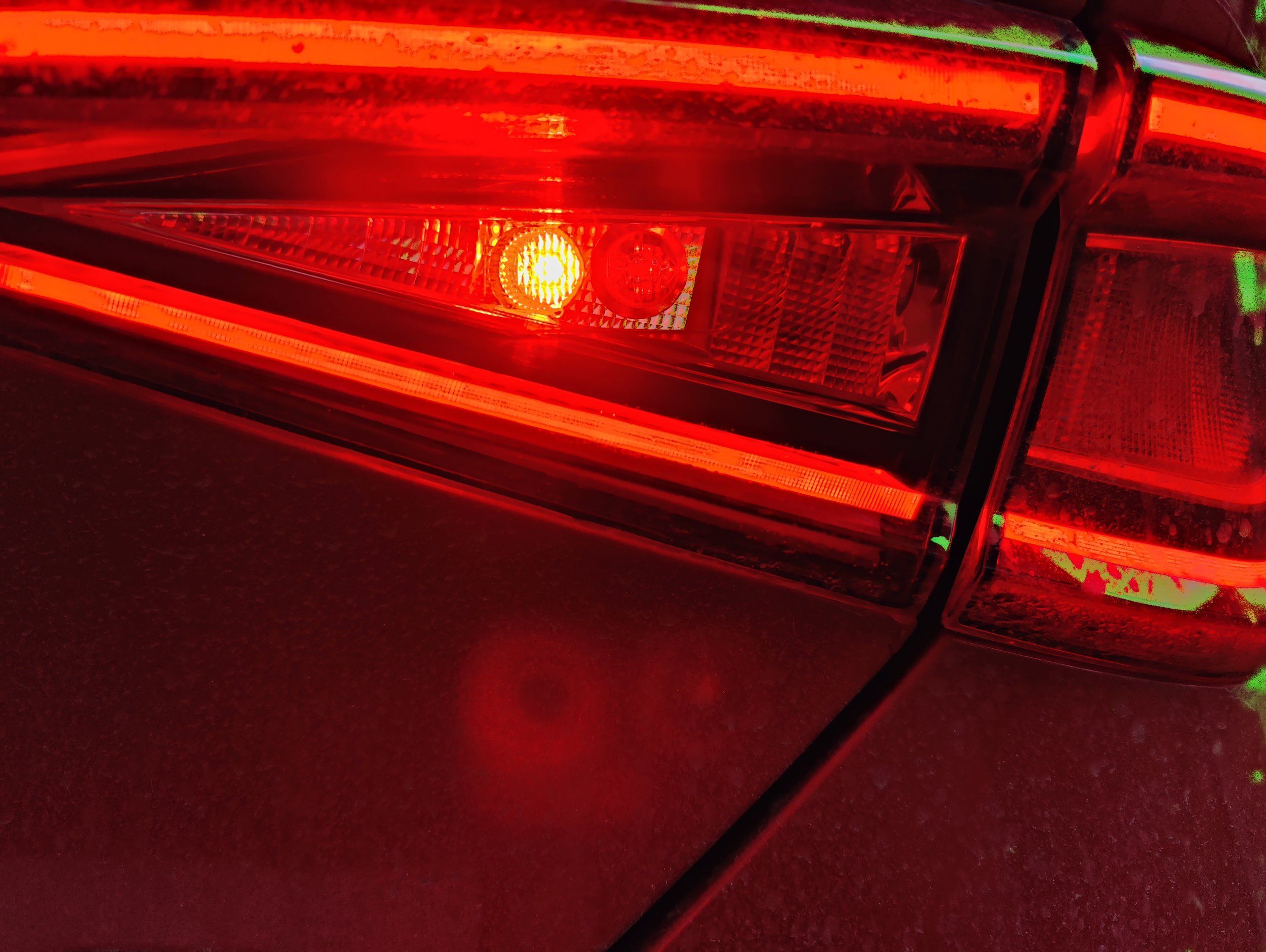

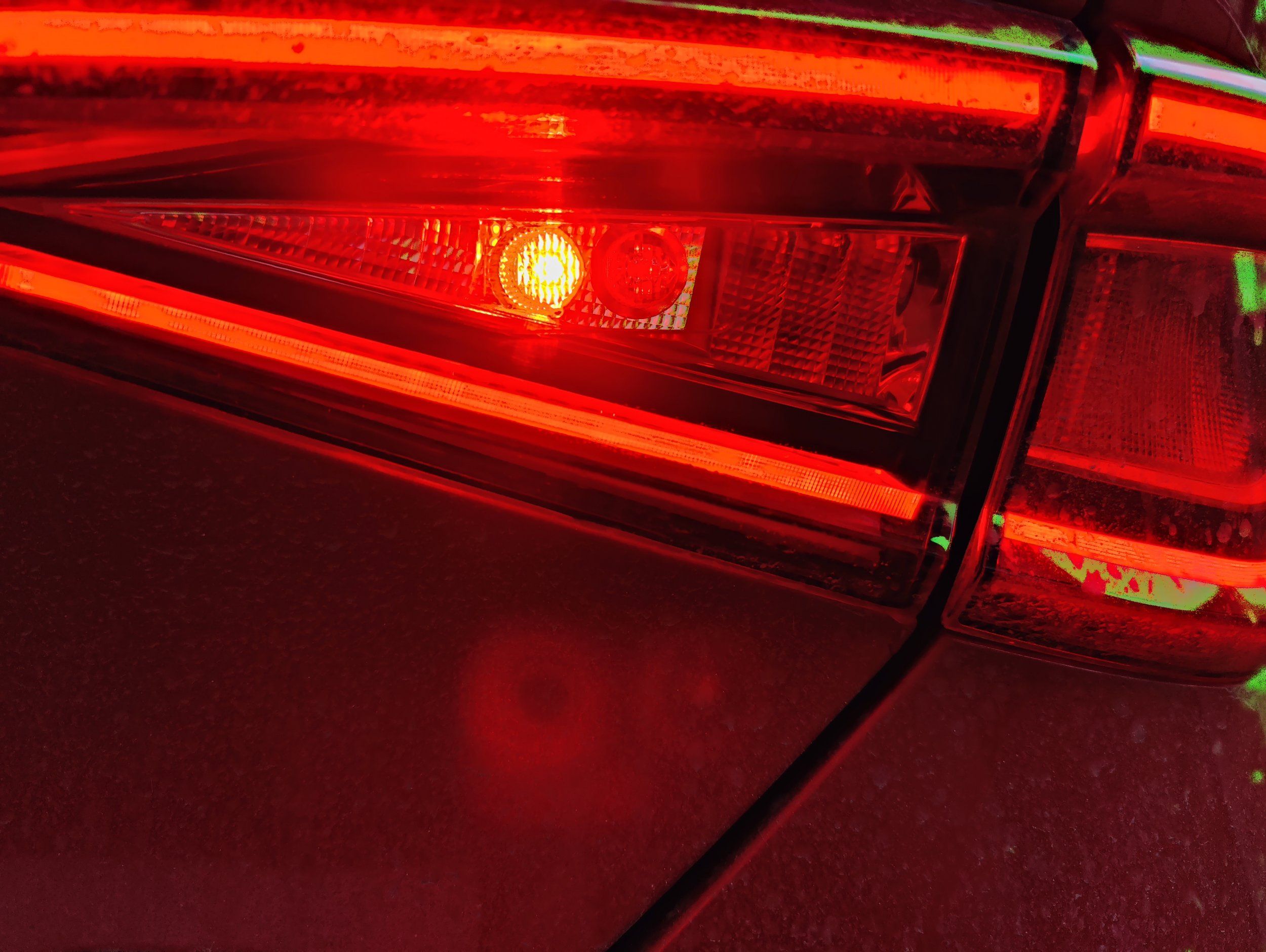

Fog light(only on driver side, UK spec):

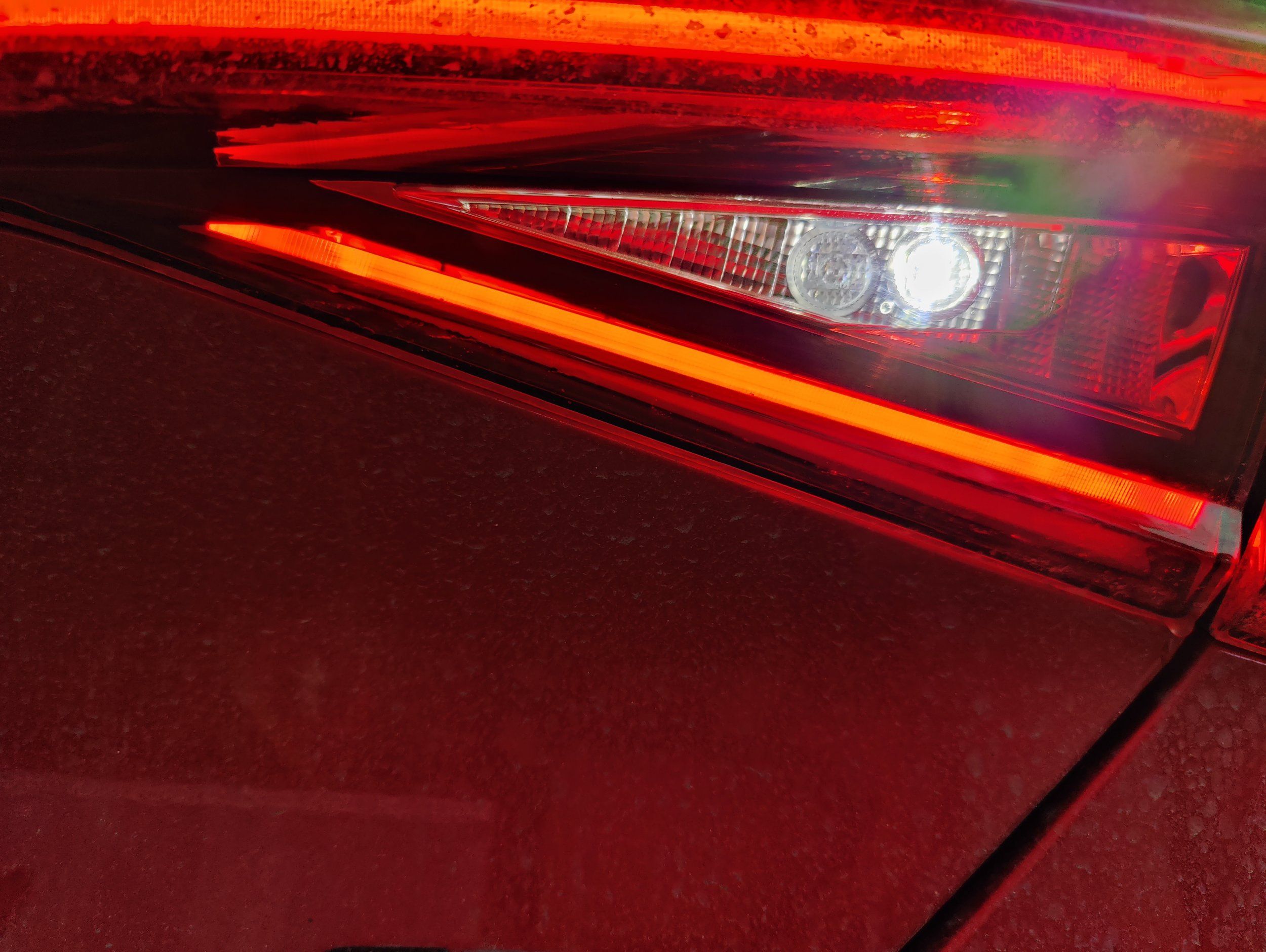

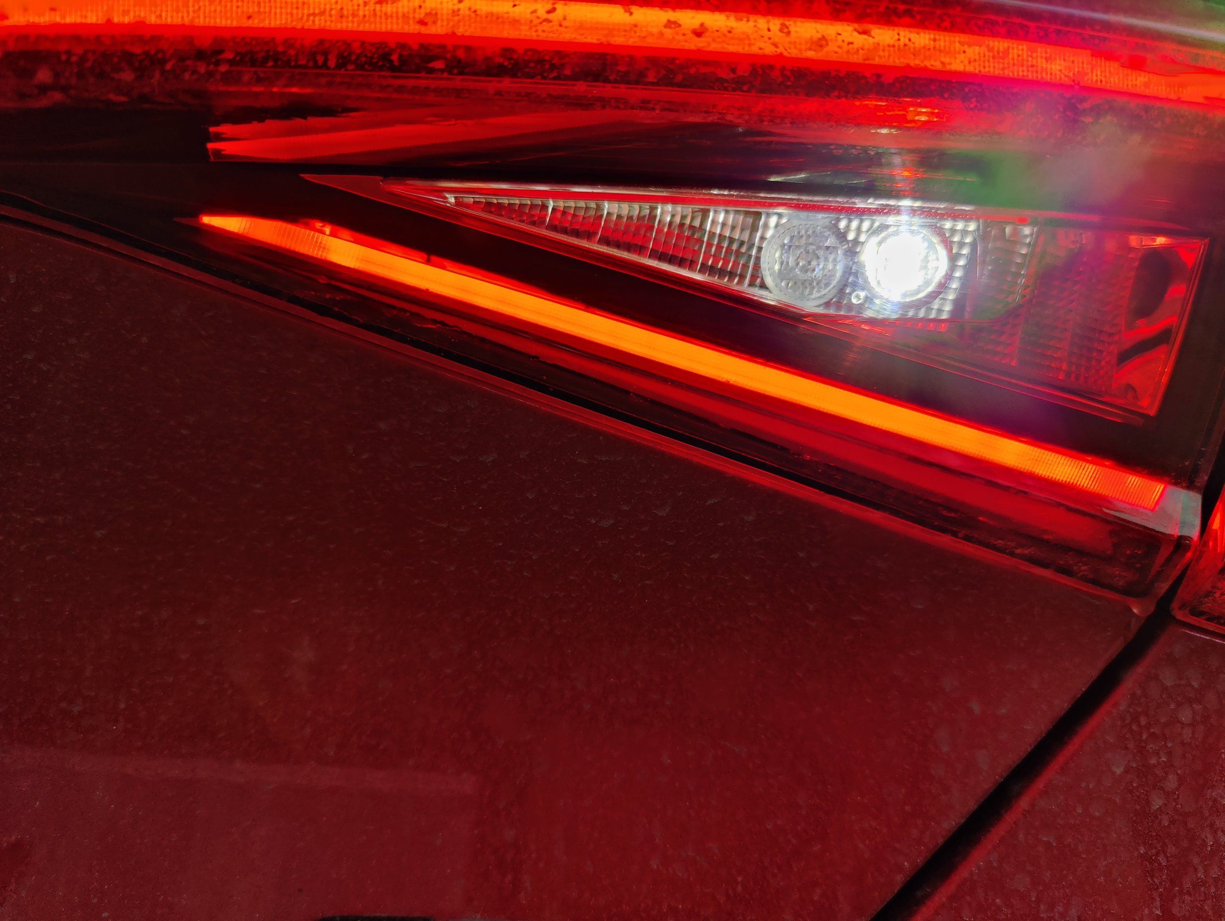

Reverse Light:
The reverse Light on the driver's side does not turn on if the rear fog light is on, (The passenger side reverse light still does turn on)
It looks like there is only a single LED behind the lense.

Off:View attachment 30797
Fog light(only on driver side, UK spec):View attachment 30798
Reverse Light:View attachment 30799
