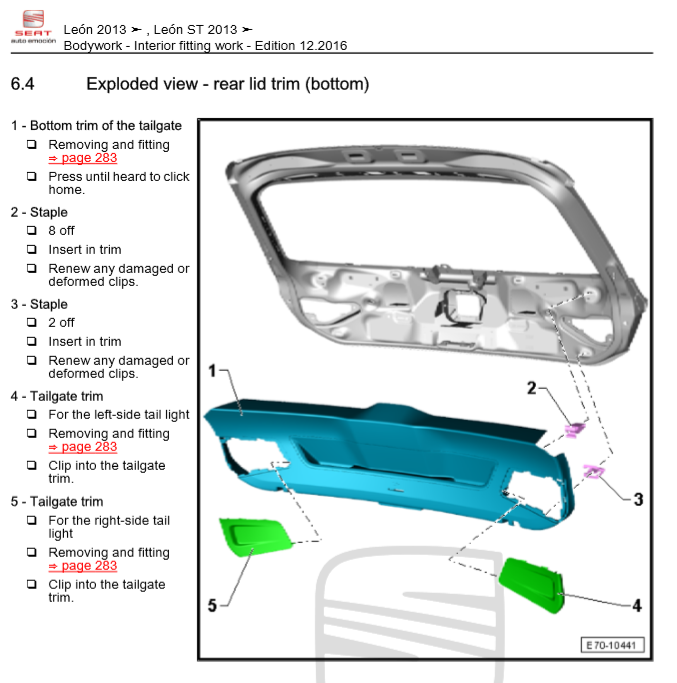

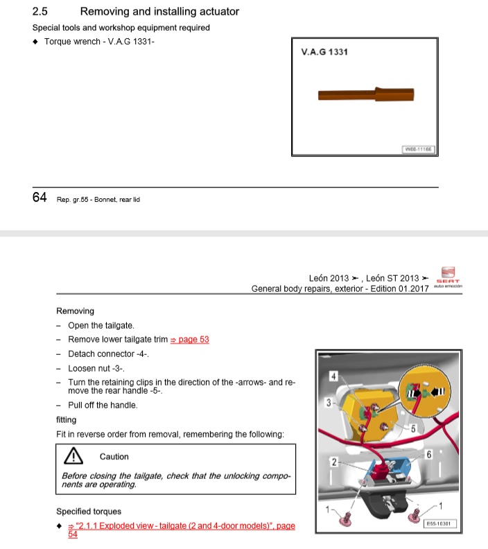

black_sheep
Mar 10, 2013
1,252
587
Actuator removal here...
Exploded view here...
Rear trim removal...
Reactions: zedlor
