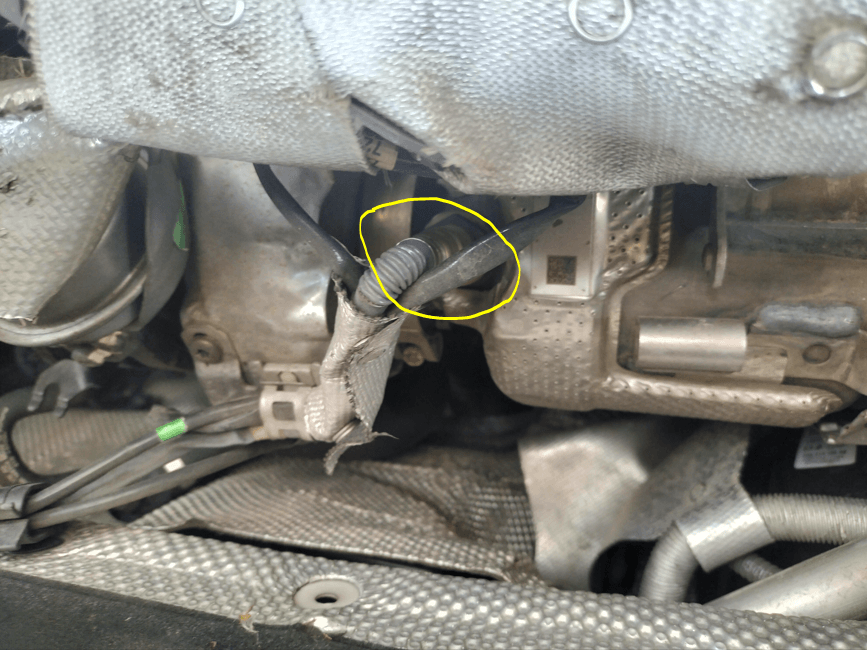

The location of the sensor to be replaced was, like I said above, at the back of the engine bay and is quite easily accessible.
First I undid the small thermal blanket just below the circled area above which allows you to separate the O2 sensor cable from the other two nearby cable harnesses that are unrelated.

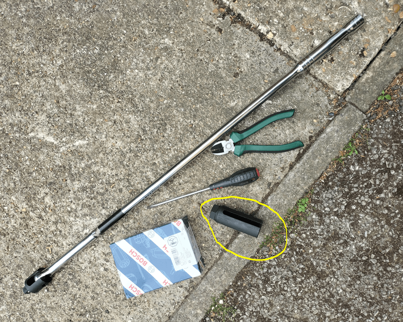

Then I used the special socket tool (another few quid) and my long breaker bar to get the old sensor out. I've heard stories about them being stuck in, but this one didn't take much force at all to get loose.

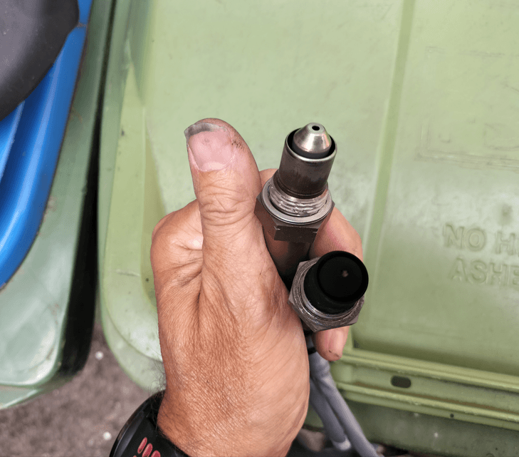

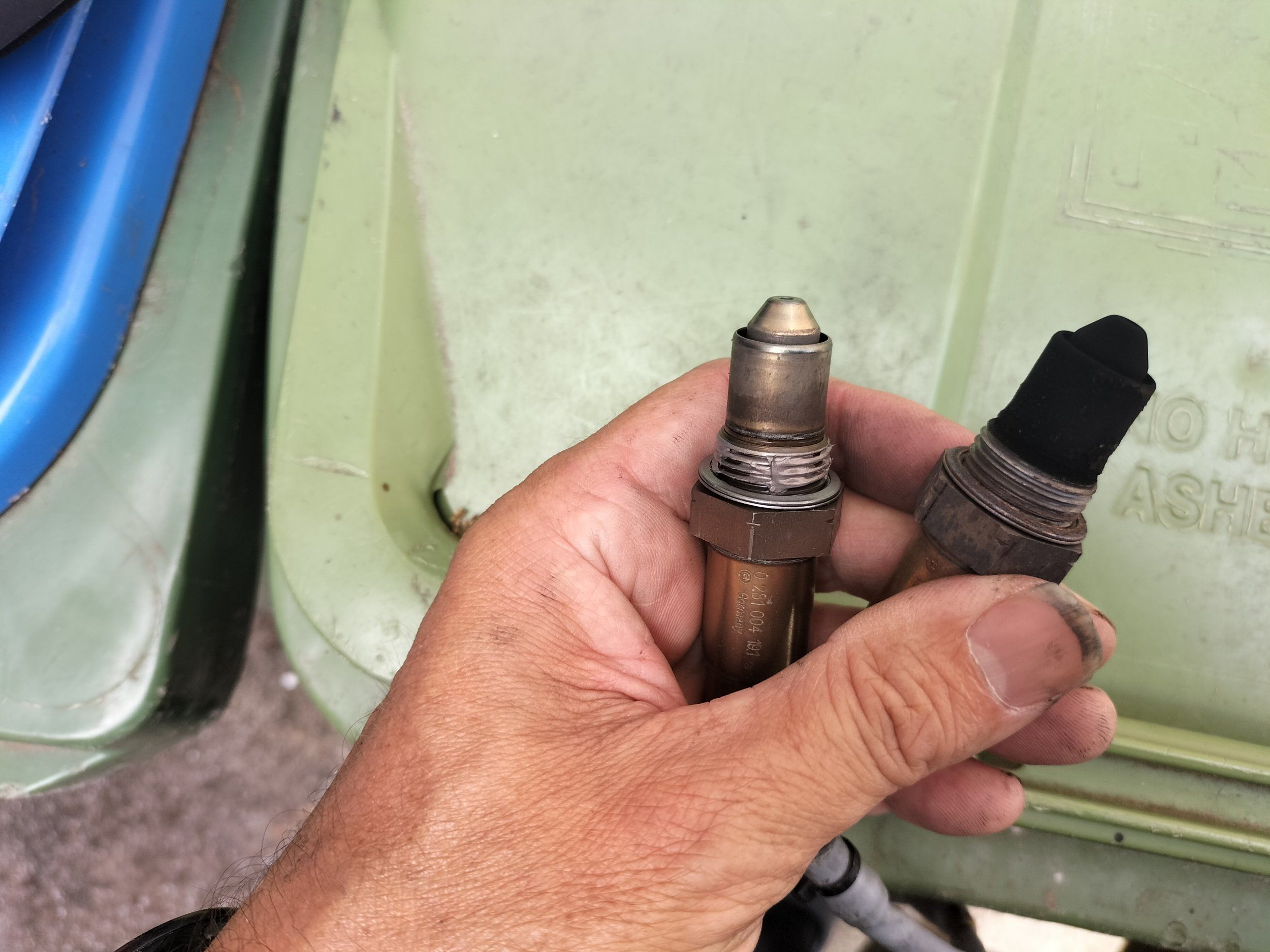

It definitely was knackered - can you spot which one came out of the car! :D

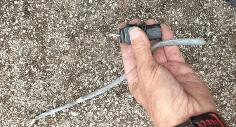

Here's the other end of the old cable with the connector that I snipped off..

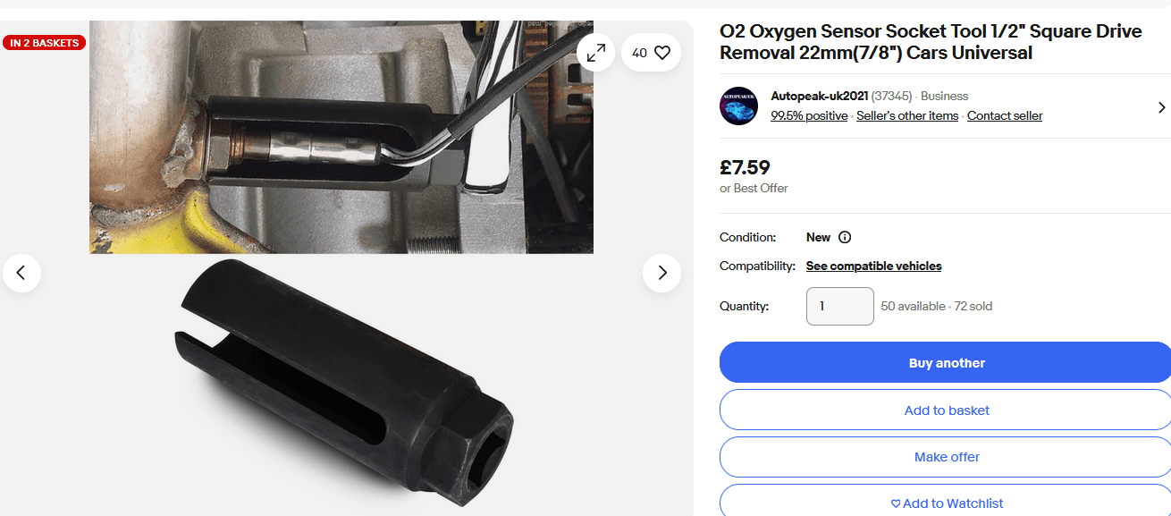

Oh - this is the socket tool I used that helps get it in and out: ok, worked but the slot of this exact one is a bit narrower than it should be (chafes the harness outer sheath which no one really wants ideally!)

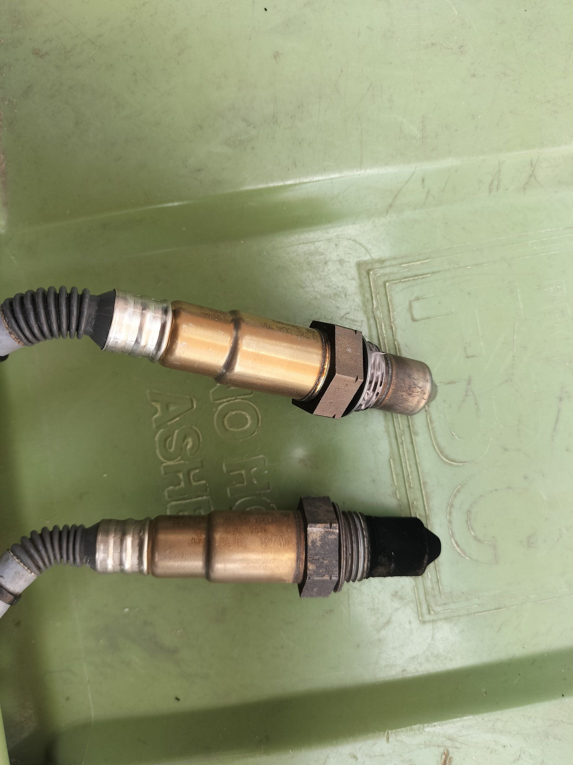

Bonus pics of new vs. old O2 sensor.. This is hopefully only looking like that because it has done over 100k miles!

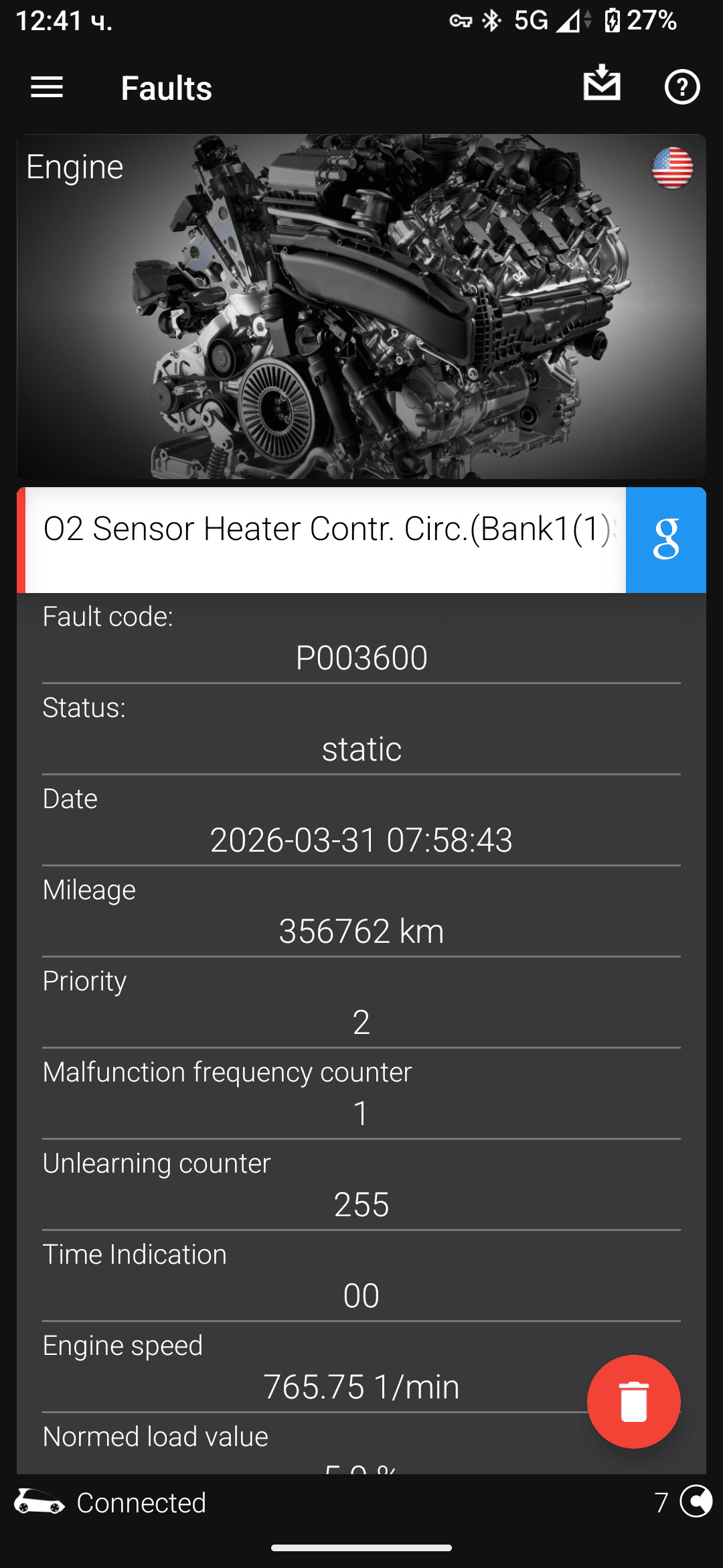

I have problem with my oxygen sensor bank 1 sensor 2. 3 times already replaced and everytime getting different errors. First one Delphi brand and p00360 which say problem with heater. After that i replaced same brand again with Dephi working for 4 weeks with no problems and after that first error came malfunction low voltage. Now replaced again with Hella brand and getting again same error as first p0360. Anyone have any idea what to do next? Seat Leon St 1.8 tsi engine 2014

Thanks I will check, but I up image of code anyway. It's little bit strange, coz every time after replacement showing different error codes. And the price of them are like between 35 euro - 55 euro, Hella and Deplhi tried.

I would think that the original probe was an NTK branded one, which is what NGK brand their sensors as, it has been said that certain VW Group engine management systems are quite fussy about which brand of sensors you use as replacements.
I've only ever replaced one Lambda sensor, and it was a VW Group service part, which was NTK as was the original one that had failed after maybe 10 years and 90,000 miles in a 2002 VW Polo 1.4 BBY petrol engine.
Edit:- I did my homework and getting a genuine NTK sensor to my door was roughly the same price as getting one from my VW dealership as a re-branded/re-box part.
Some sensors can be quite fussy, had the same with our old VW Lupo. It would not accept a Hella O2 sensor, so in the end I just left the original one in (probably also NTK or Bosch).
It might be worth a shot to try either OE or NTK before you decide to do something else. Also check the wiring/connector if possible

Thanks, Fuses checked they look good. Today I also check the connector cables, I mean connector which coming from the car not lambda connector I what I see there is a 4 pins wich 1 of them look silver, all other 3 gold color. The white one is a silver that what I can say for today. Also like I said old lambda which is a brand new worked only 4 weeks with noo problems I make a test on her with multimeter 2k ohms on the 2 white connectors it's say 0.008 which sounds like fail test.
