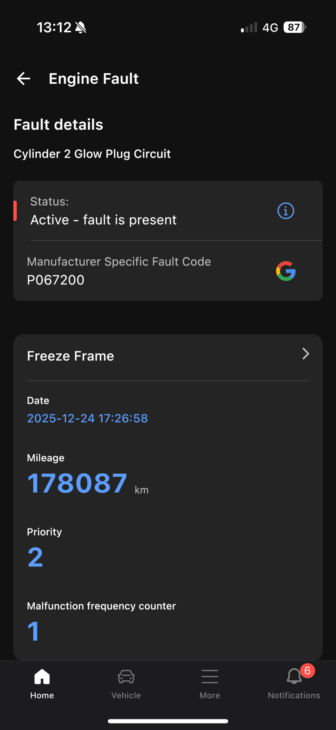

My SEAT Leon 2.0 TDI 2015 (5F1) has a faulty glow plug, I am trying to work out whether its the glow plug with the pressure sensor (which costs £210 from Euro Car parts!!!!)
I used my OBD11 to diagnose the fault and it says its the glow plug in cylinder 2 (see screenshot below)

edit# to add - that fault code could also be the glow plug control unit.
First - disconnect the connector & check number 2 glow plug resistance - between pin 1 and the glow plug housing. It should be between 0.2 - 1.0 Ω
If it's not then need a new glow plug.
If it is, then you need to check the wiring - checking the resistance between pin 1 and 102 of the glow plug control unit. Should be less than 1 Ω
