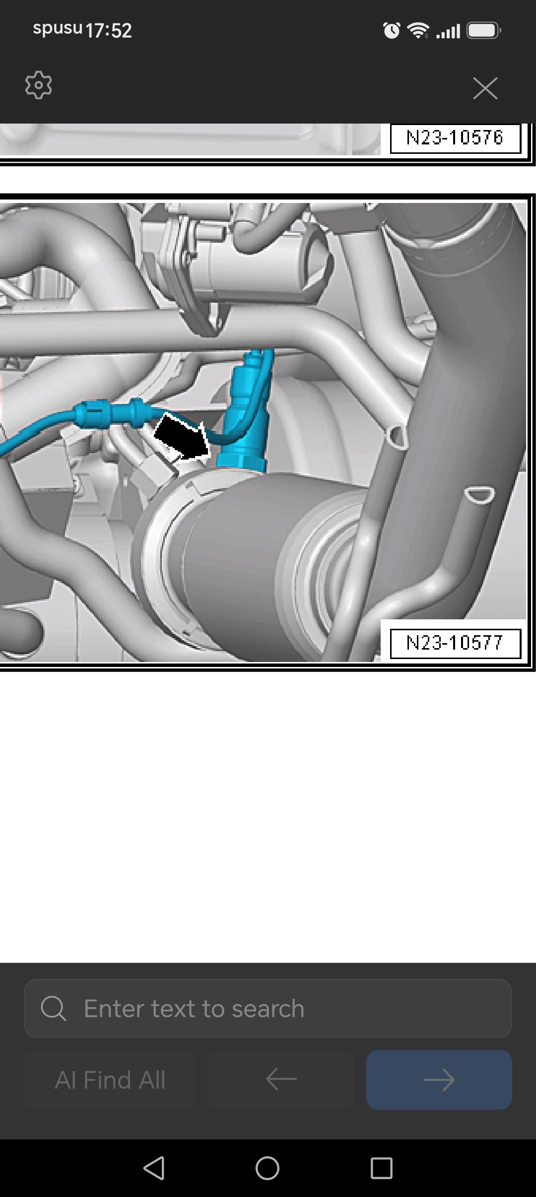

Looking through that manual that nd-photo.nl shared, p.472, I can see a mention of a 2nd lambda sensor. And from this photo, perhaps it is the awkwardly placed sensor just before the flexible section of exhaust.

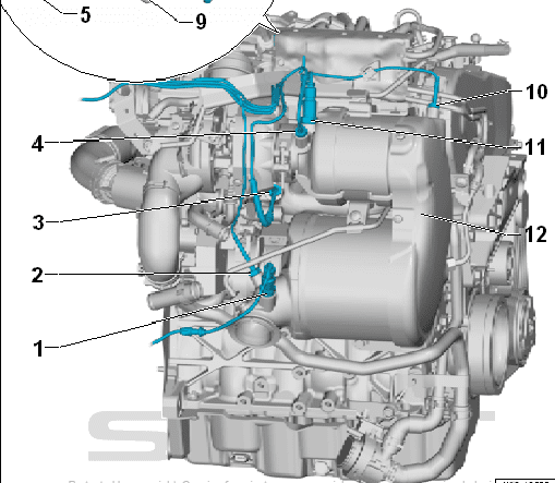

For the OP, 11 is your pre cat O2, and 1 is you post cat O2 sensor.
