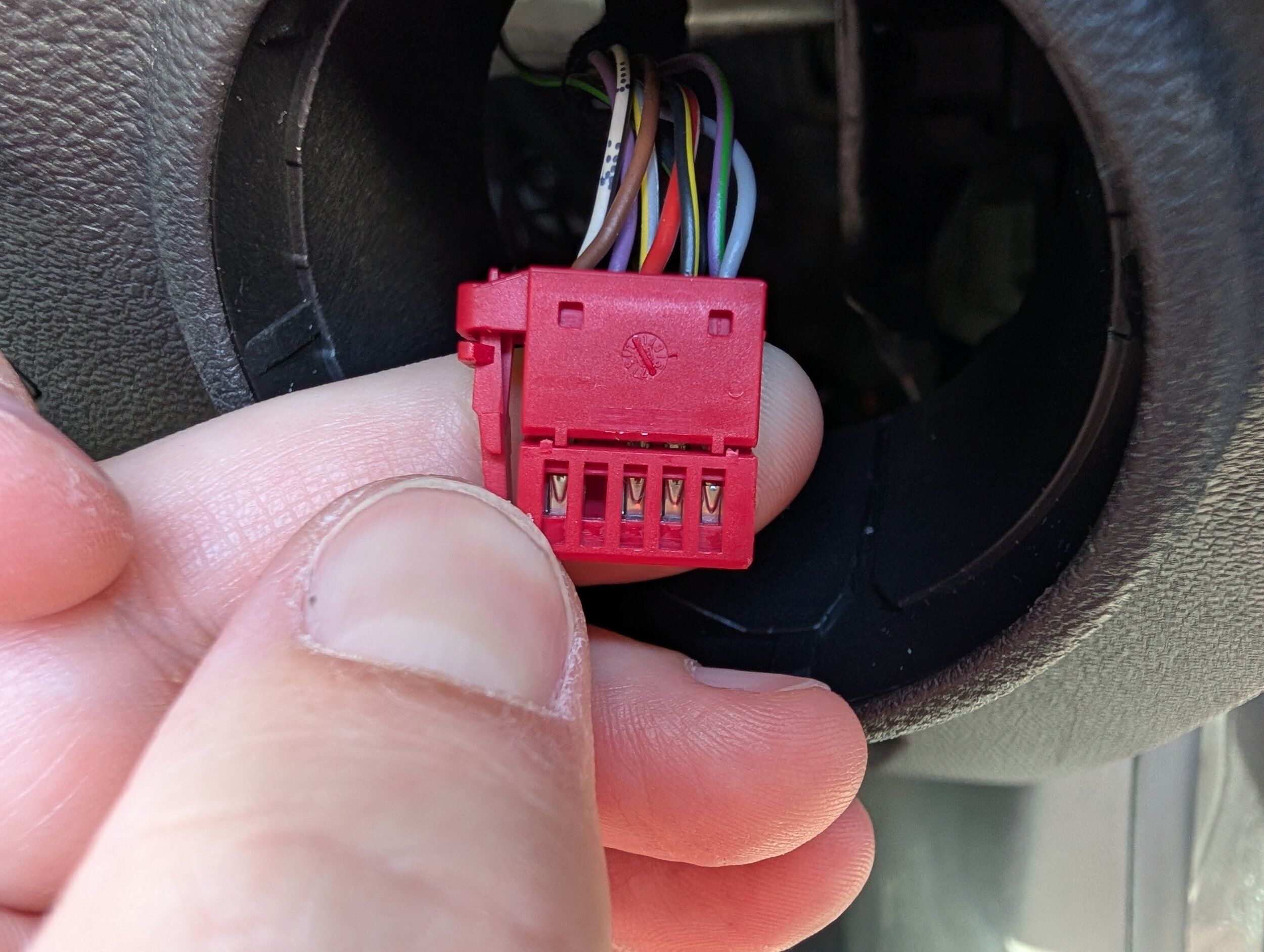

I have the same car as the OP and have recently bought the auto light switch (5G0941431BD) and sensor (5Q0955547C).
Please can someone confirm the correct coding required on obdeleven? I tried some coding from information found on this forum and elsewhere online but I am not sure how I can verify if the car is detecting the new sensor. I did see it mentioned somewhere that my light switch plug might be missing the pin to the BCM for the auto function.
Is that true for the facelift MK3?
Cheers
After checking online again I can see that pin 2 missing and that this is required for the auto function to work. I've bought a repair cable (000979009E) so I can onnect the switch to the BCM.
My Leon is RHD (UK), does anyone know if the BCM is located on the drivers side?
