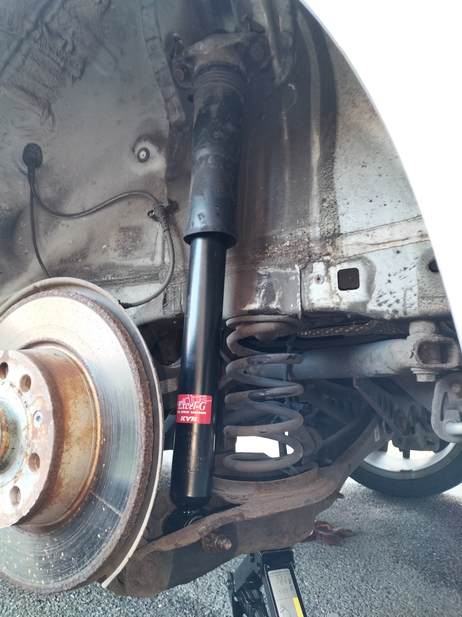

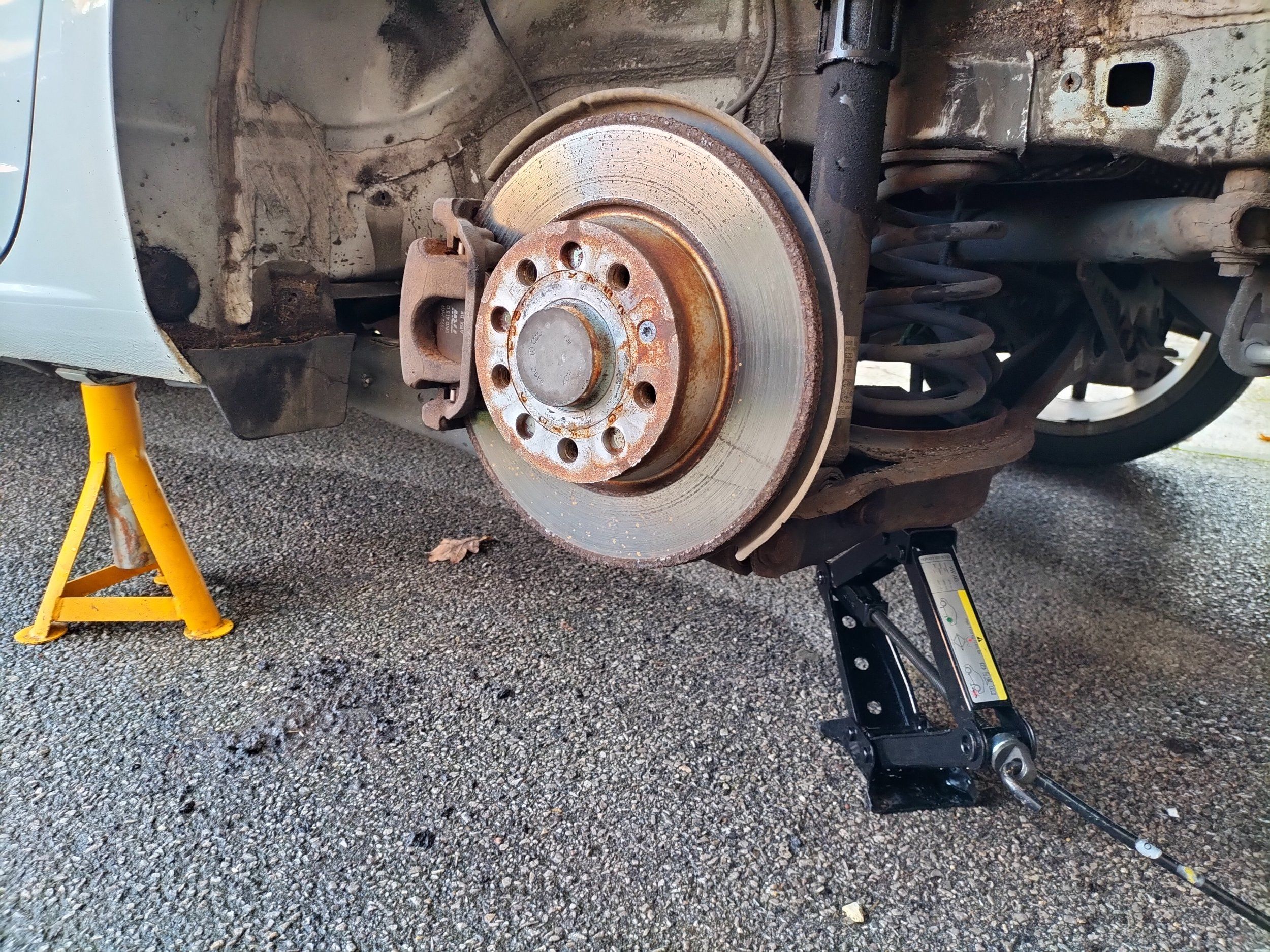

First of all, jacked and then propped up the car.. Great news with these cars (in this case a 2014 2.0Tdi ST FR184) is that the rear shock is not in the springs and easily accessible.

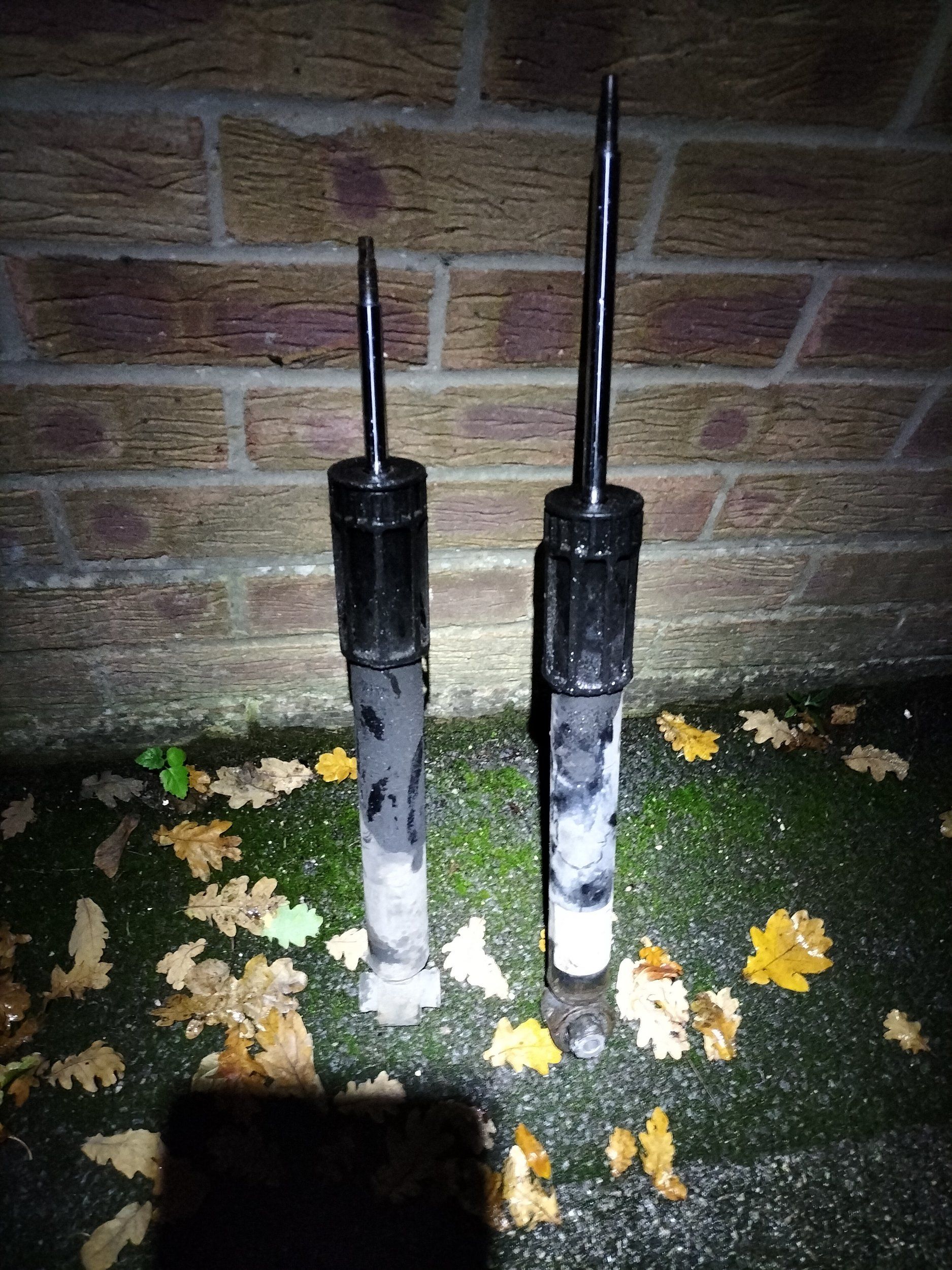

Can see the 'serious' fluid leak on the old shock! Visible leak yes but the shock seemed fine in operation.. but I digress!
Youtube said jack up the spring a bit for some reason - not sure this was 100% necessary but it didn't do any harm.
Edit: should mention I was on a slightly slopey drive so car in gear and a chock of wood put behind one front wheel

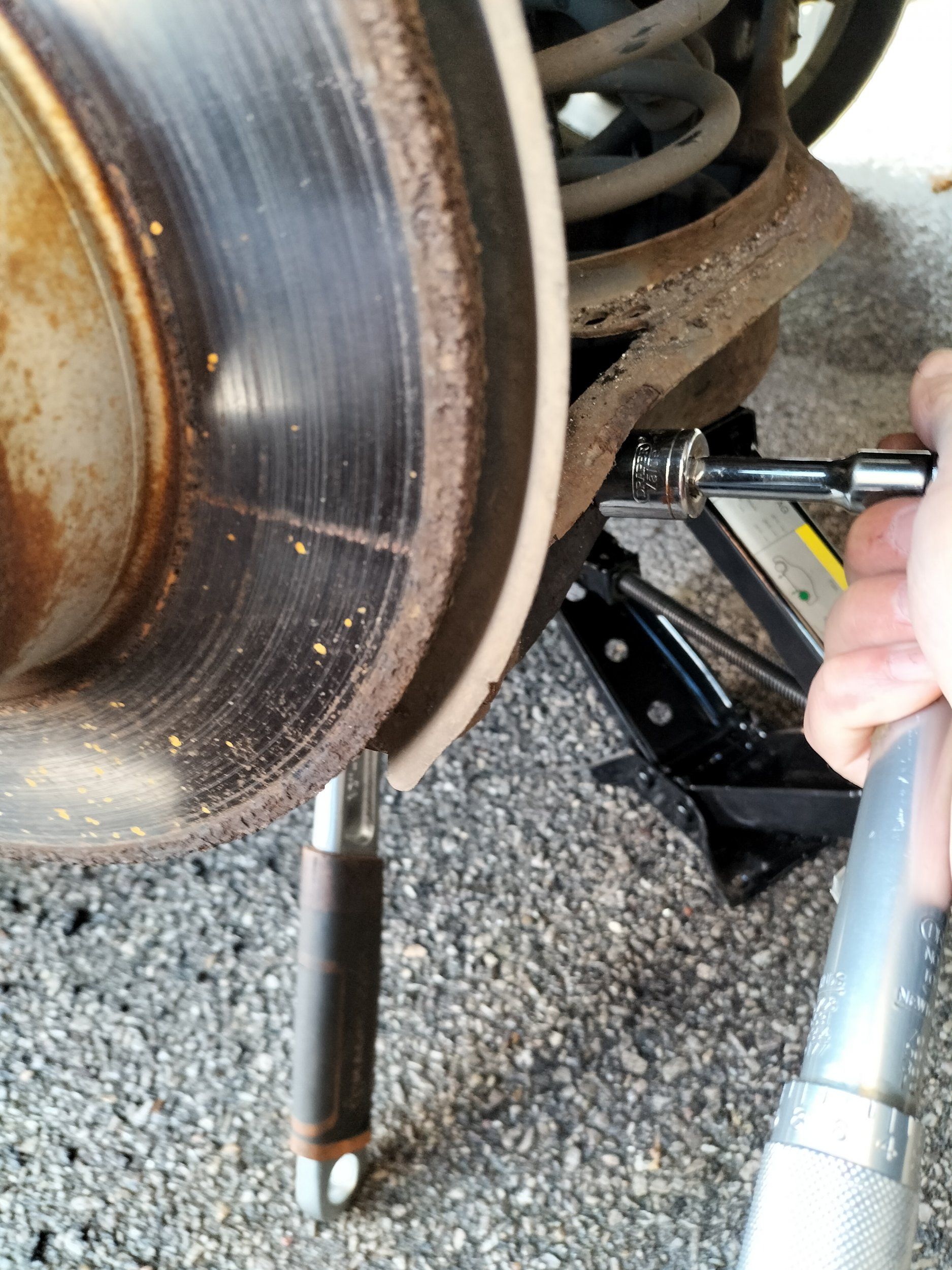

The other easy thing about the shock replacement is that it's just 3 bolts to undo - 2-off 16mm bolts at the top first and 1 off 18mm bolt at the bottom.
Minor issue with the 18mm is that you need either a deep socket or one at least that allows the threaded section to go into the socket more than a small standard socket (I used a £2 socket from B&Q in the end after I'd bought a deep socket set that only had 17mm and 19mm!! The 19mm to be fair did undo the bolt.. but it felt loose so: B&Q trip!)
If you look closely at the picture below when undoing or doing up the 18mm lower bolt you have to stop the other side spinning with a spanner..

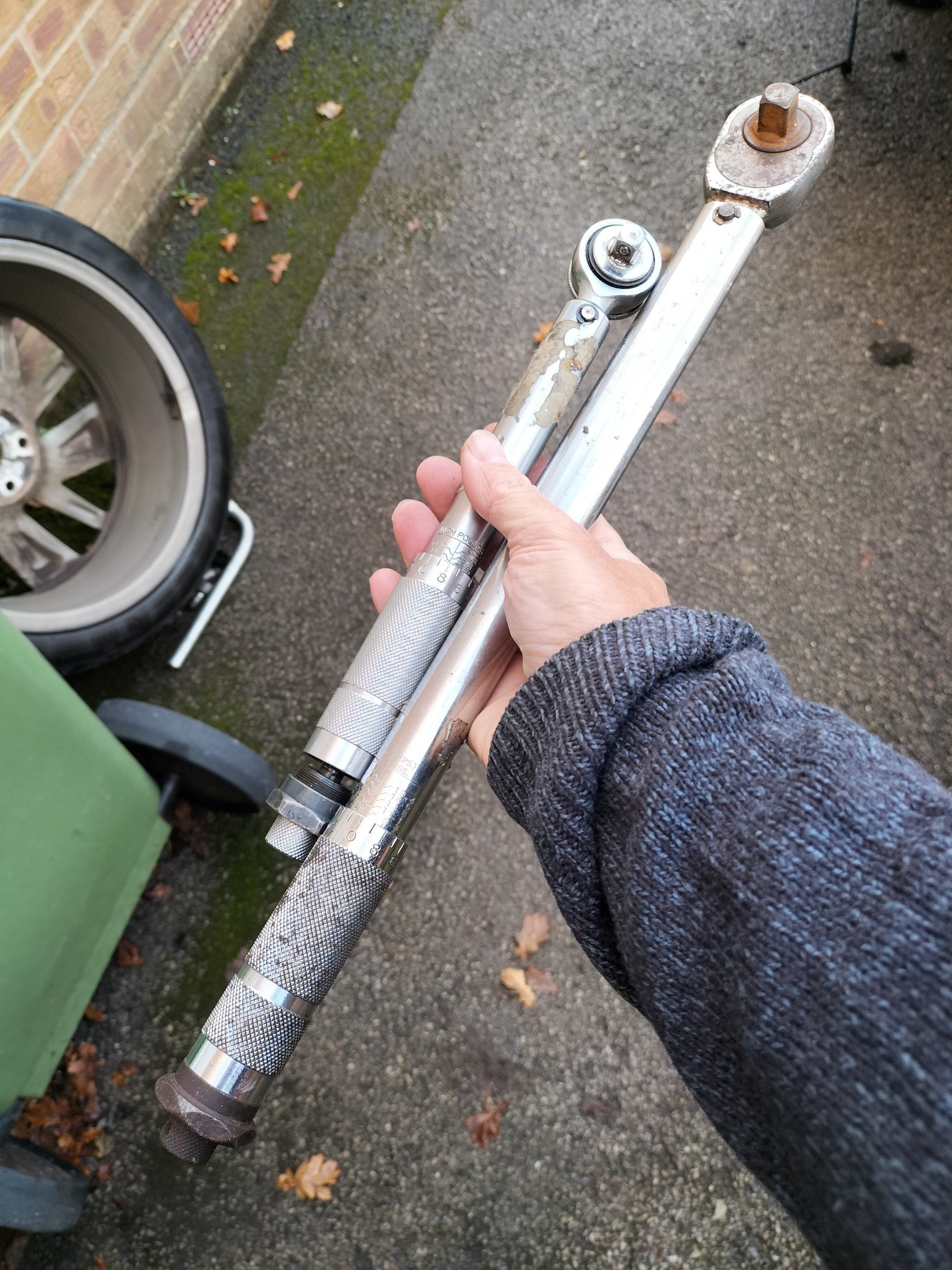

Oh, and I borrowed a friends torque wrench as mine just wasn't man enough!
edit - rear discs looking a bit 'rusty-lippy' - might need attention next year!
edit2 - a critical poster may well reply saying don't use the torque wrenches to undo bolts. And they might be correct. Well however I did, so perhaps they are now a bit less accurate as a result..

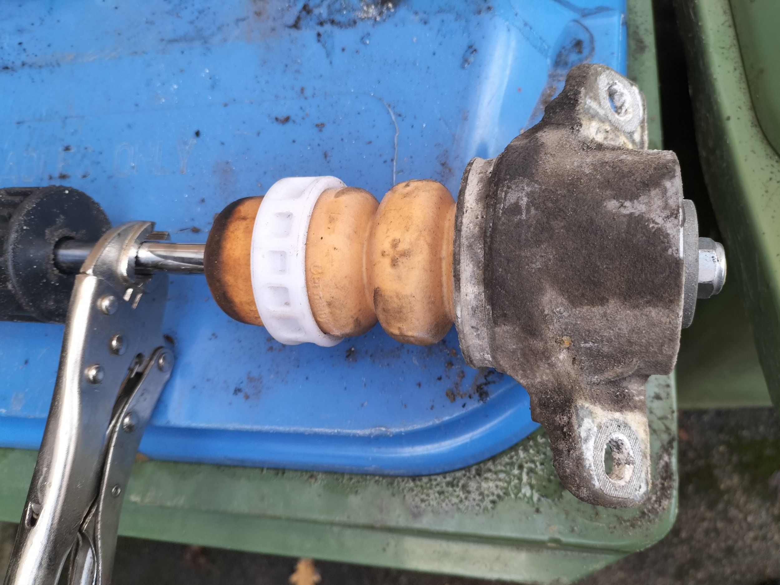

Once the old shock is out, have to undo the top bolt to salvage the black plastic cover and the inner foam buffer thing. Needed molegrips to gently stop the shock spindle spinning as the top bolt is removed (old top bolt was 16mm, bolt with the new shocks was 17mm - again a deep socket may be needed).
When fitting the top bolt to the new shock (after putting the funny foam buffer on it) the instructions say not to use the molegrips.. but I did anyway without any problem. Then need to put the black plastic cover onto the new shock with a new cable tie.
edit: to be clear, the use of molegrips is not the recommended way to do this - see other posts below for the method that gives lower risk of damaging the shock's (albeit strong) piston rod!
For new shocks I went for nothing special but not bargain basement - a pair of KYB Excel-Gs (part # 3448024) for £85 off eBay - typically I found them between £85 and £110 for a pair.
Then reversed the removal above with the lower 18mm bolt tightened to 70NM and the 16mm bolts at the top set to 50NM.

Two functional but slightly weeping rear shocks replaced.

A couple of comments, probably too late for you now, I wouldn't use any lub on bolts that have a self locking nuts, that ends up making a mockery of the torque you tightened these bolts to and probably also the effectiveness of the self locking nuts - though after being used once they should get replaced, so, all these fasteners should have been replaced, it sounds like you only replaced the self locking nut on the end of the damper piston rod, finally, as you can see on your picture at the end, the end of the damper piston rod has a couple of flats - they are there so that you can either fit a special tool to them to hold the piston rod from turning, or just use a small adjustable spanner to stop the piston rod turning.
What is annoying, at least for me, is that VW Group factory fitted and spares rear damper top nut is 16mm AF and the aftermarket replacements are 17mm AF, also the dimensions of the "flat end" of the original damper and the new aftermarket dampers are different! If you just use a small adjustable spanner this is not an issue, but I finally made the effort to buy the correct "socket" to stop the piston turning, using that and a Vortex socket set made that part of the job easy - but back to the small adjustable spanner for fitting the new aftermarket damper!.
Compressing the rear spring(s) is aimed at getting the position of the hub back to its natural position before tightening the bottom bolt as there is a bonded rubber mounting at the lower end of that damper, and that can not rotate so just gets flexed when the suspension moves up and down, so the plan with these bonded mountings is to ALWAYS have the suspension at its "unladen" or natural position BEFORE tightening fixing bolts, as that will mean these bonded mounts last instead of failing early due to being permanently distorted.

Quick suggestion - if you MUST use mole grips on the shaft - slide the bump stop down first and then grab the shaft near the top mount where it never slides in to the shock body.
Reactions: MartinThorn
Yes, that's what I did on the new shocks. Old ones didn't care!

Grease/lube on bolt threads is not generally recommended ( Unless the manufacturer calls for it )
The reason is not because they could come loose - the reason is because a lubricated thread will allow a higher clamping load for the same torque.
This could snap the bolt.
Around half of the torque you apply is taken up with thread and nut face friction.
The engineers take this friction in to account when specifying the torque to use.
This is one of the reasons that many fasteners now have a low seating torque applied - then get finished off by angle fastening.
