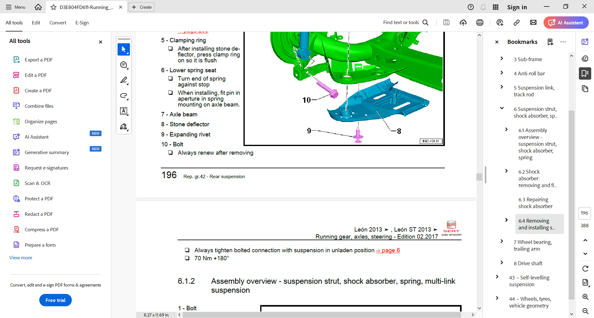

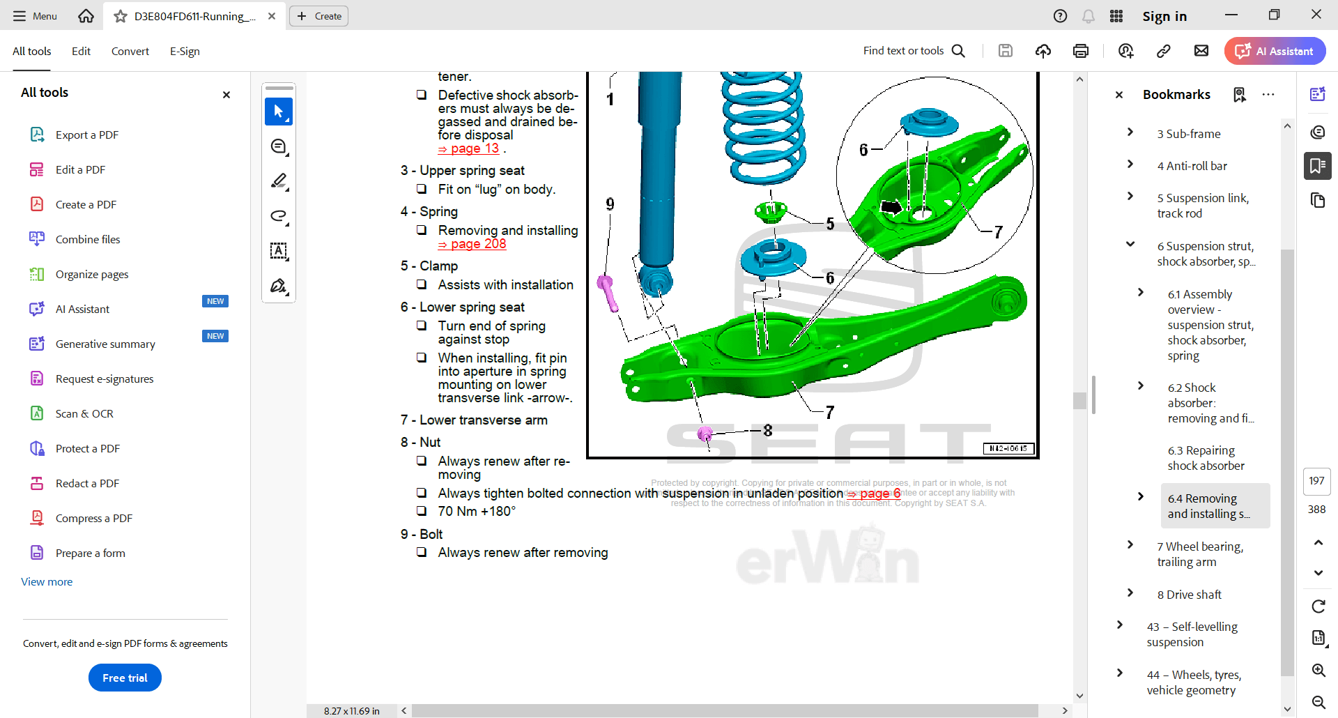

Looking at Autodoc instructions it says tightened the bottom bolt to 70 Nm plus 180 degrees. Is that correct as getting an extra 180 degree must be massive torque?
Looks like the design in their guide is slightly different as it is not a captive nut, which looks to be difference from Torsion to Multi Link rear axle.
Step 43
Replacing Shock Absorber on Seat León Mk3 2022 2.0 TDI by yourself
Tighten the lower fastener of the shock absorber. Use a combination spanner #18. Use a drive socket #18. Use a torque wrench. Tighten it to 70 Nm torque.+180°
DEAN0
Old Git
Feb 1, 2006
5,439
425
Preston - UK
Step 43
The book confirms 70nm +180deg
