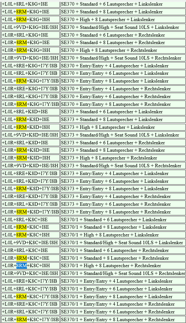

Once you have the correct dataset his EQ will have 3 bands not multiple frequencies, and all of his speakers will work without changing the wiring
He has 8RL though, if that makes any difference here. What I meant from the start was if you were to move around the MIB2 std between the gen2 mib2 cars with 8RM and 8RL you would not have this problem. Therefore in conclusion, technically the wiring is the only difference presenting the issue that can be resolved through both dataset and rewiring
8RL is 4 channels.. so upload a 4 channel dataset & leave the wiring = problem solved
From memory 8RL is also missing a speaker from each rear door, are you installing those if you’re converting to 8RM?
No, not upgrading to 8RM, what do you mean by 4 channel dataset? If you mean 8RL dataset, 8RL on mib2std still so in effect it will still try to output through unoccupied pins?
