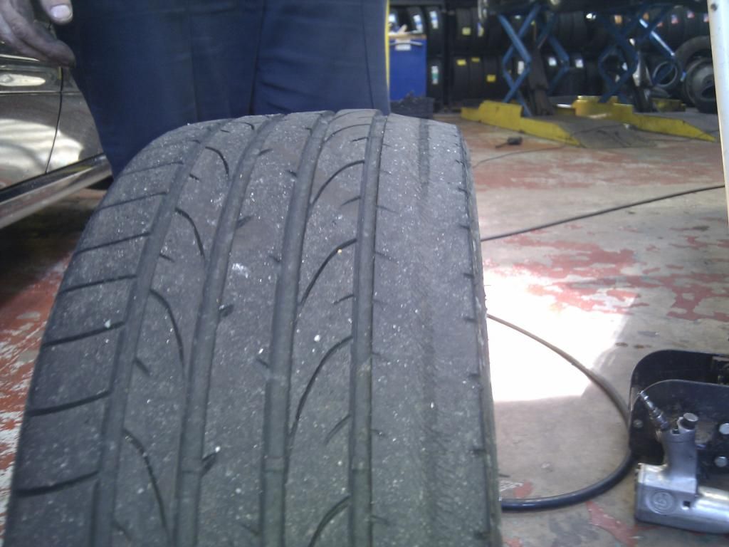

My 08 FR suffered quite bad on the rear, still got this picture from when I had a good look at the tyres and notice how bad it was worn on the inside, only done about 22k miles. Look at all the wasted tread :(
TBH after 22k mile thats not too bad.If a manufacturer is running negative camber that part of the tyre is going to scrub more.
Theres a thread somewhere where i have put the wheel alignment specs up for Cupra and Cupra R(yes cupra boys they are different lol).
I have to say of the 16 year i have been aligning cars ive had brand new cars that were out according to the spec on the machine(taken from manufacturers).
I will soon be doing mine as got 4 new tyres and dont want any scrubbing
