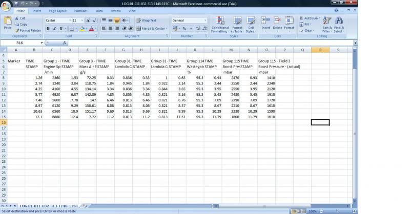

here is a log report for anybody technically minded enough
2nd gear pull
TIME Group 1 - Field 0 TIME Group 3 - Field 1 TIME Group 31 - Field 0 TIME Group 31 - Field 1 TIME Group 114 - Field 3 TIME Group 115 - Field 2 TIME Group 115 - Field 3
STAMP Engine Speed - (G28) STAMP Mass Air Flow - (G70) STAMP Lambda Control - Bank 1 (actual) STAMP Lambda Control - Bank 1 (specified) STAMP Wastegate (N75) - Duty Cycle STAMP Boost Pressure - (specified) STAMP Boost Pressure - (actual)
/min g/s % mbar mbar
1.26 2360 1.53 72.25 0.33 0.836 0.33 1 0.63 95.3 0.93 2470 0.93 1410
2.74 3240 3.04 118.75 1.84 0.945 1.84 0.922 2.14 95.3 2.44 2550 2.44 2240
4.25 4160 4.55 134.14 3.34 0.836 3.34 0.844 3.65 95.3 3.95 2550 3.95 2120
5.77 4920 6.07 142.89 4.85 0.805 4.85 0.821 5.16 95.3 5.45 2480 5.45 1910
7.46 5600 7.78 147 6.46 0.813 6.46 0.821 6.76 95.3 7.09 2290 7.09 1720
8.97 6120 9.29 150.61 8.08 0.813 8.08 0.821 8.37 95.3 8.67 2210 8.67 1610
10.63 6560 10.9 151.17 9.69 0.813 9.69 0.821 9.99 95.3 10.29 2230 10.29 1590
12.1 6880 12.4 7.72 11.2 0.813 11.2 0.813 11.51 95.3 11.79 1800 11.79 1610
would this indicate a boost leak as the mb actual is much lower than the mb requested?
better format
