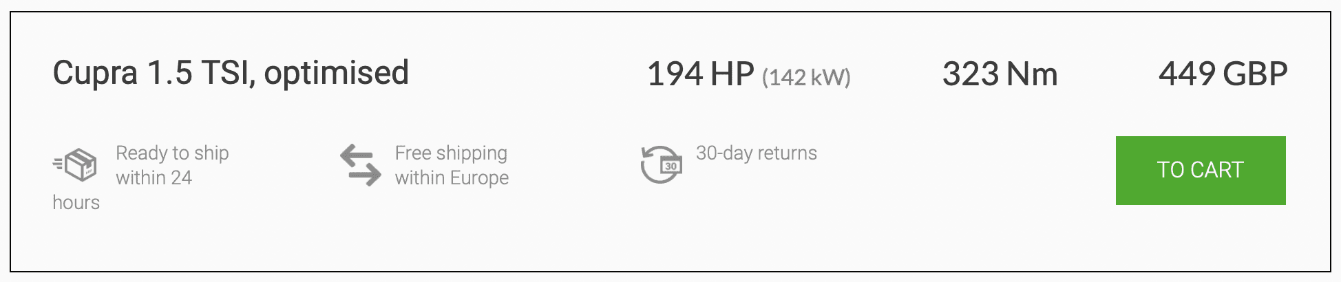

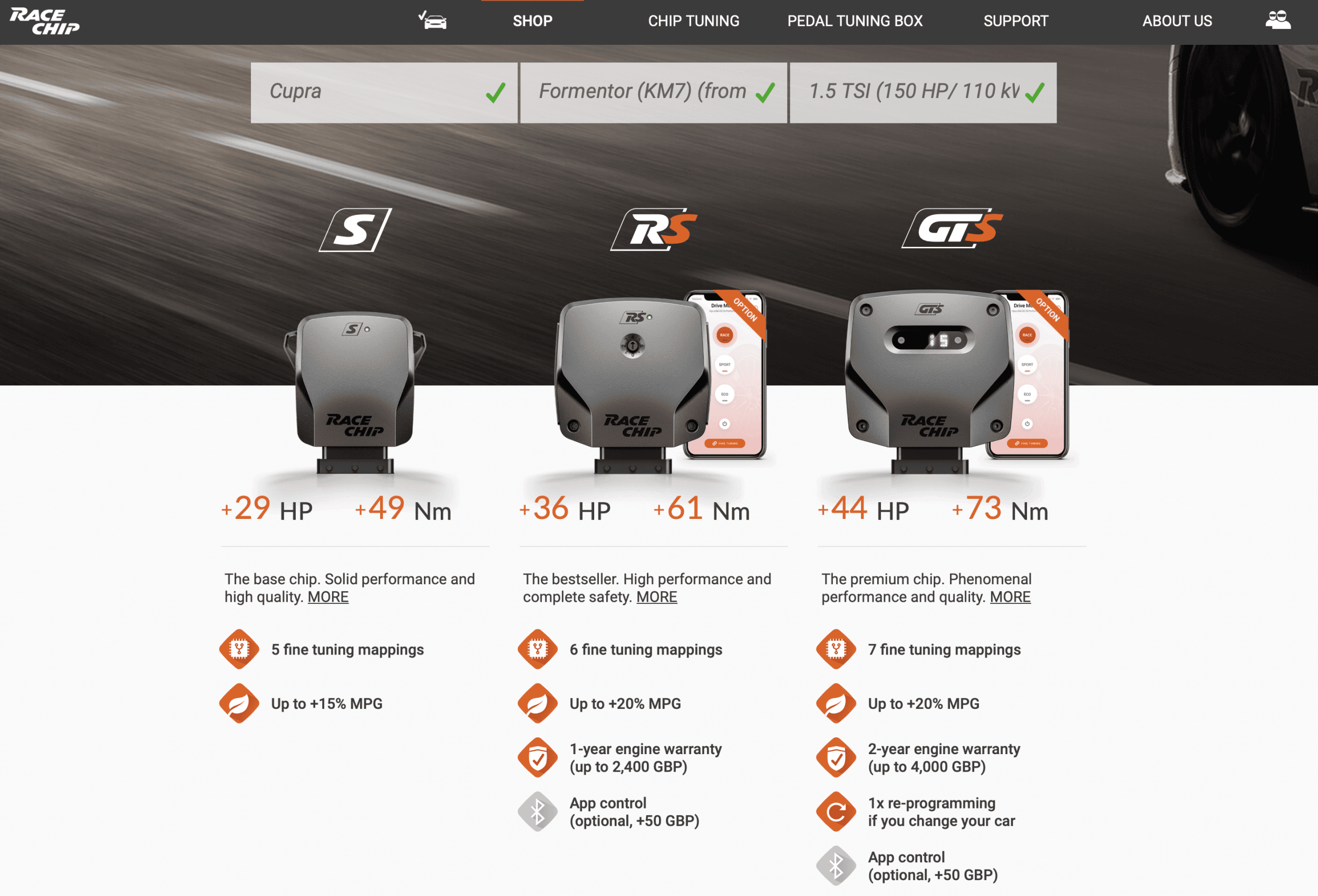

Hi all,
Only joined this forum today; very informative already!! Quick question though... (only ordered last week; delivery ain't til April 2022 but need to ask)
I've had a remap done in the past on an old 2011 Skoda Fabia 1.2 TSi - and afterwards, that car flipping' flew!! So coming back to another TSi engine in April, was wondering what options are out there...
Read somewhere online that the chip boxes are better than remaps because can be reversed etc. This one was looking very interesting...
Can't grumble at an extra 44bhp and 73Nm torque!! And they're doing £100 off if purchased before 5th October...
What's your thoughts on this though please? Has anyone here chipped or remapped a Formentor 1.5 Tsi who can comment on 'after effects'? Or even anyone who can comment on RaceChips as a brand or had one of those installed?
The only thing I wouldn't really relish - is taking the thing out every time the car went back for service, so as not to invalidate the warranty!! Looks like hassle - and I'm not a mechanic, so it would be hassle fitting that wiring harness. But for £349 right now, well tempted to get one and put it down until April!
Appreciate your comments - good or bad? Thanks!!
