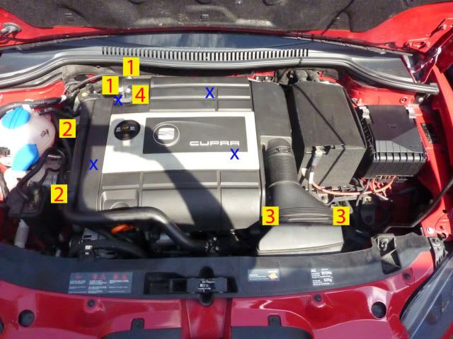

Hi Mate, I have done a complete step by step guide to removing the engine cover, in word format and sent to another user on here. If you PM me you email address I can send it over to you as don't think I can insert here
Dec 2, 2008
571
Nottingham
Here is a picture from the guide, the blue 'x' mark roughly where the engine mounts are.
Be careful not to split the cover!
The numbers mark where there are screws / connection that need removing.
It basically a firm upwards movement towards the back!
