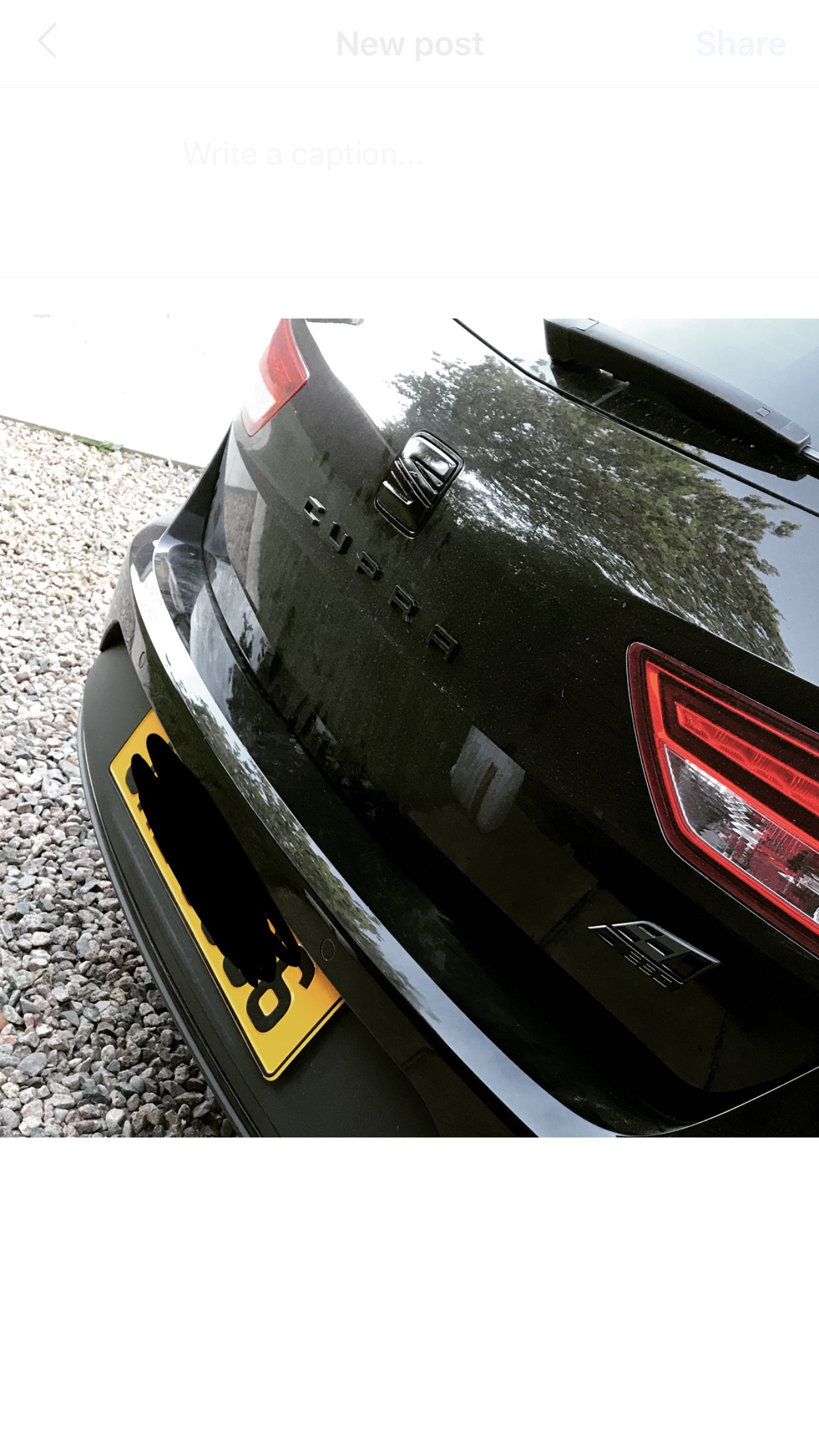

Excuse the dirty car! Very pleased with the result...
Reactions: Damo H and A9BNL

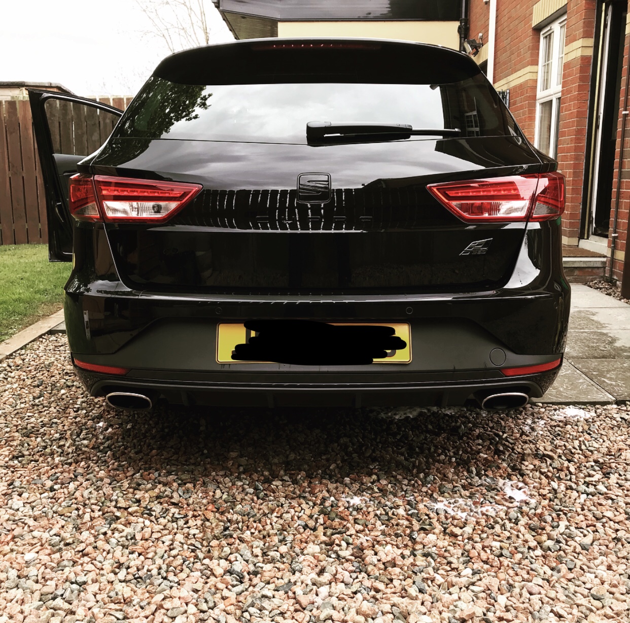

Do you have picture from further back. I considered doing this myself...
Yes I did - I sprayed it black and use thin layers of lacquer to make it more matte black. It fits in really well I think!
@Damo - It’s getting washed tomorrow so I’ll get a photo more photos up!

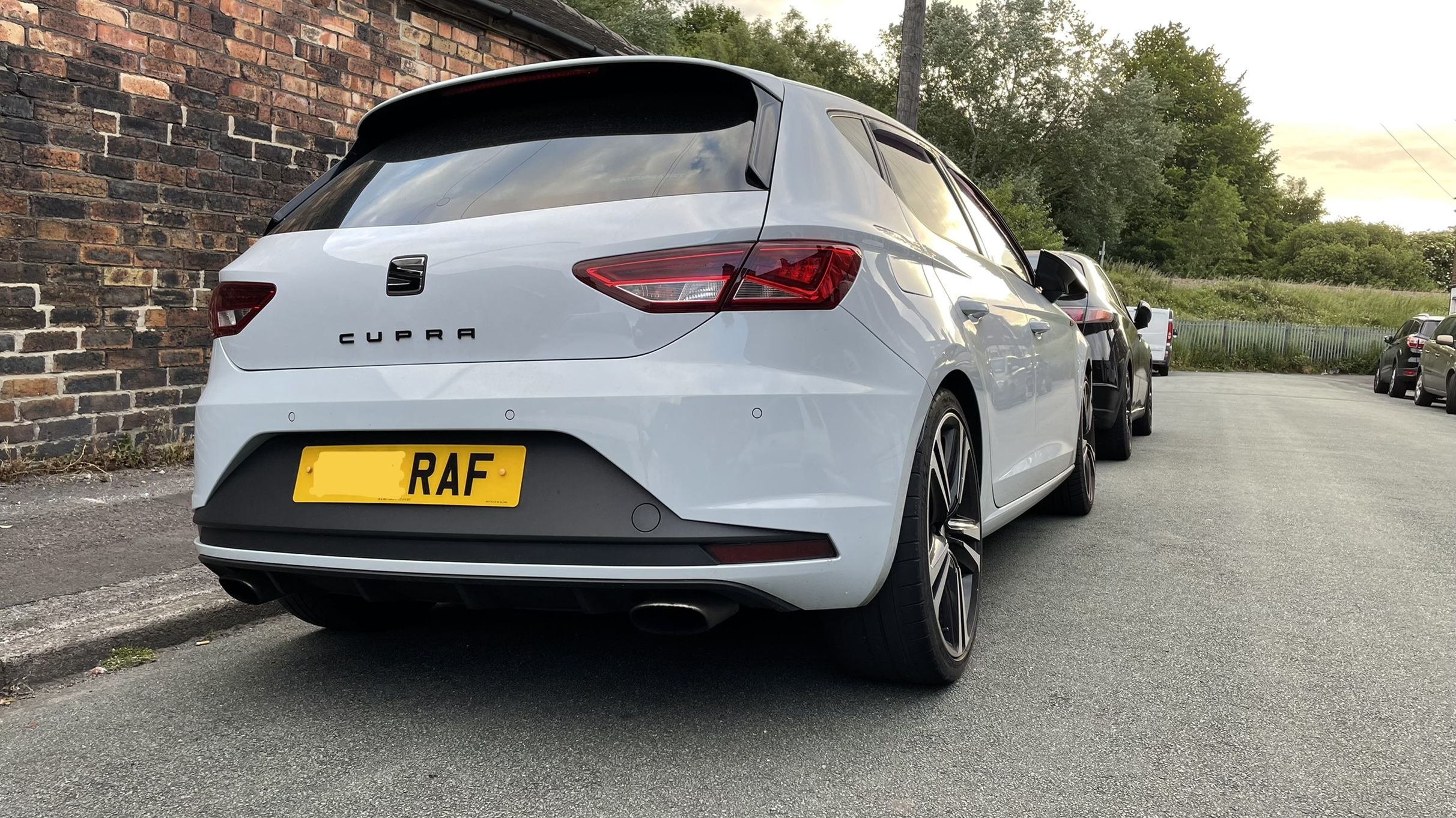

Removed my rear flag and 280 emblem. Decided keep it like that. Clean look, like a modern Cupra. Can I do the same with the front flag? Remove it and keep it off, or will it look like there’s something missing that’s supposed to fit there?
View attachment 32336Removed my rear flag and 280 emblem. Decided keep it like that. Clean look, like a modern Cupra. Can I do the same with the front flag? Remove it and keep it off, or will it look like there’s something missing that’s supposed to fit there?
You'd have to get a new grill as the Cupra grill has a blank plate there where the flag sits so it would just look lile the flag is missing
Well, that’s unfortunate. I hear the grill is a pain to remove too.
