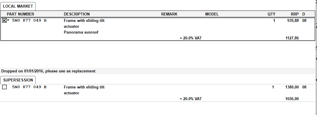

Retail for my pano sunroof frame (no glass, motor etc, just the frame) on my ST is £1,656 inc vat. You could look to shave some off that if you know someone with a trade account at TPS but apart from that it's going to hurt the bank lol
They superseded the part in 2016 so in theory we should both have the newer part fitted... Not that it makes a difference as mine creaks too lol

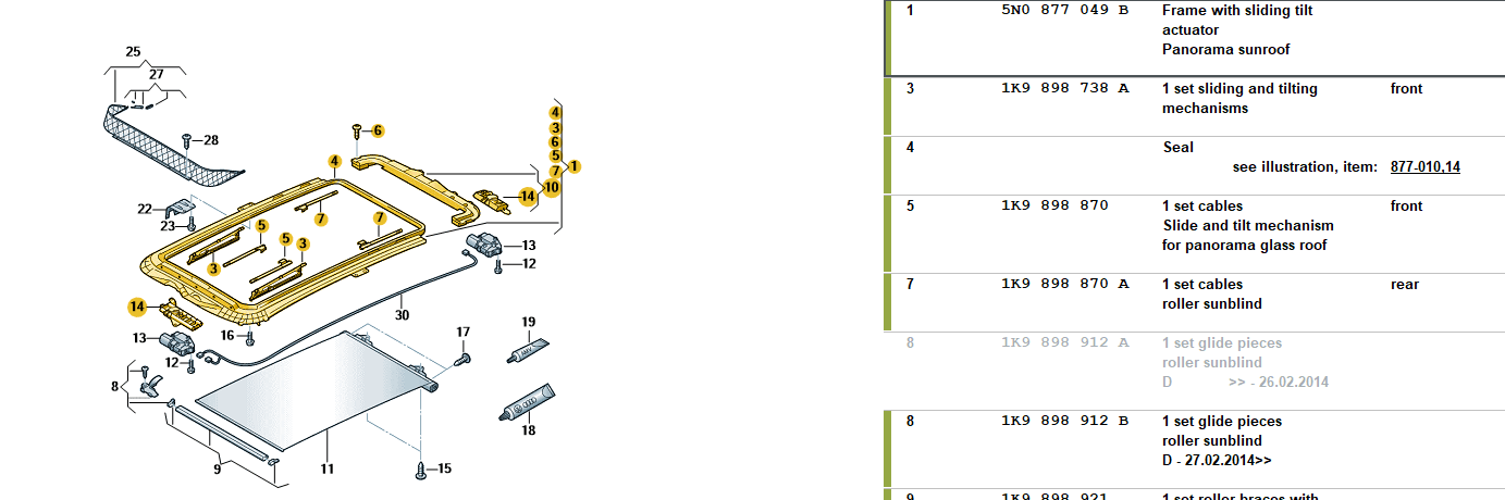

Yeah mine is mild, I've done some maintenance on it which helped but I want to do a full strip down and check over on it in the near future, make sure everything is tight and greased. The frame has 18 bolts holding it in so want to check they are all secured and at the correct torque too.
Anything short of replacing the frame really lol
Stranger things have happened but it's a mission to get to the bolts, basically the same amount of work to strip it all down to get to the frame to remove it lol.
