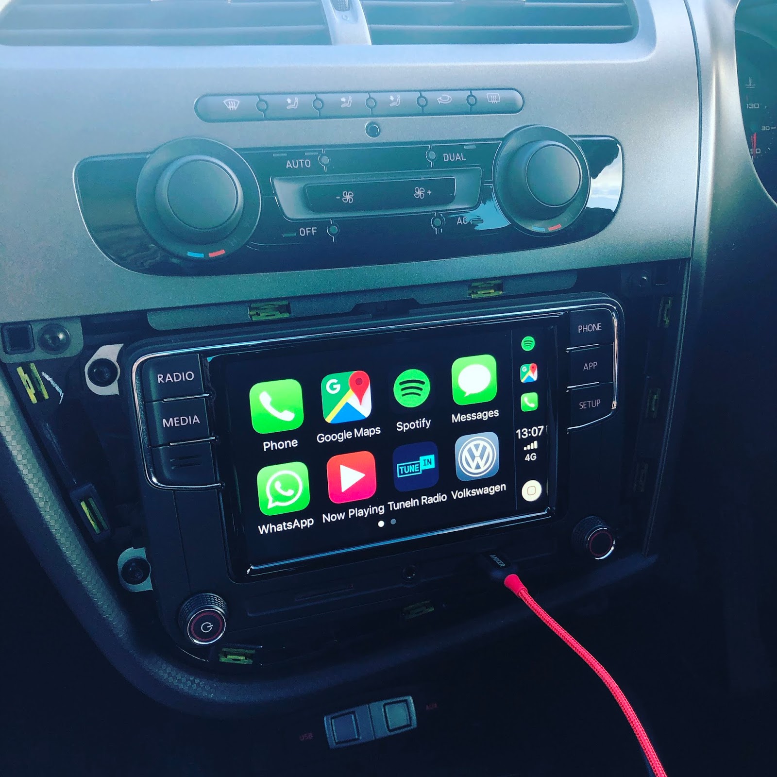

So I actually decided not to install this - I connected it to the car and had a play around but found the radio quality was really poor (I did have the blue cable connected), Spotify didn't work great on CarPlay and the radio took some time to come on.
Instead I picked up an "RCD330 Plus" which was a lot cheaper and has worked flawlessly. It comes on instantly, the buttons match the rest of the interior illumination, radio sounds great and CarPlay works perfect. My only challenge getting it to fit was a part of the casing covering the SD Card Reader. For anyone interested in installing one - full details are on my blog. https://www.chrisbryson.me.uk/fitting-vw-rcd330plus-to-seat-leon-mk2/

I too purchased this headunit and it's far superior to my old RNS510 due to the CarPlay. I installed it in to a pre FL Leon and had to purchase a "simulator" so as to allow the older 8 button steering wheel controls to operate. For anyone interested, I purchased the following from aliexpress and it works like a dream. Cheers.
