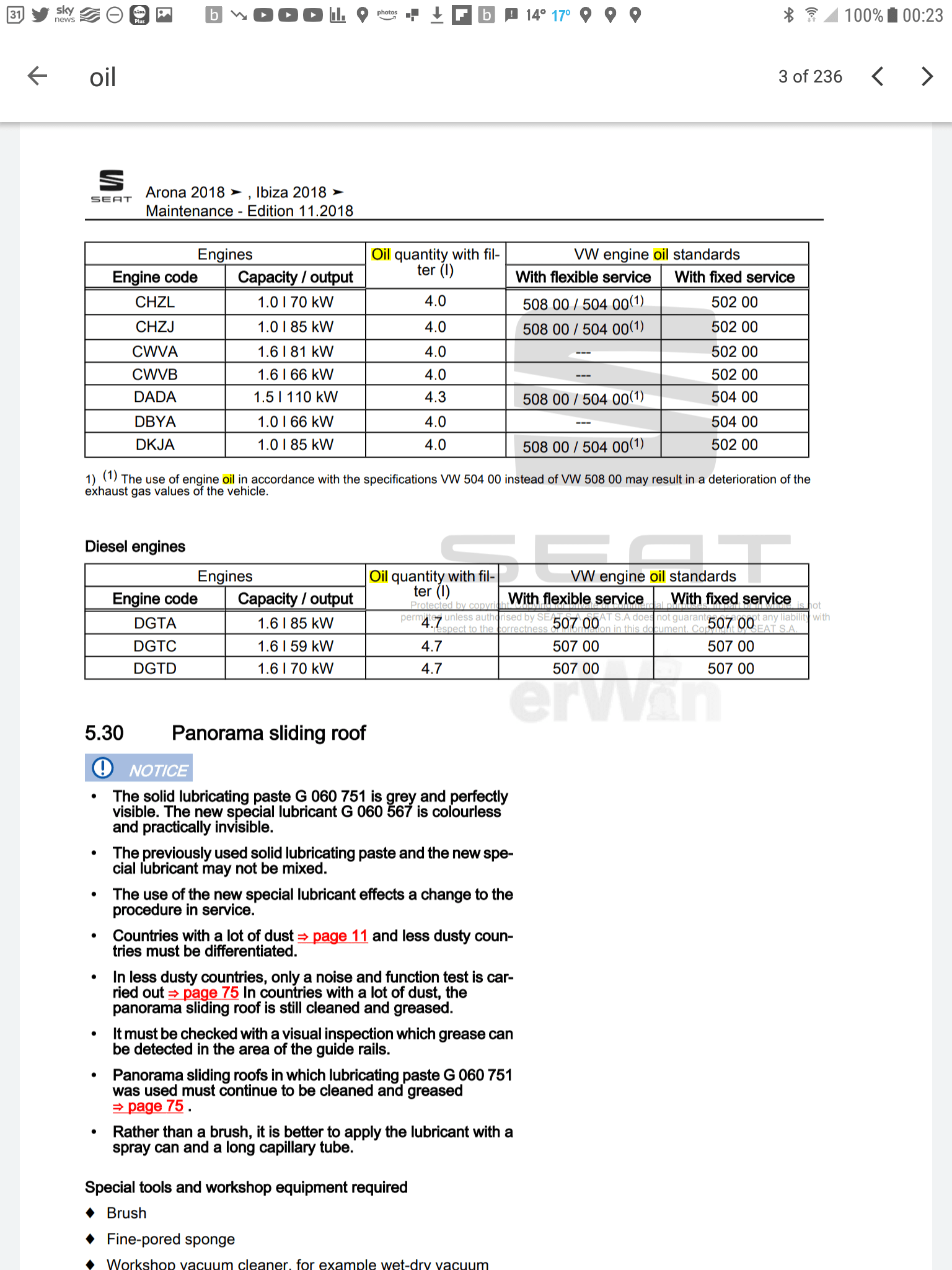

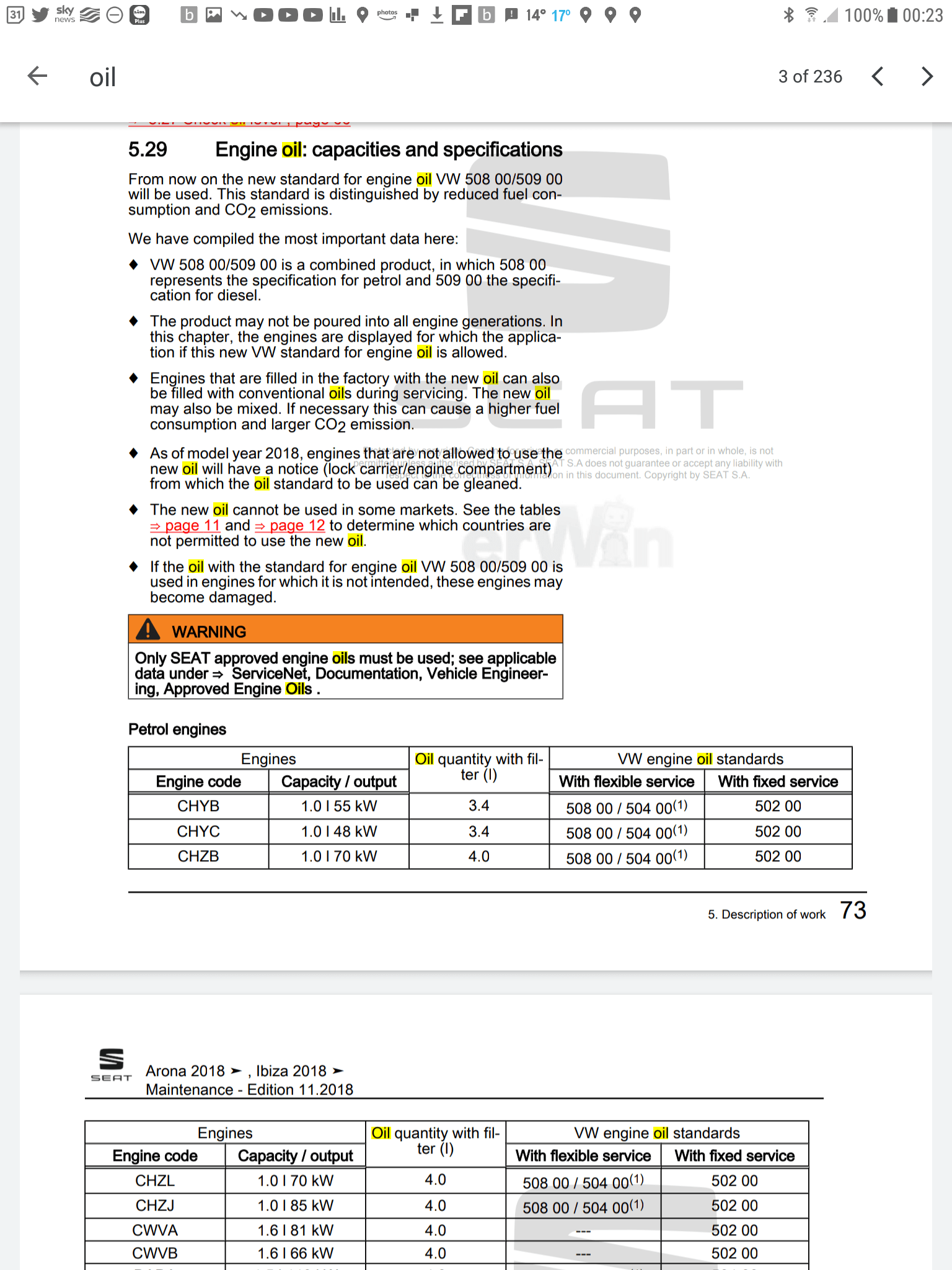

Thank you so much mate - I am looking through the manual and can see the VW standards but it doesn't show if it's 0W-20 or 5W-40 etcAh no this Arona 1.0 TSI hasn't required any topping up. I went thru the spec the other day with someone.
Two pages from the Erwin maintenance manual. Find your engine then whether it's in a fixed service plan (yearly or so) or long plan. That gives you the VW spec code, then buy the oil to that spec. VW xxx yy.
I've always put in the long service spec oil as top up (the better quality stuff) in my Seats. Some dealers only carry that oil so better match up. Well that's the thinking.
