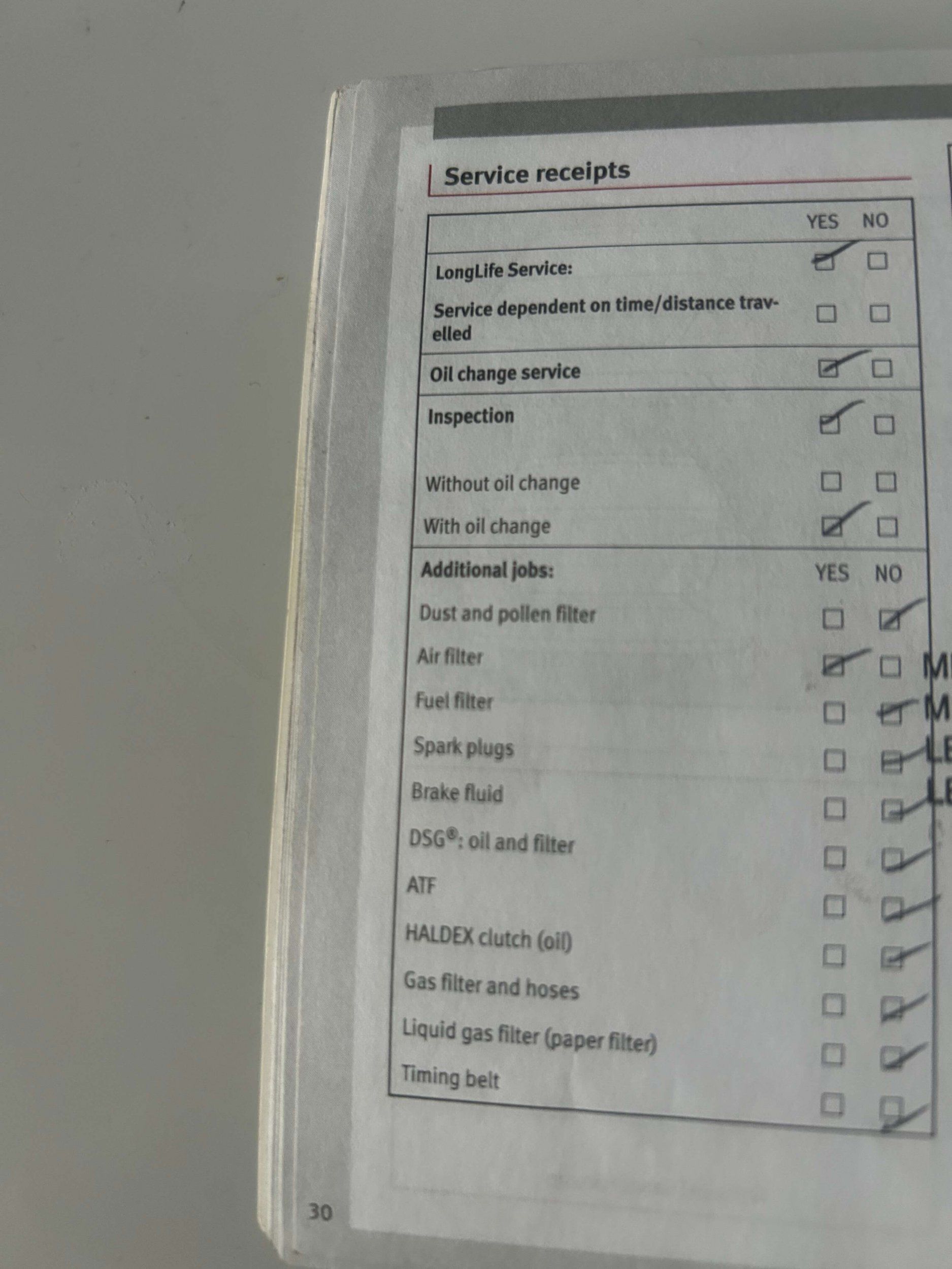

I've checked the service book and its got longlife sevice ticked
I usually have a car service and mot together once a year, but as I've been driving more miles than normal I wasn't sure what to do, leave it like I did last year or not.
I'm wondering now whether its worth having a car service instead of just an oil change. (I'm useless with cars and can't do this sort of thing myself)
