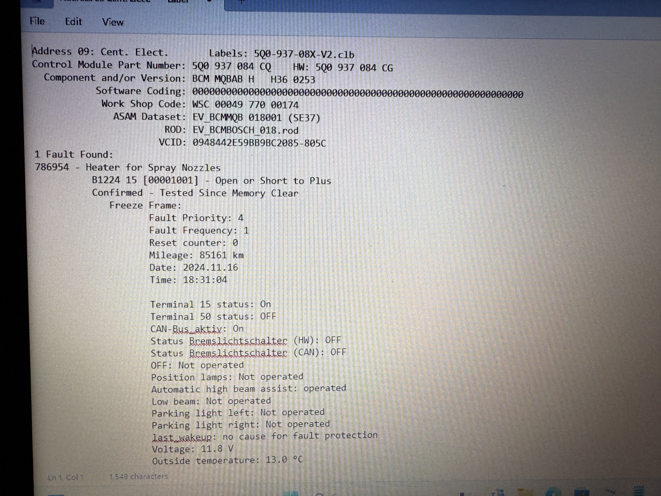

Hi all, finished the install today, went through the activation in vcds and the following fault was thrown up after rescan.
Can this be tested using a multimeter on the sockets that plug into the jets to confirm the wiring is functioning correctly to confirm the issue is the jets themselves and not the wiring? If so what setting wound I use on the multimeter. Thanks
