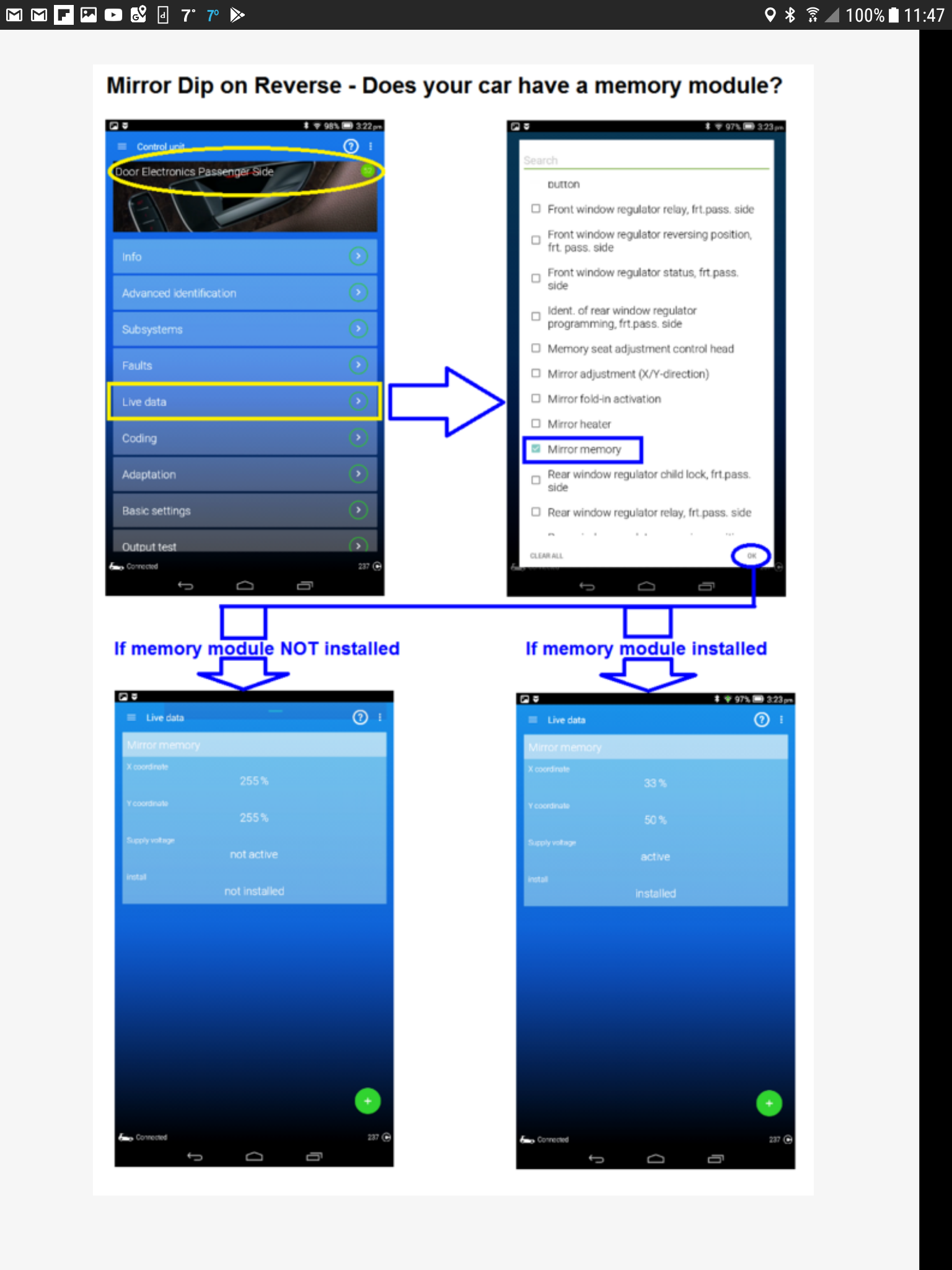

I'll have a look to see what mine says on "does your car have a memory module" in the passenger mirror unit as per the thread above. This could be the issue on whether it half heartedly works or not at all.
Reckon that's the missing bit on these units. Be interesting whether mines suppose to do it with complete accuracy or whether it's a fudge. Guess those units with it not installed in the parts just show as his link.

The only thing I would say about the drop down mirror is you will need to periodically readjust it since the motor in it and sensors are not fully spec ed for it and the Ateca housing view. There has been some conversation on the German Ateca board about it. Crank head and do the drop down. Better than nothing was the summary. It's a good training procedure for Obdeleven and VCDS system in the car.
That is the mirror memory module in the mirror if you haven't got it, it drift.... see Don's post on the link above. What I called the Don test above.
You got AndrewJB post above so may be they just don't allow it now. To that they would I guess stop the gear levee sending that it's in reverse, you still need the tilt ability to adjust the mirrors. You will have to try after enabling it. As said, I did and it worked on my 2017 Ateca Xcellence, others did the same and had it working albeit with the need to readjust the mirror from time to time. I have also been pestered about it on the "grumpy" Ateca board as opposed to the friendly one here (it's the motor spec covered on the Ozzie VW board). I think if you get it working it may give you a more restricted view related to the Ateca's mirror than you are use to which is why they didn't enable it or put the appropriate mirror motor in it.
There was a big discussion on the Golf7 Ozzie board about motors which is the Don test (supremo of VCDS) I replicated above (have to search for that but there is much more detail on mirror motors there... one the Ozzie VW owners get effected with wrong motors installed on RHD cars to Oz). Thus we know that early Ateca's were not fitted with the precision motor / sensor for the mirror to return to the same place each time of use. Early Atecas are not really spec ed for it. You can cast your eye at that.

So we just got the unknown of whether Seat changed anything to stop you doing the mod given they aren't planning for it's use. Not having the motor with the memory control module means it drifts after repeated use.
The "Don" test below via the Obdeleven on the presence of the mirror memory module below. Mine ends on the bottom left, the figure I showed above in post 9.
