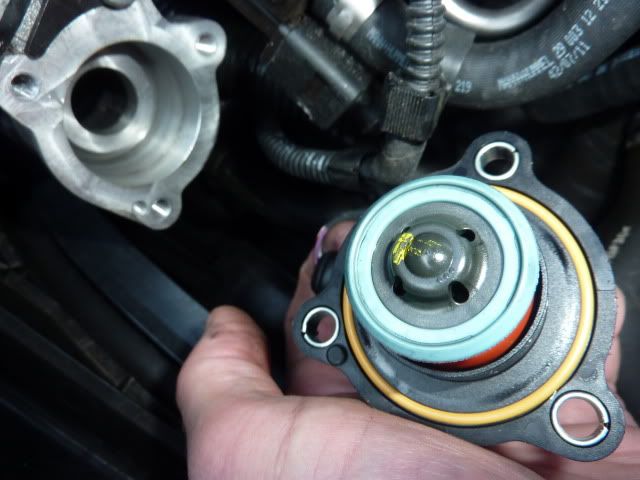

Had a quick search of previous posts on this topic.
I have seen many people complaining that the original DV can split.
Out of curiousity just taken mine apart to look at it. It looks like the earlier version and the piston still seems to have some spring left in it.
For those that have fitted the revision D DV (other than when the earlier version has broken) have you noticed any difference or just done this 'cause the plan is to add more power later and considered it a worthwhile upgrade as not too expensive and easy to fit?
Views please
FYI - My current DV which I assume is the earlier version;

There is no difference in performance with this. What happens in the rev c (and G) ie the style you have is that the rubber part tears. With no rubber on rev D, there is nothing to tear.
Being fair, on a Cupra with it being away from the heat of the turbo, the chances are Rev C/G will be good. That being said, Rev D is the best/cheapest way ahead. Unless you like expensive/pointless bling in your engine bay, ignore expensive valve upgrades that do nothing more than the OEM Rev D valve does.
Views please
funnily enough i took mine out yesterday and inspected it , no tears but i still think its crap , i got ahnilated by an audi a5 cabriolet today brand new 60 plate just said fsi on the back but it was the v6 version was too quiet for the turbo version , but on paper should have been the other way round , just need to track down whats wrong and where.
