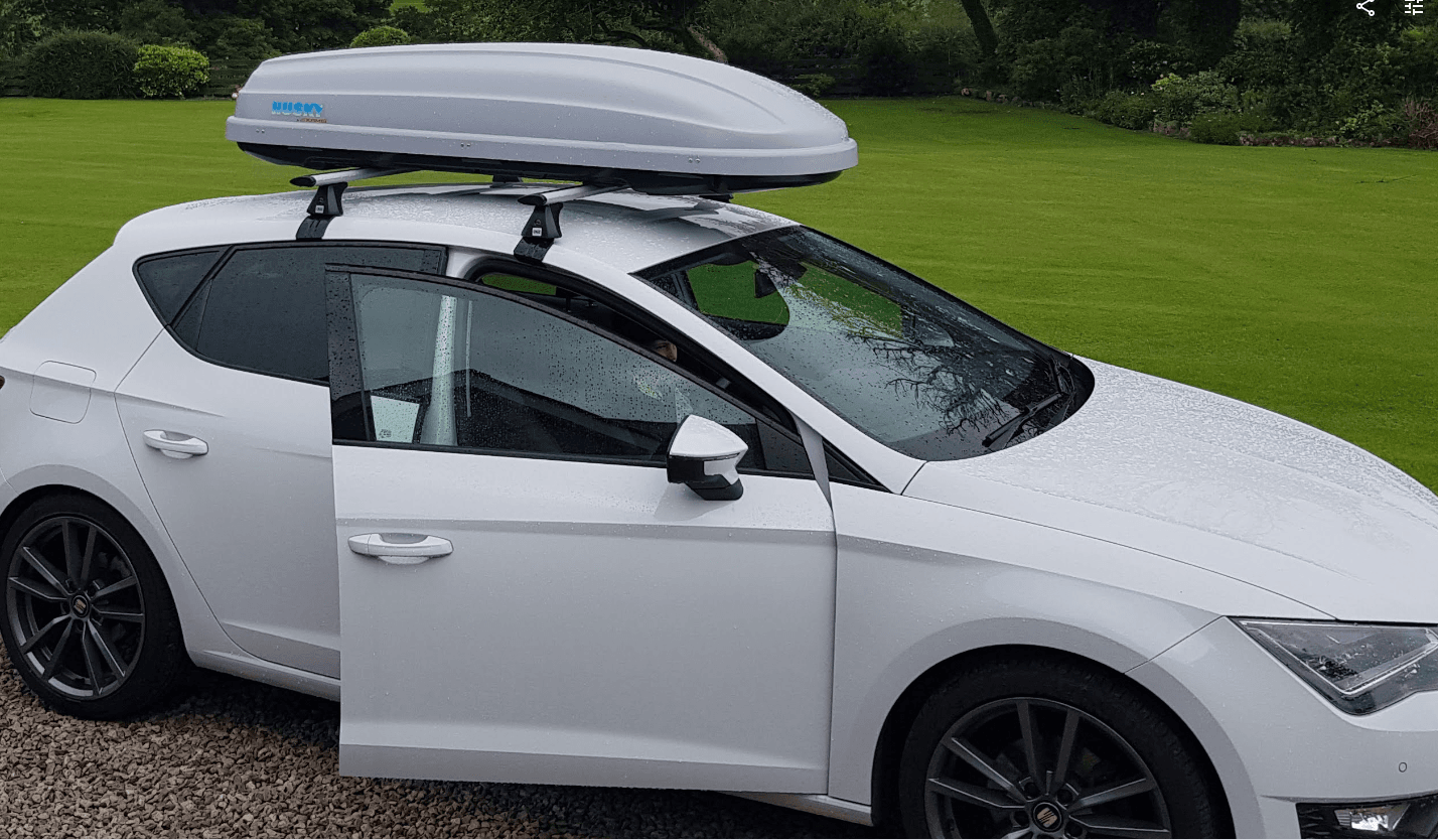

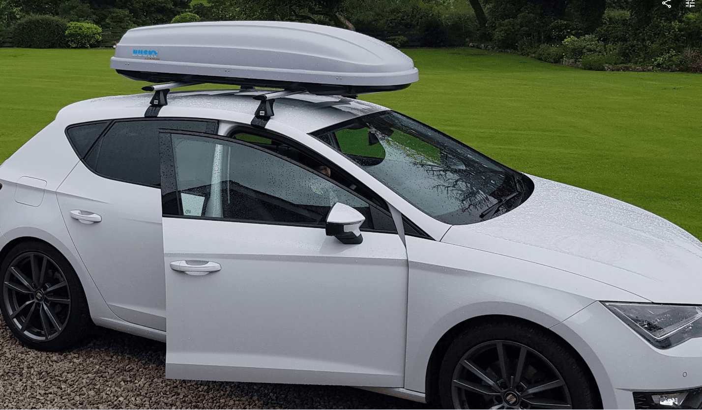

Poor photo, but only one I have with it fitted to the Leon Hatch.
