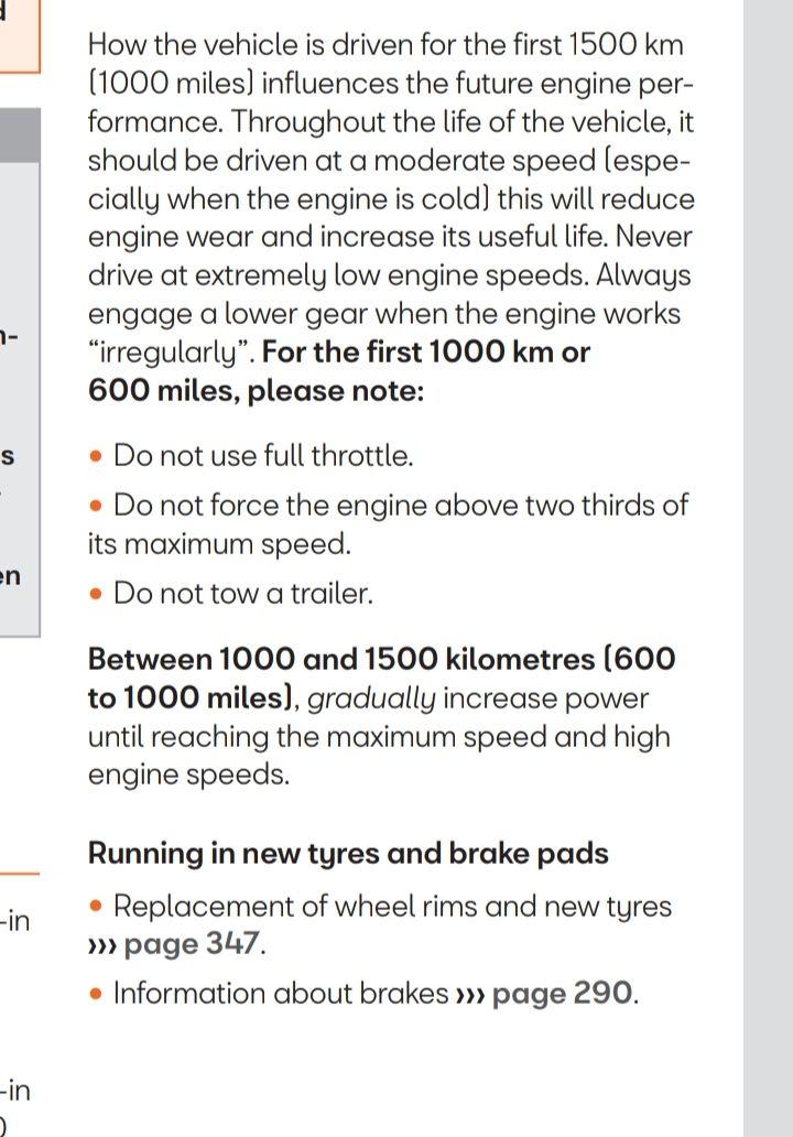

The manual states it should be run in in 2 stages over the first 1000 miles.
To air on the safe side, and go with what the manufacturer recommended, I ran mine in as per the manual and have had no oil consumption in the first year of ownership. You'll find others who have to top their oil up regularly. People leasing their car tend to have a different opinion as they get shot of the car after 2 years.
Here's what SEAT say in the manual:
Ah interesting, i guess i have it for two years and dont care about its overall future health and it's prob why people on lease dont bother with it all makes sense. However if i had purchased it i would definitely go according to the manual. Thanks for screenshots.
