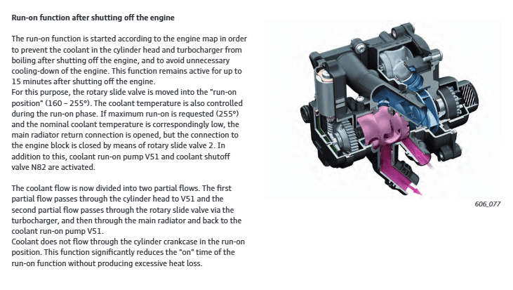

Have a look at self study: ssp-606 to see an overview of the EA888 coolant system.

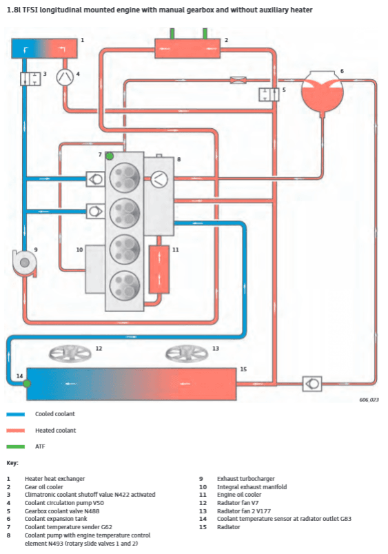

As a general comment, I would say an expansion tank does not normally have any coolant flow - its just a high point to collect air and allow space for coolant expansion.

All I can confirm at the moment is, that there is certainly a run-on pump operating in the 2019 Leon Cupra after a hot engine switch off, which is what I'd expect.

In the 'general coolant' layout image I shared, you can see in the LH feed pipes there is a restriction, and the RH pipe an one way valve, so i'm sure they don't intend any meaningful flow through the header tank.
Thanks for that, I've just run the coolant pump for my S4's supercharger intercoolers, and yes I can hear it running, but no coolant being returned to the reservoir - the engine was cold when I tried that, so my idea of what normally happens with all cars wrt coolant, though maybe only low volumes, getting returned to the coolant reservoir, seems to be falling apart!
