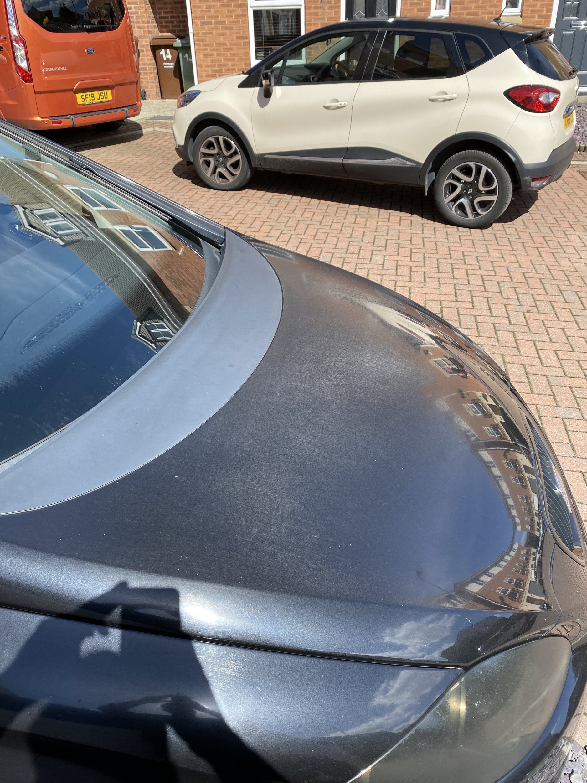

I noticed recently that my paint on my bonnet appears to have faded. Any tips for fixing this up, and has this happened to anyone else?
Lots of swirls on your paintwork. Probably a lot of improper wash methods have resulted in your paint work looking a bit dull. A good 1 or 2 stage polish should bring it back.
Either pay a professional to do it, invest in a Dual Action polisher or do it the old fashioned way with a hand polishing pad and compound.
Reactions: Jay5959 and t80lew
Buy a dual action polisher and polishes, you will be glad you did, the car is riddled in swirl marks which in turn makes the paint look "duller"

I’ve had my DA polishing machine for around 7-8 years now and although it doesn’t get used that often to polish the entire car - maybe once every 18-24 months - it‘s more then paid for itself many times over.
It’s really useful for localised spot correction - like removal of etching in the lacquer from bird poo if you’re not able to deal with the offending bird poo immediately after the event. I also had a real mess on the bonnet of my previous car from water dripping off the concrete roof in a multi story car park onto the car. My DA with an appropriate combination of pads and polishes sorted that out in no time at all.
I’ve used it a few times for correction of the piano black trim on the B pillars, and it works a treat and is very effective at removing swirls and scratches - with the right combination of pads and polishes of course.
