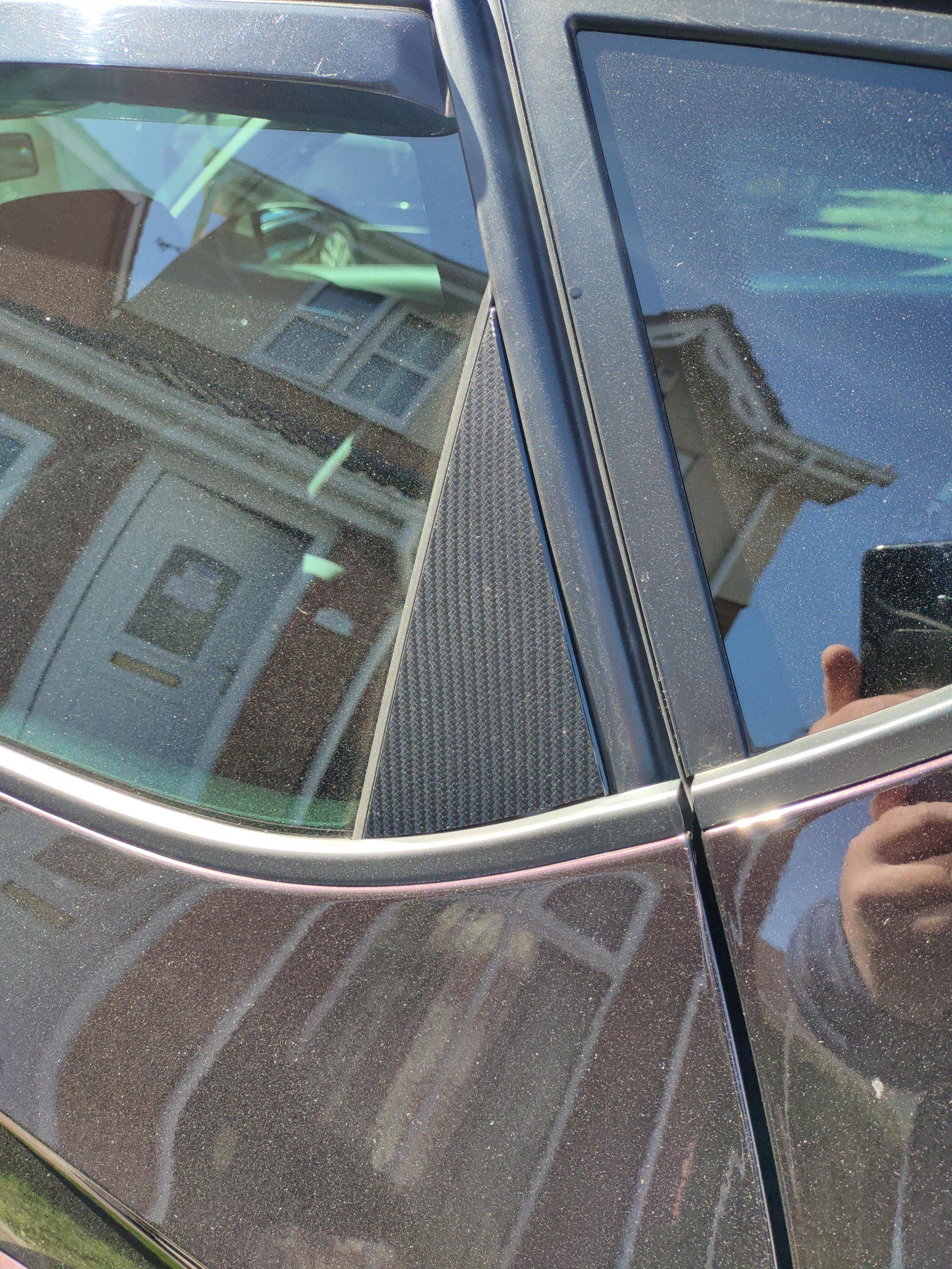

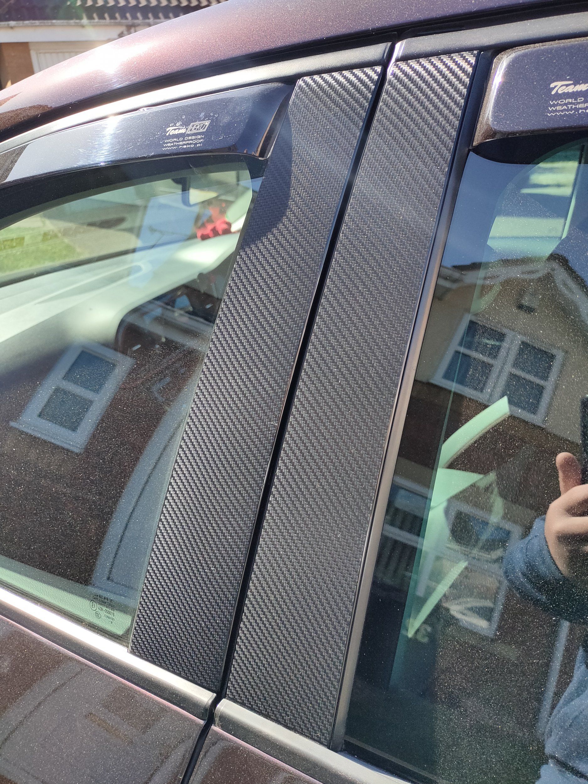

I've fitted these from EZM..... I tried the Carbon Fibre Gloss but that didn't look right so went with the Carbon Fibre Black
View attachment 23932 View attachment 23933
That looks great! I asked a company that does car wraps how much it would be to wrap the door pillars. They quoted £200! Was it easy to fit? Is the vinyl pre cut? Do you need to trim the vinyl round the edges with a Stanley knife?
Thanks. No trimming required.... all pieces are pre-cut. It took about 20-30 minutes to do the lot. Use soapy water to wet the black bits. This allows decal to slide around to get position right. Then use credit card, or similar, to squeeze out water and a hair dryer to help it stick. You have to be quite precise with positioning as the pieces are virtually the same size as visible black areas. Also, be careful when washing the triangle bits as the top is a fine point and it can start peeling back. Otherwise no problems. Hope this helps
