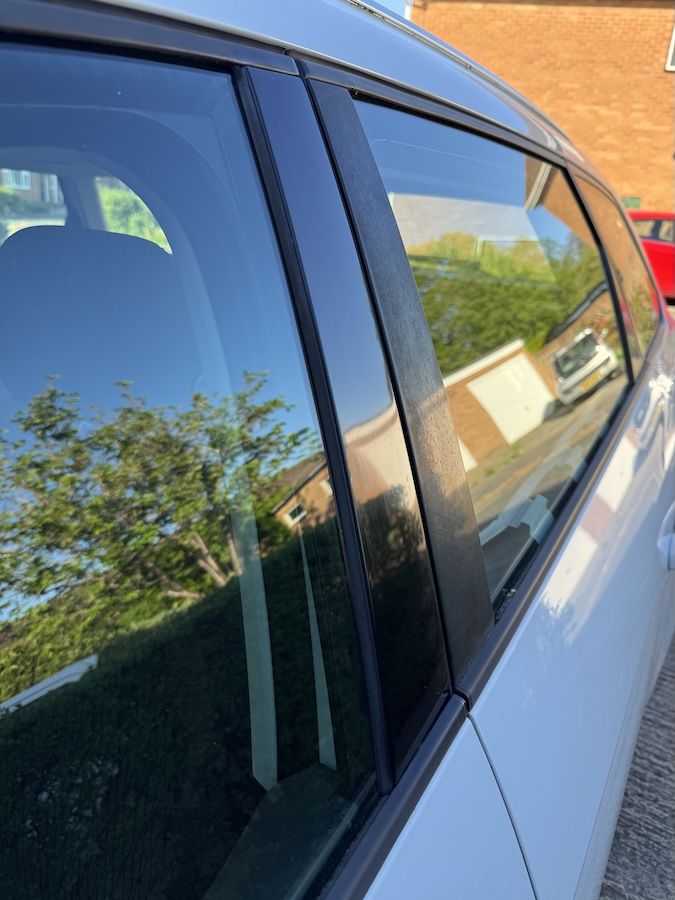

Just in case anyone else is thinking of doing this - I had a very quick go at one piece of trim this afternoon. Just a test really but the results are good enough for me, for now.
I didn't have time for a full wash and you can see how dusty the car is (and it's a very sunny day). A quick spray with some rinseless wash, then clay bar, then panel wipe, purely on the trim itself. Then a hand polish with Zaino Z-14 (which is fine to apply in direct sunlight).
Here's a "before and after" comparison:
As you can see it's not perfect - there are still some deeper marks left which I'll never get rid of and a lot of quite deep vertical score marks (presumably from the previous owner using one of those "broom" things at the jetwash). It needs another go over when I have more time. But with a filler wax over the top it'll hide most of the imperfections between washes (I like Bilt Hamber Auto Balm).
I'm couch-surfing at the moment so all my proper detailing stuff is in boxes. When I can get at my decent polishing pads I'll have a go at the rest of the trims. Meanwhile I'm happy enough with this as proof of concept!
I'll update this thread with the finished article, whatever the results ;)
