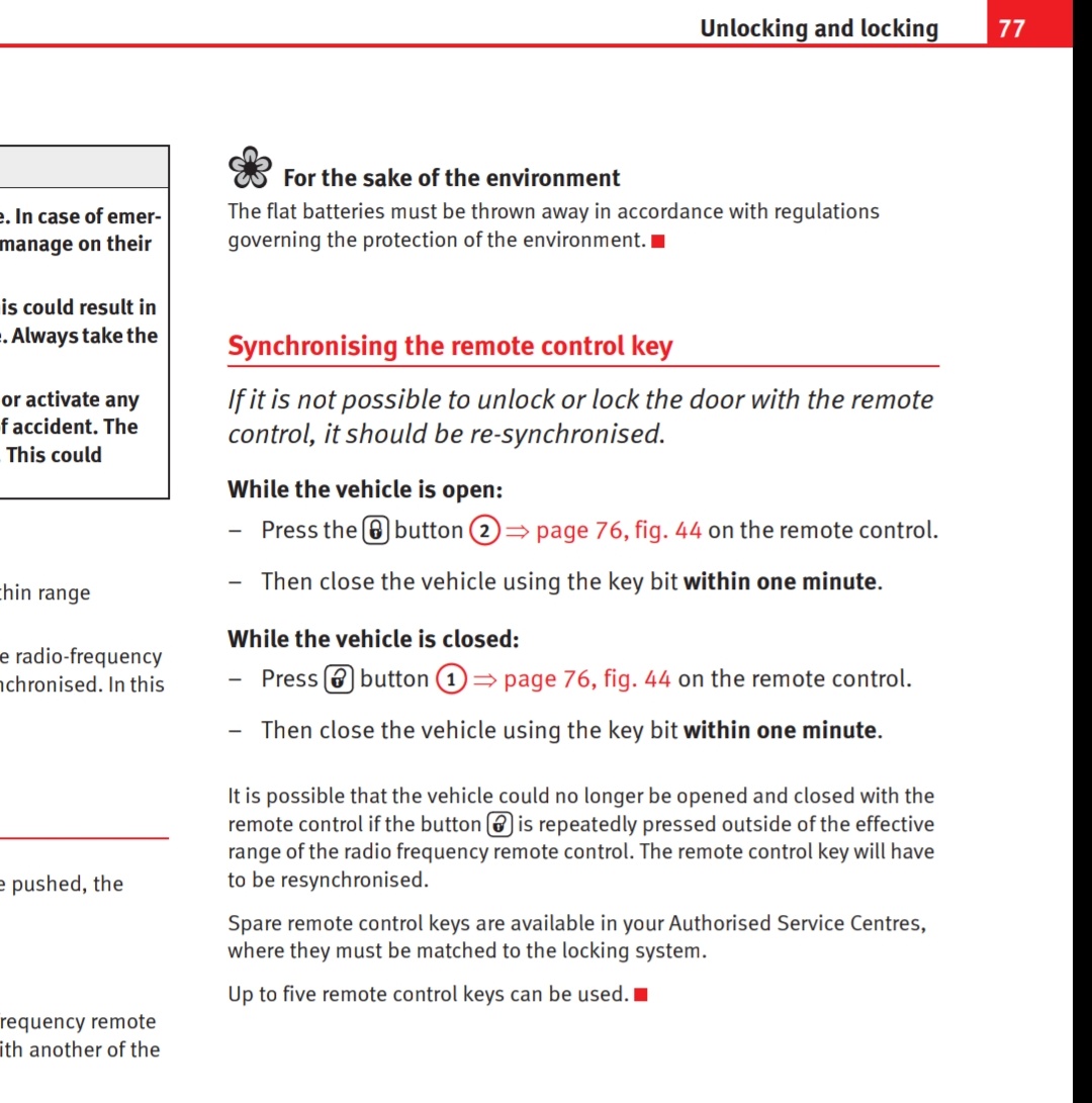

Hi I've got a problem with my key fob for seat ibiza 2009 sport 1.4 (2008-2017) wont lock or unlock remotely. Its a 3 button key, same as for VW. I only have one key and i can only lock and unlock manually.
Has anyone got a procedure how to program / sync the key ?
I've changed the battery.
Any help will be much appreciated.

Evening,
Just looked at your manual from here
http://www.seat.co.uk/owners/your-s...l?model=Ibiza 5D (2009)&id=22&_charset_=UTF-8
It seems the below may help...

Bad times, I know some SEAT's need keys programming in with VCDS or the sort.
Maybe worth posting this question in the Ibiza sub forum for more like minded ibiza folk...
Hopefully get it sorted soon
