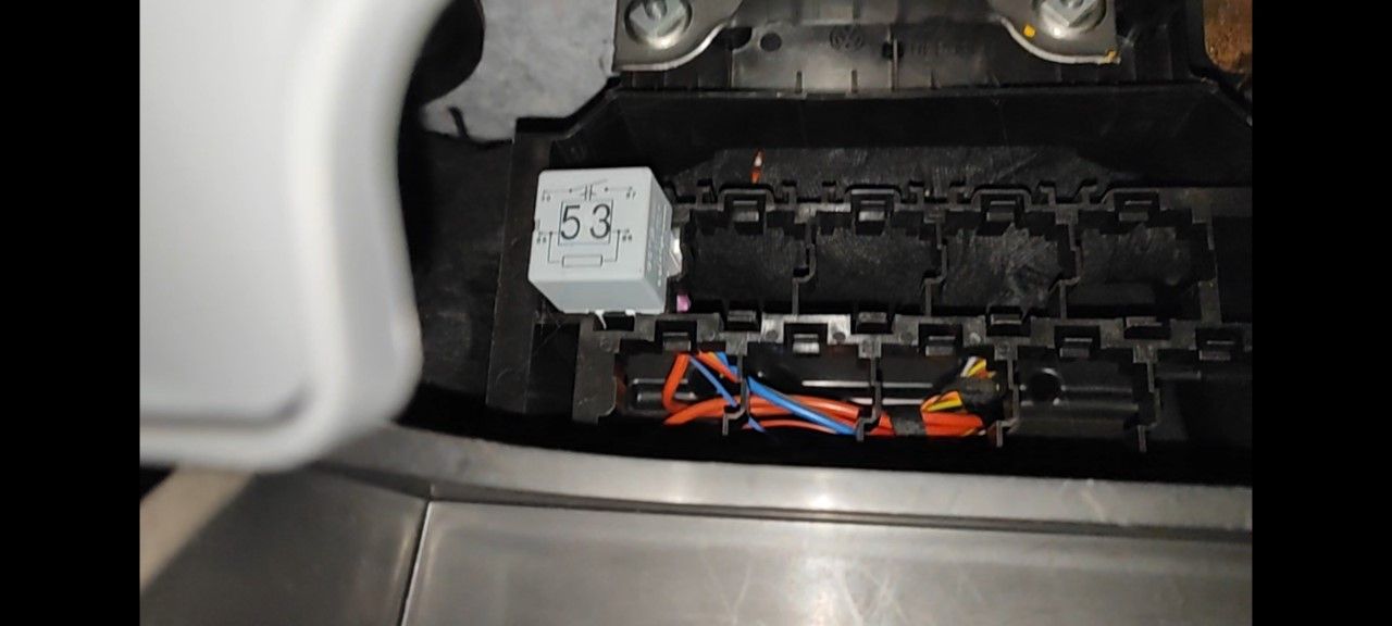

Does anyone know where the fuse/relay is located for the windscreen wiper washer pump ? There are no diagrams or information for this. The pump isn't making any sound, will check fuse/relay before replacing the pump itself.
Any advice would be much appreciated, thanks.

Relay holder only has 53 which corresponds to the horn relay.

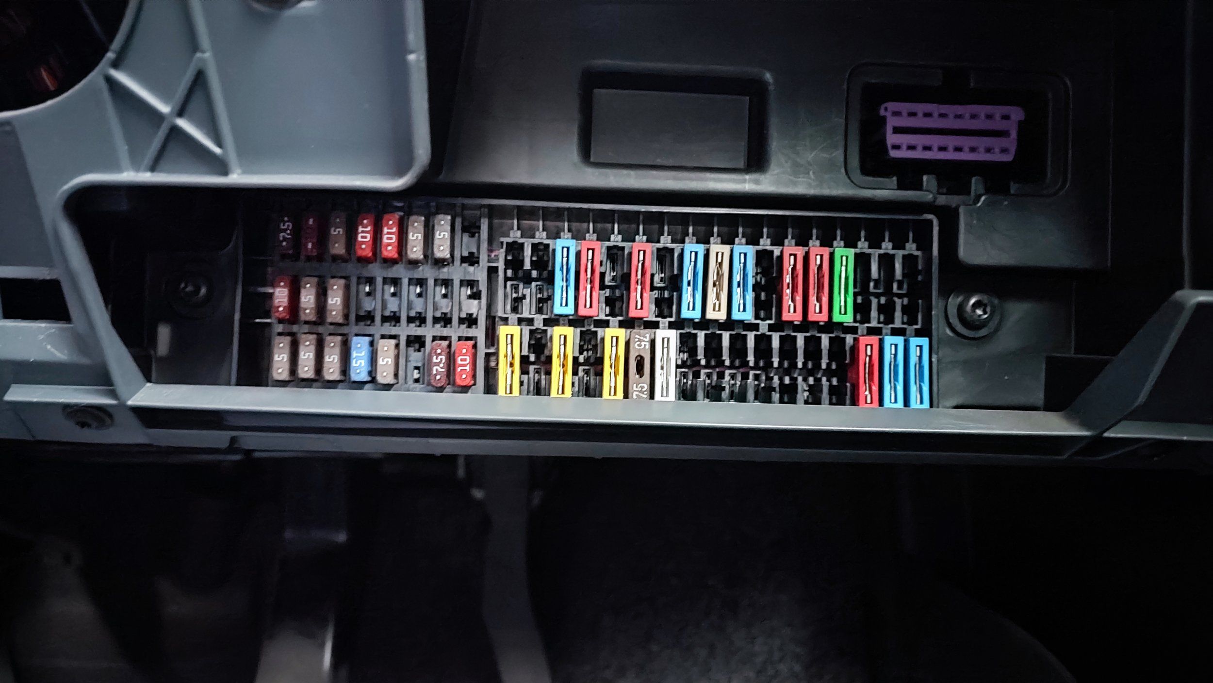

I think it's fuse number 9, 10 amp left hand side of the middle row of the small blade fuses in the picture you posted.
