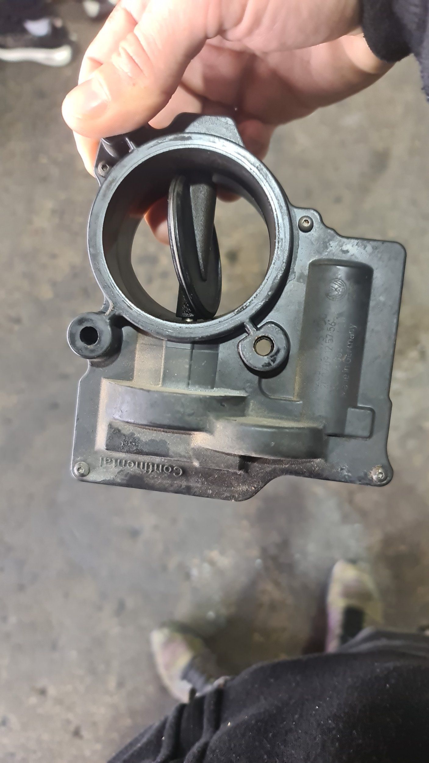

So in the end ,in the garage he checked any system error and said the throttle body was failing ,after changing it ,didn't feel any power loss anymore butt the car one time smoked in the evening after not touching the car for couple of hours ,called the mechanic and he will check the cat again tomorrow, after all its an expensive part to replace .
Think he's right on that part?
He also said maybe it's leftover ,and also there's a leak in the cooling system he found the tube that has a leek in
it will be fixed after the parts will arrive
