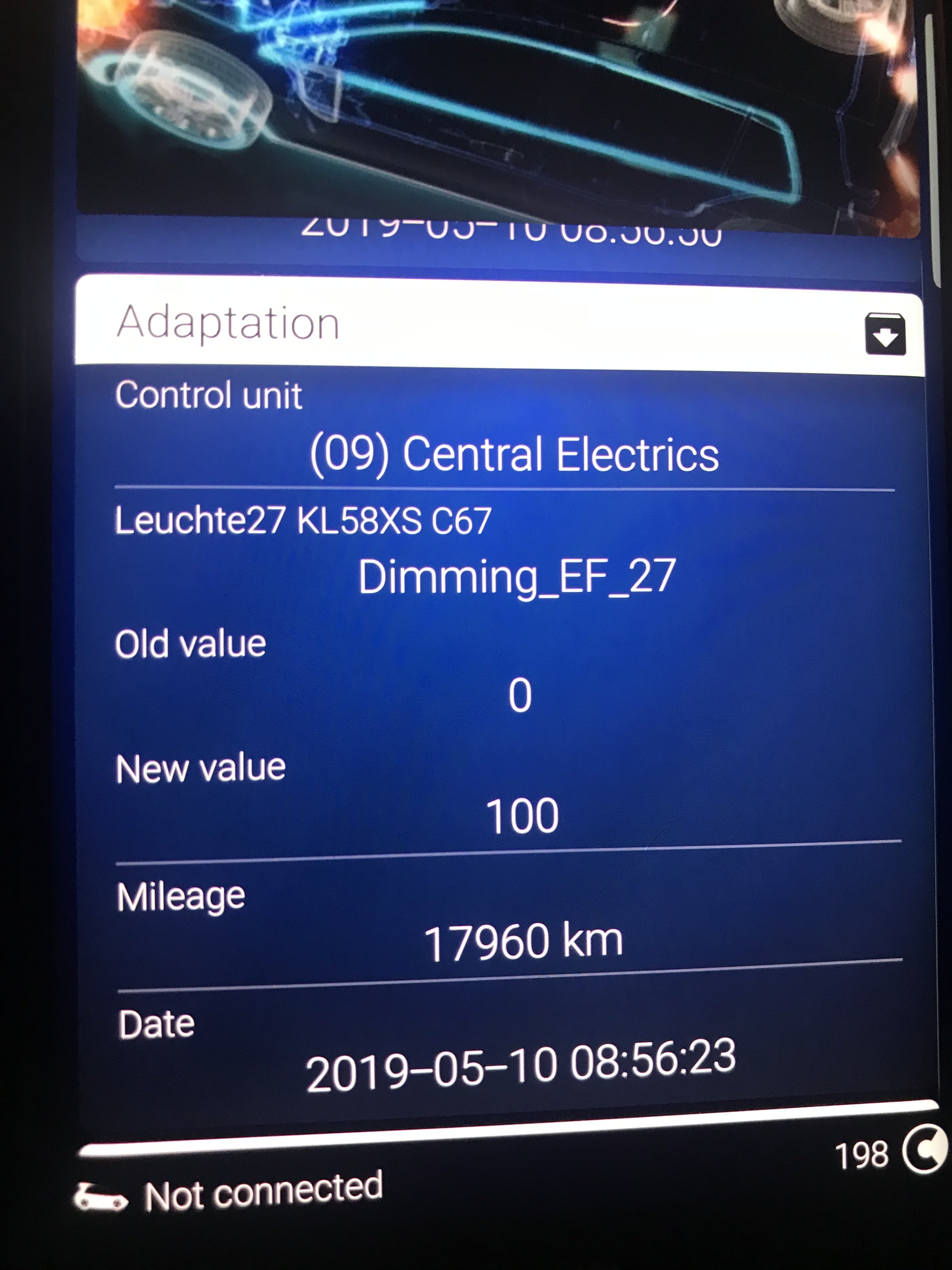

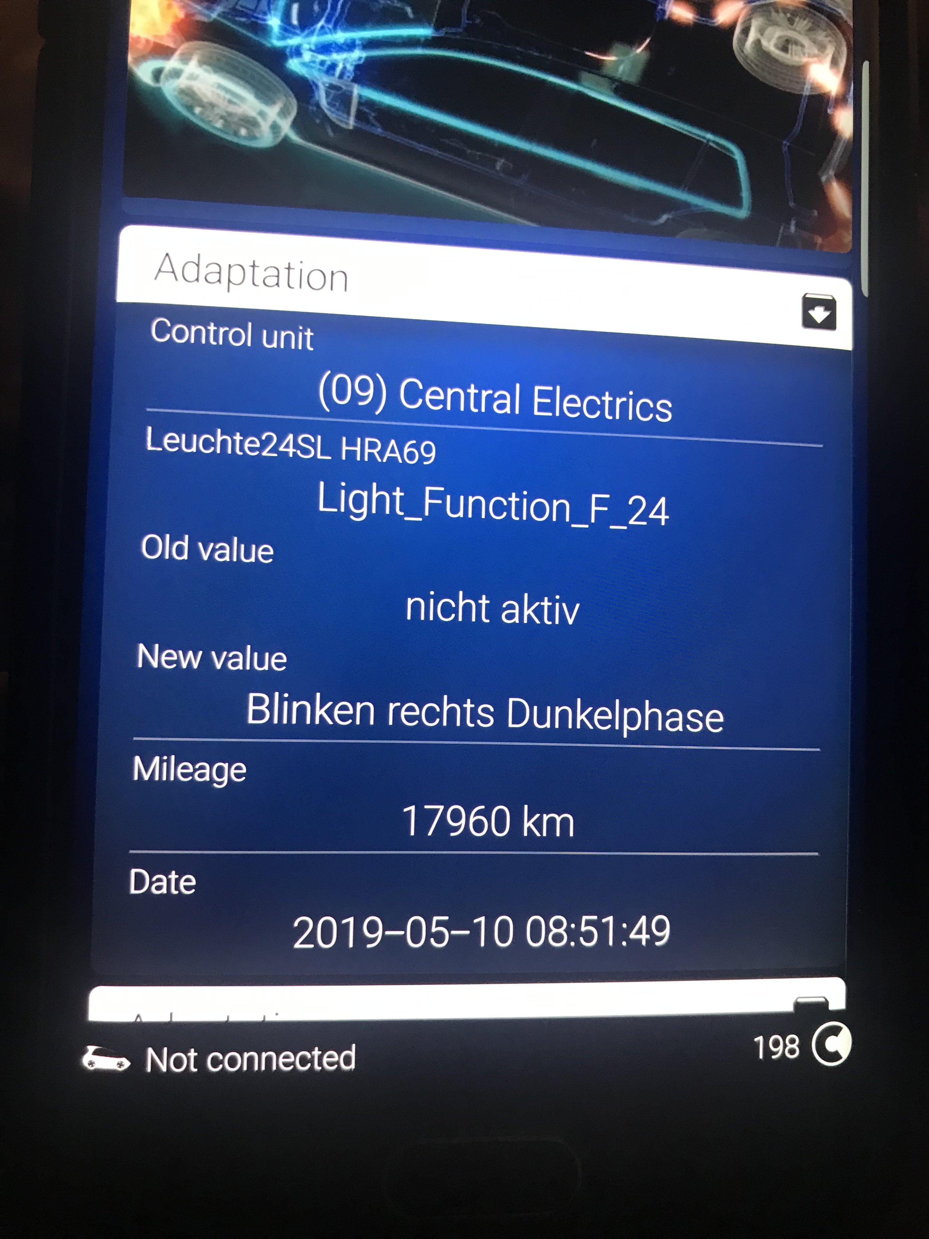

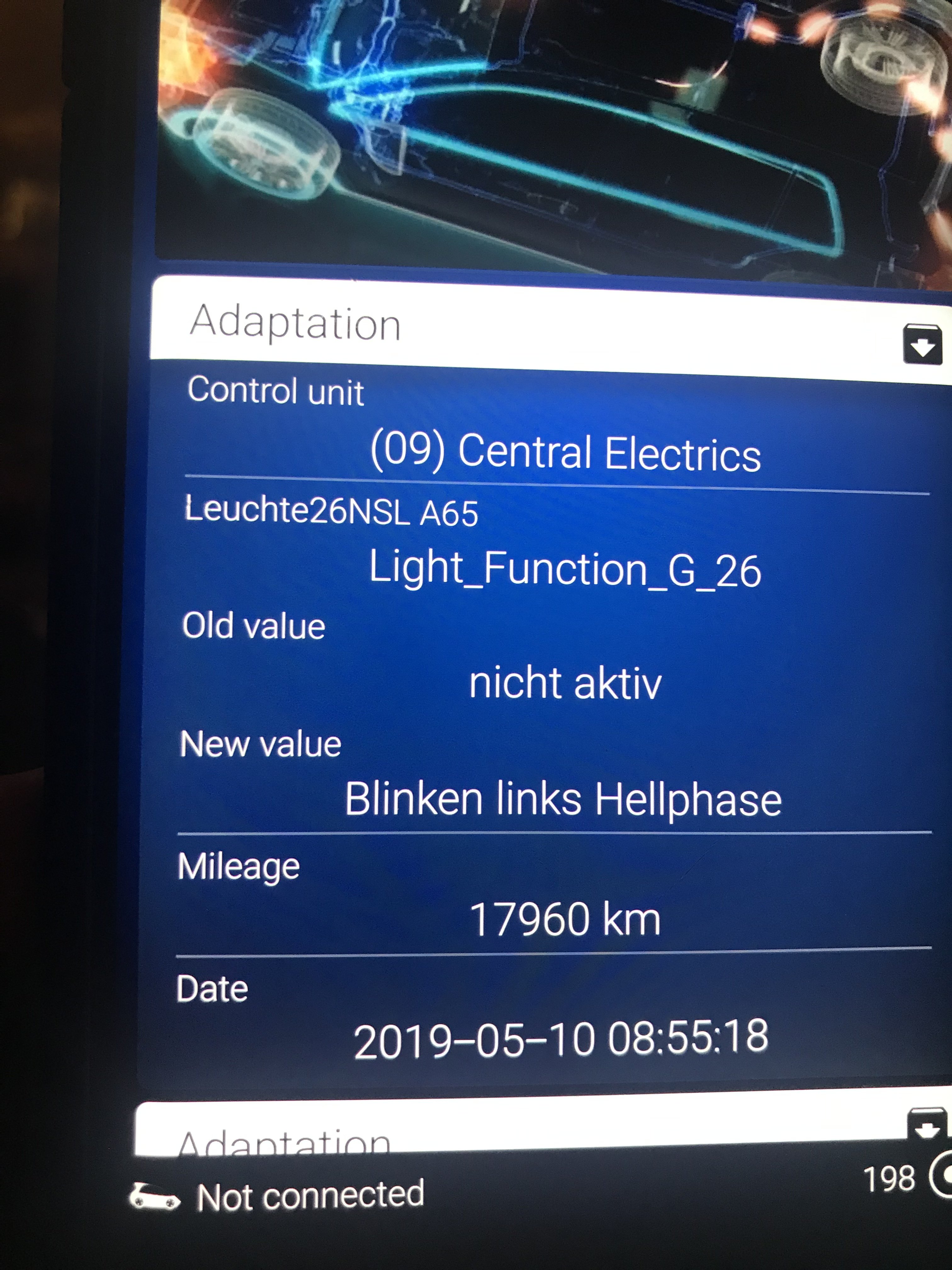

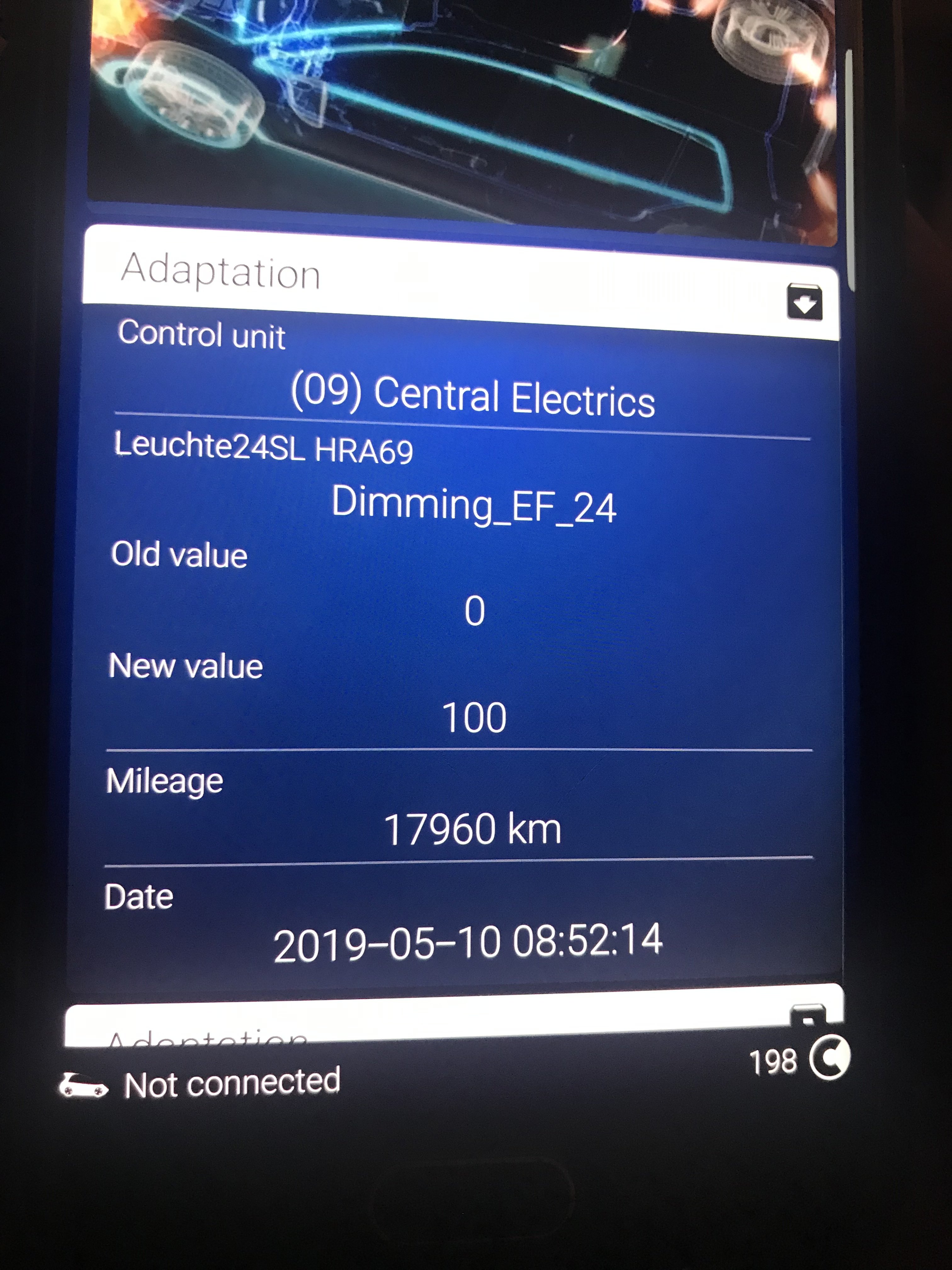

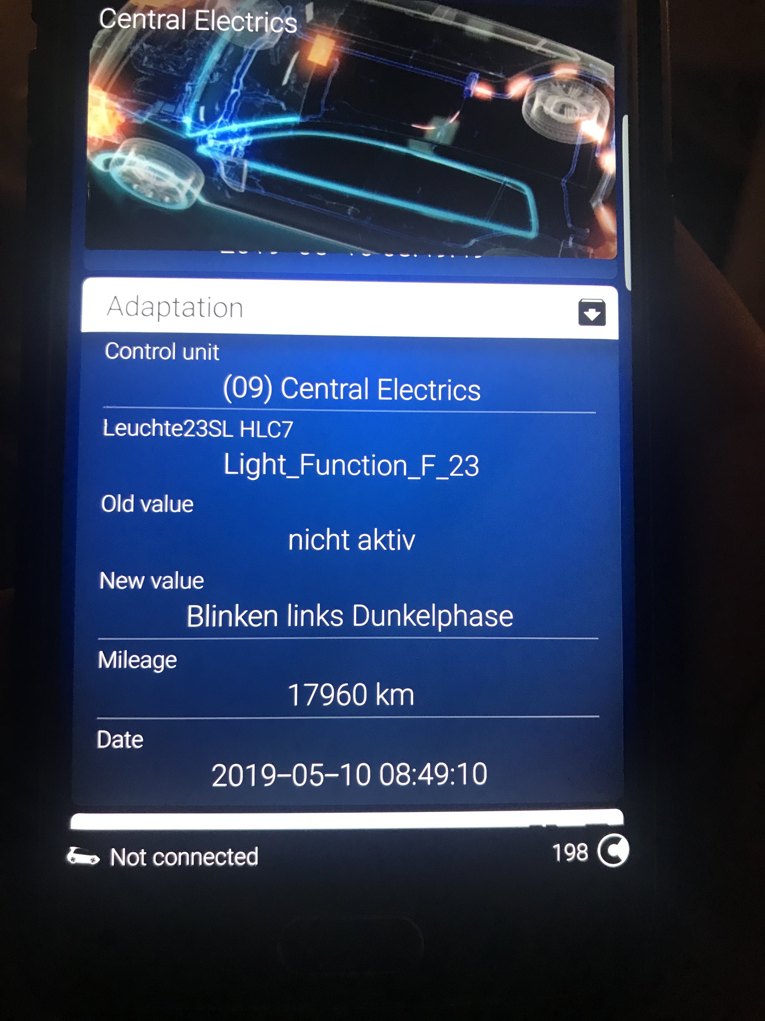

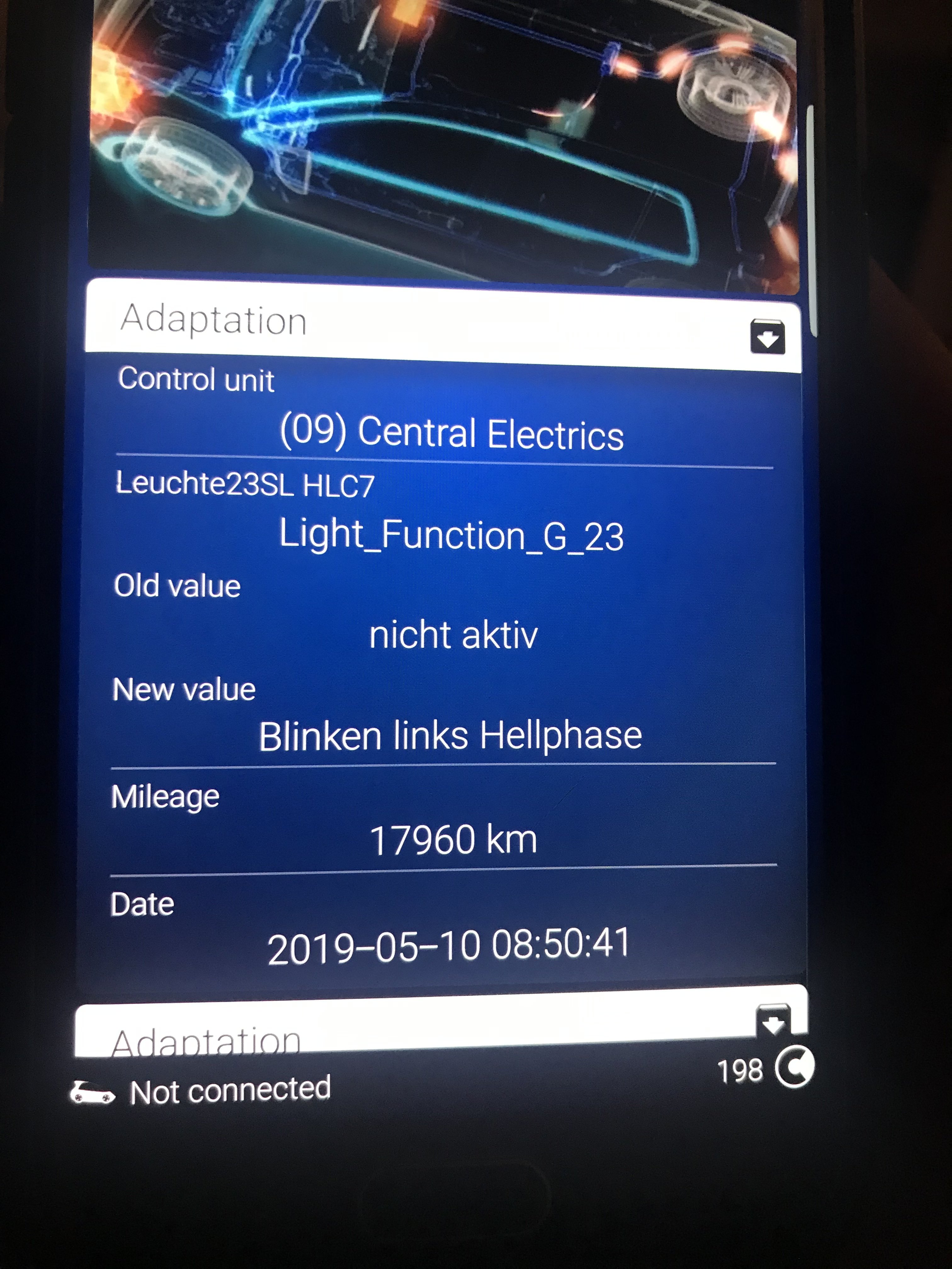

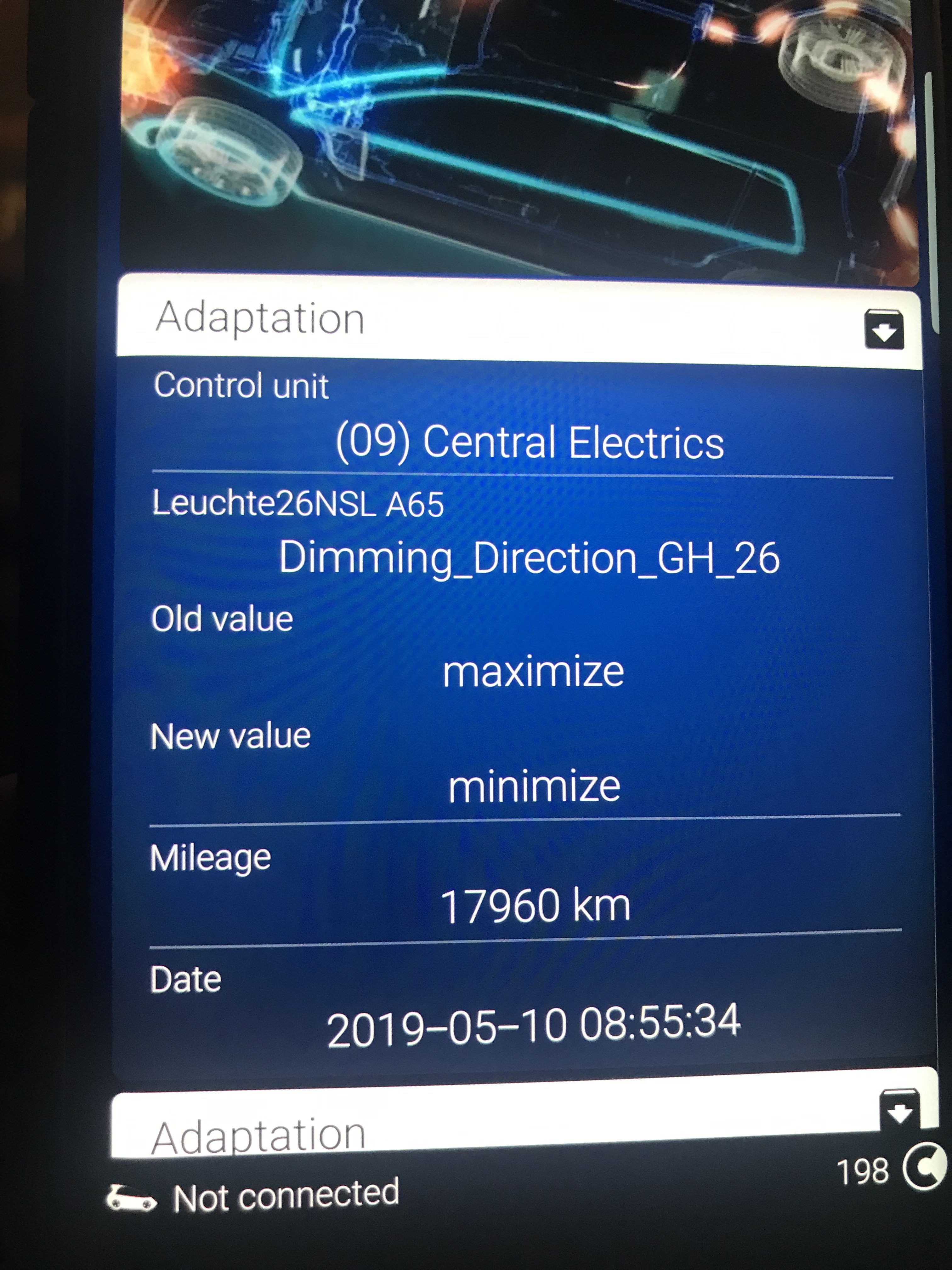

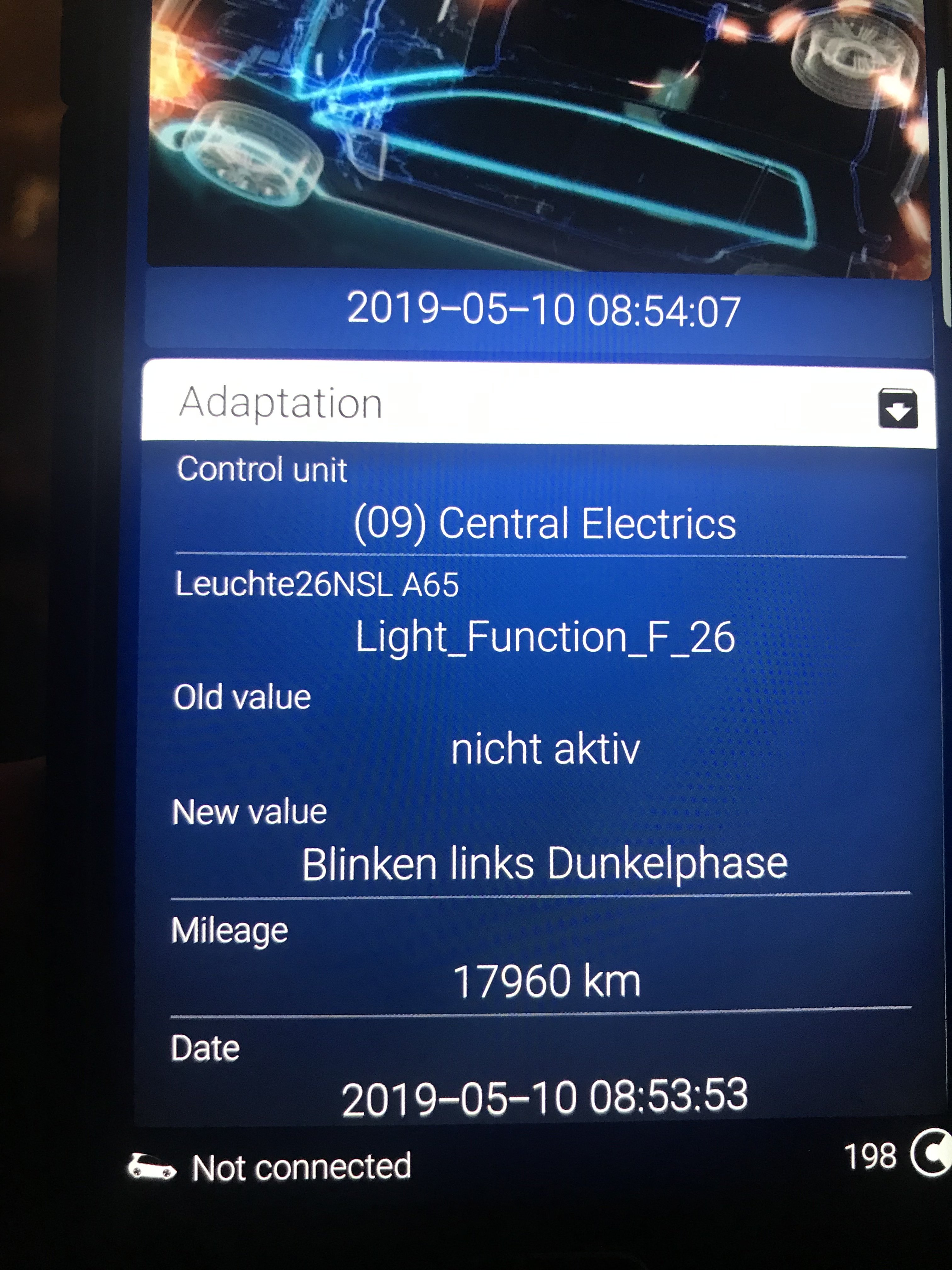

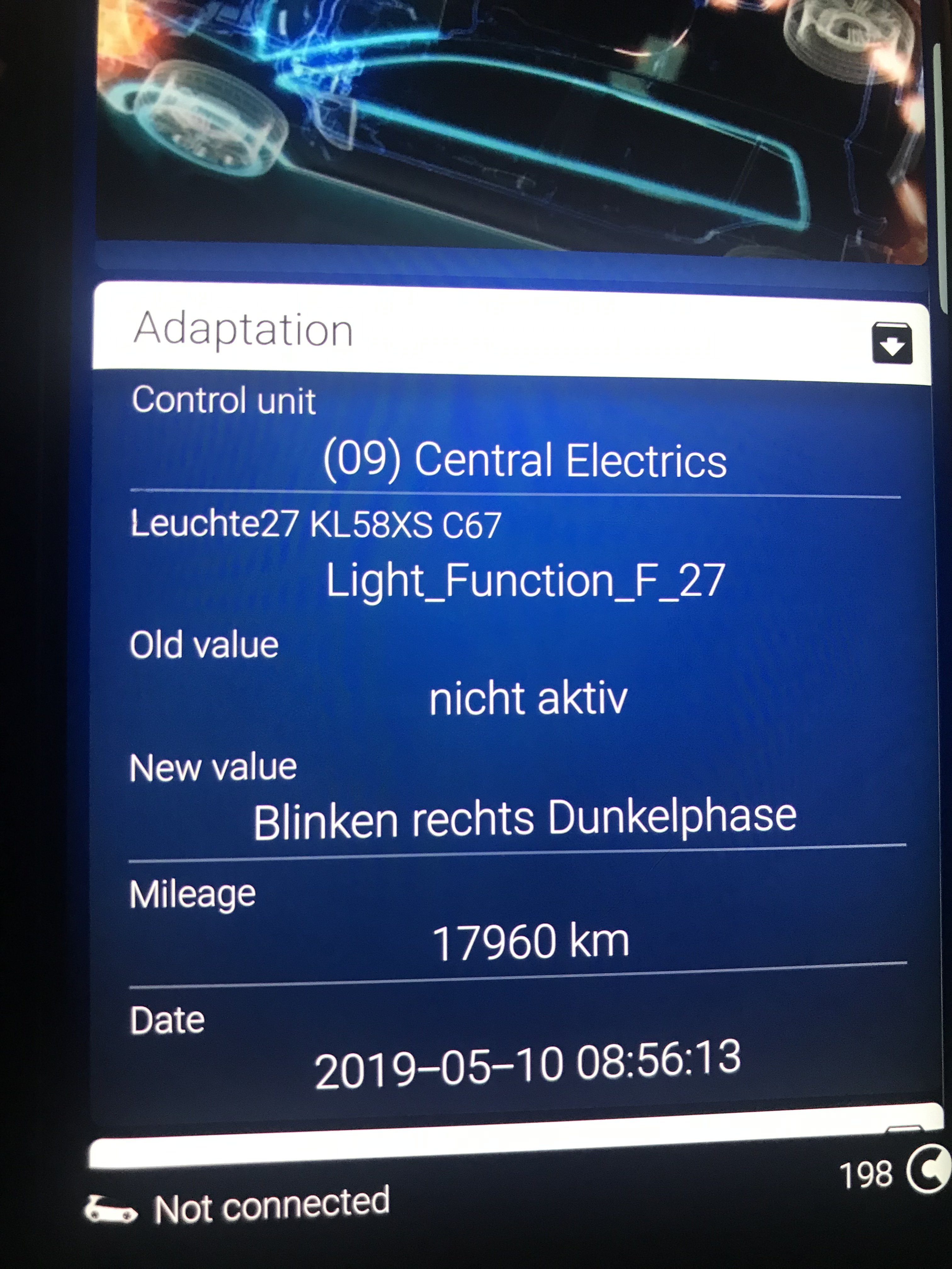

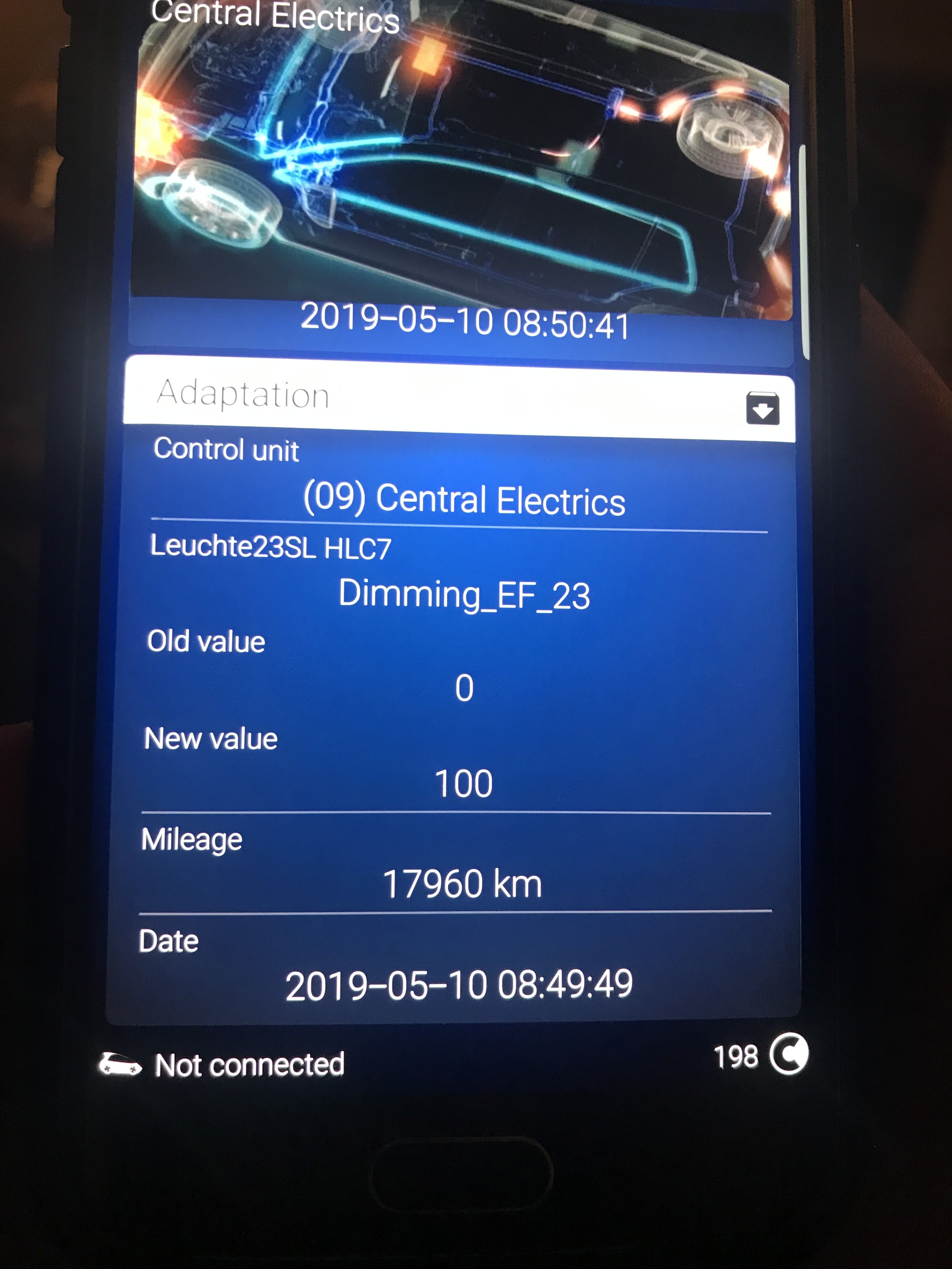

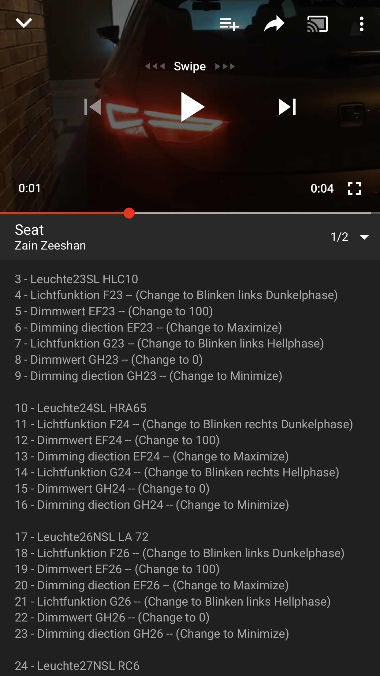

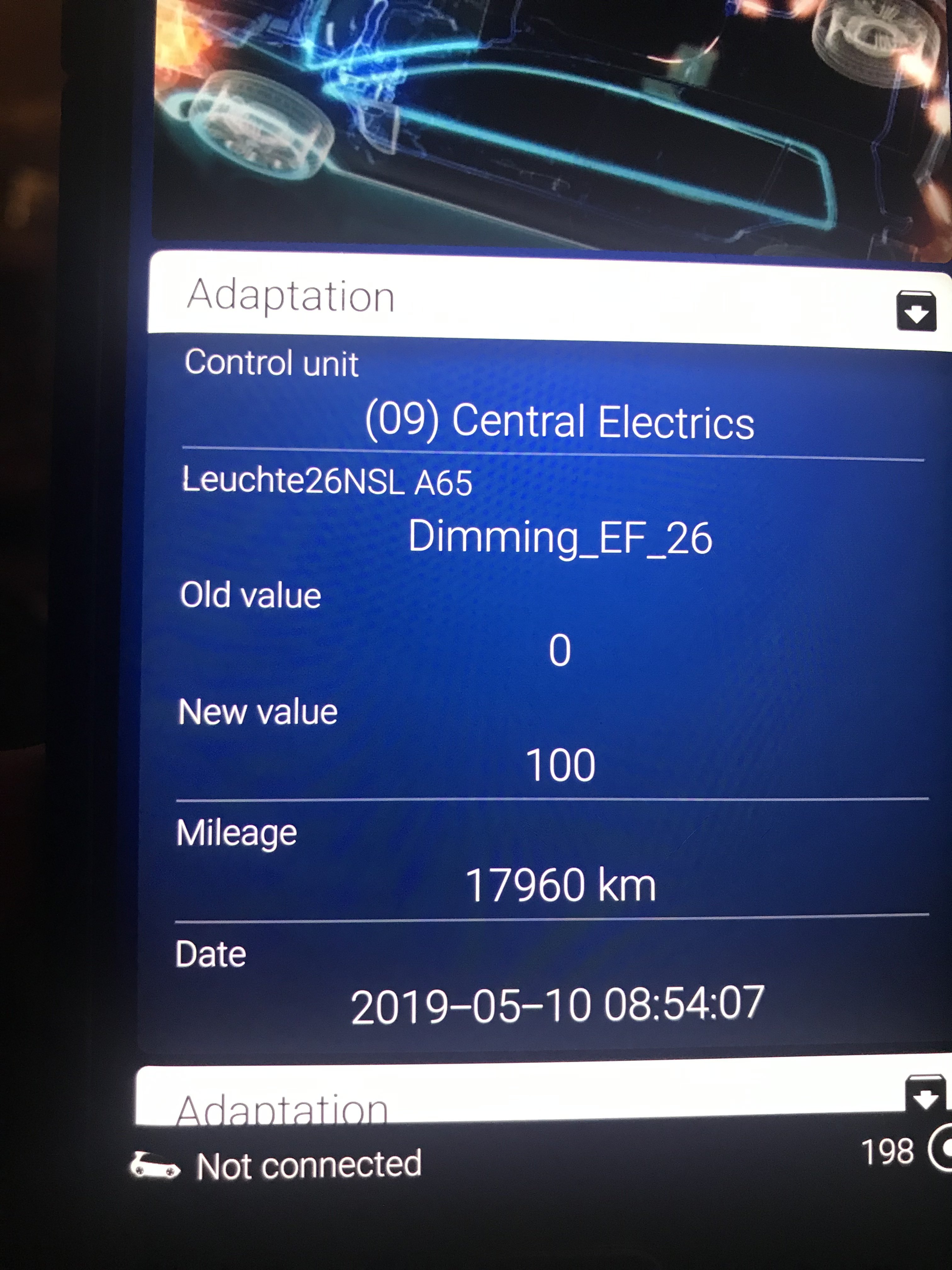

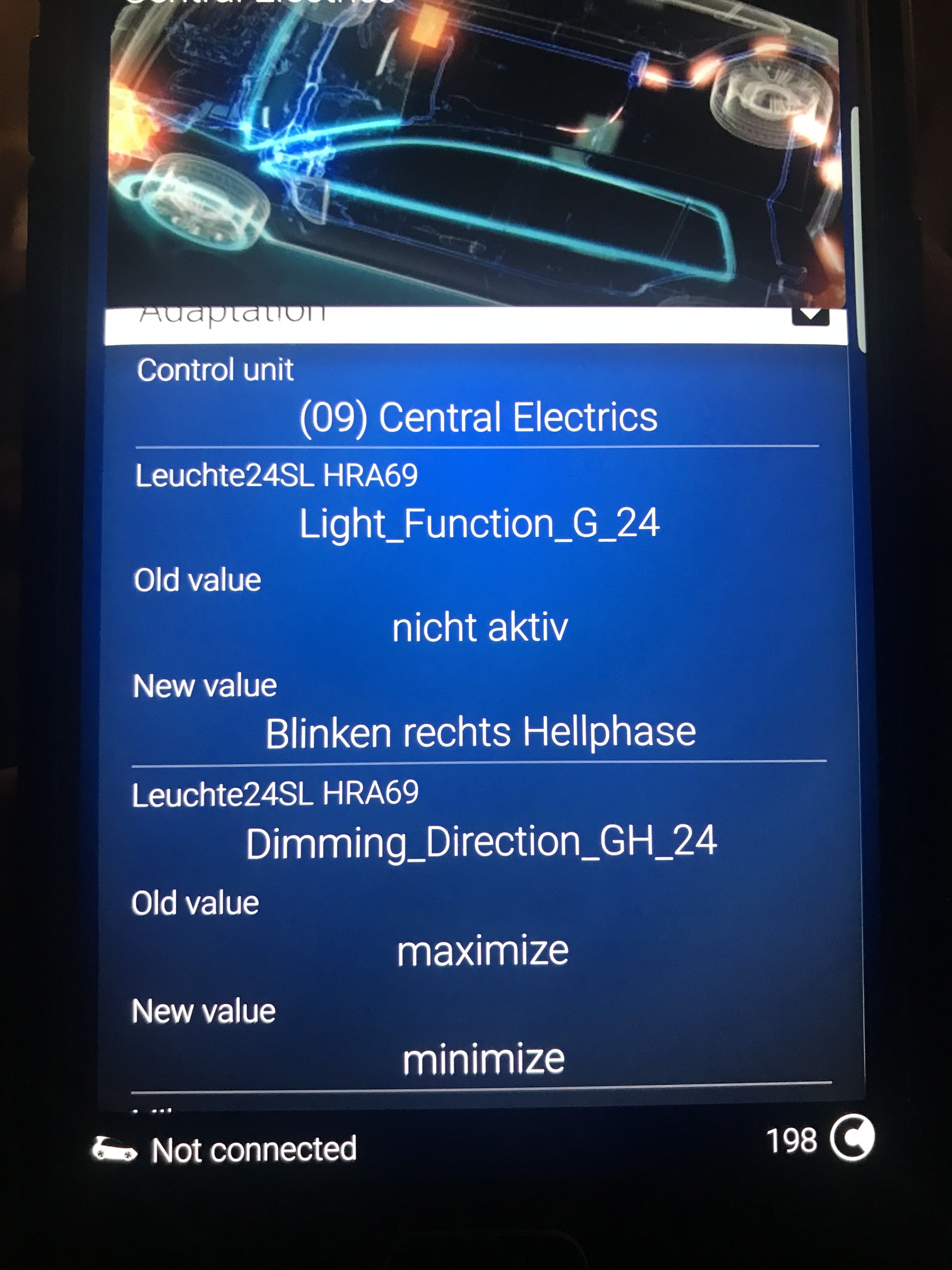

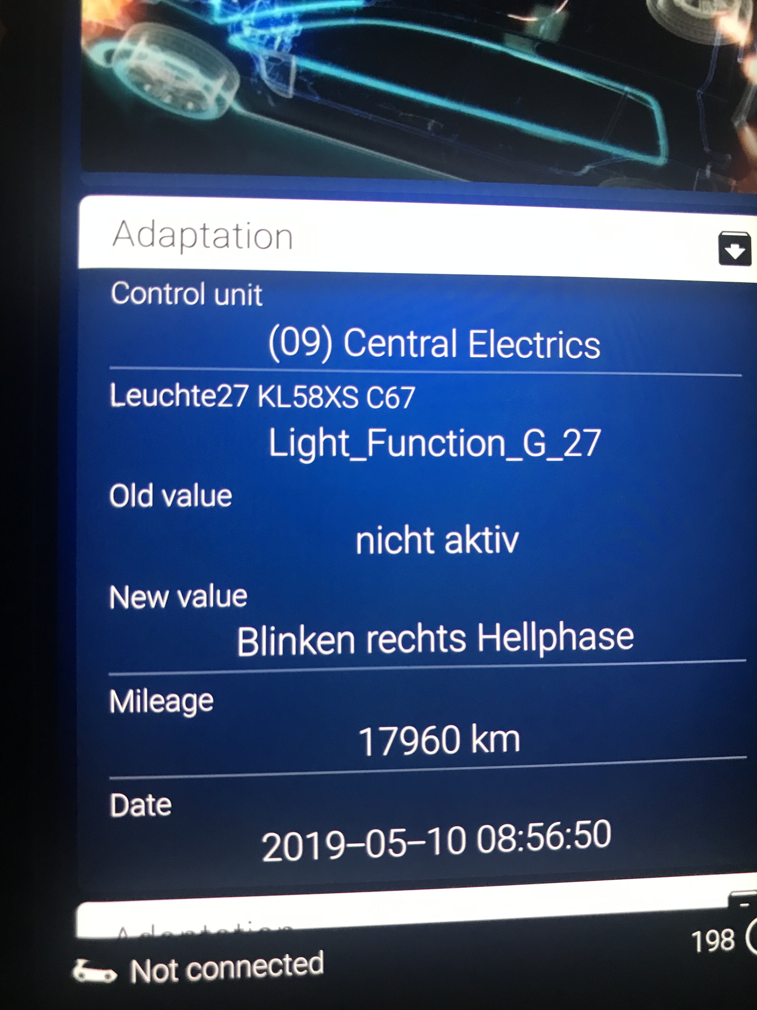

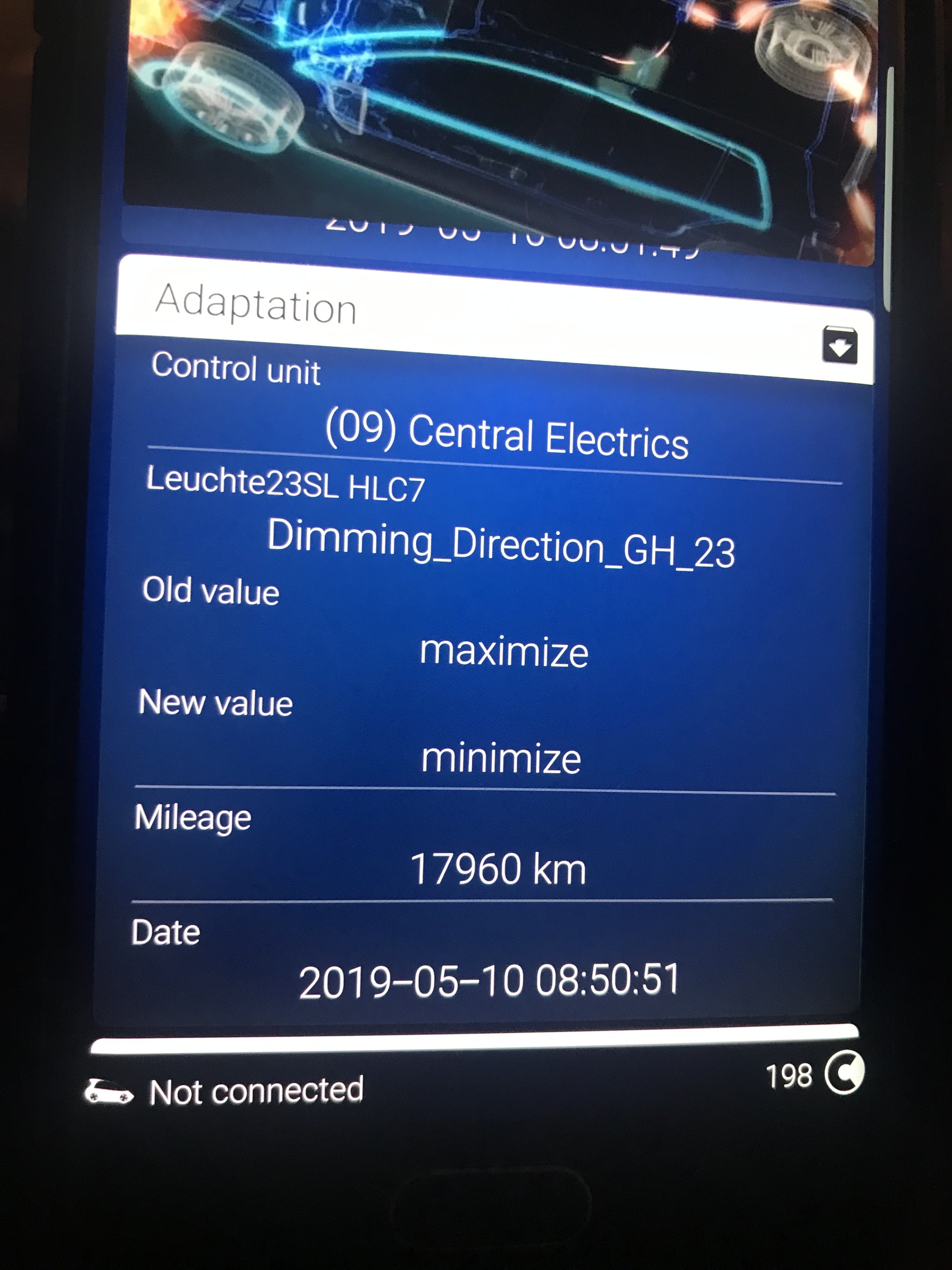

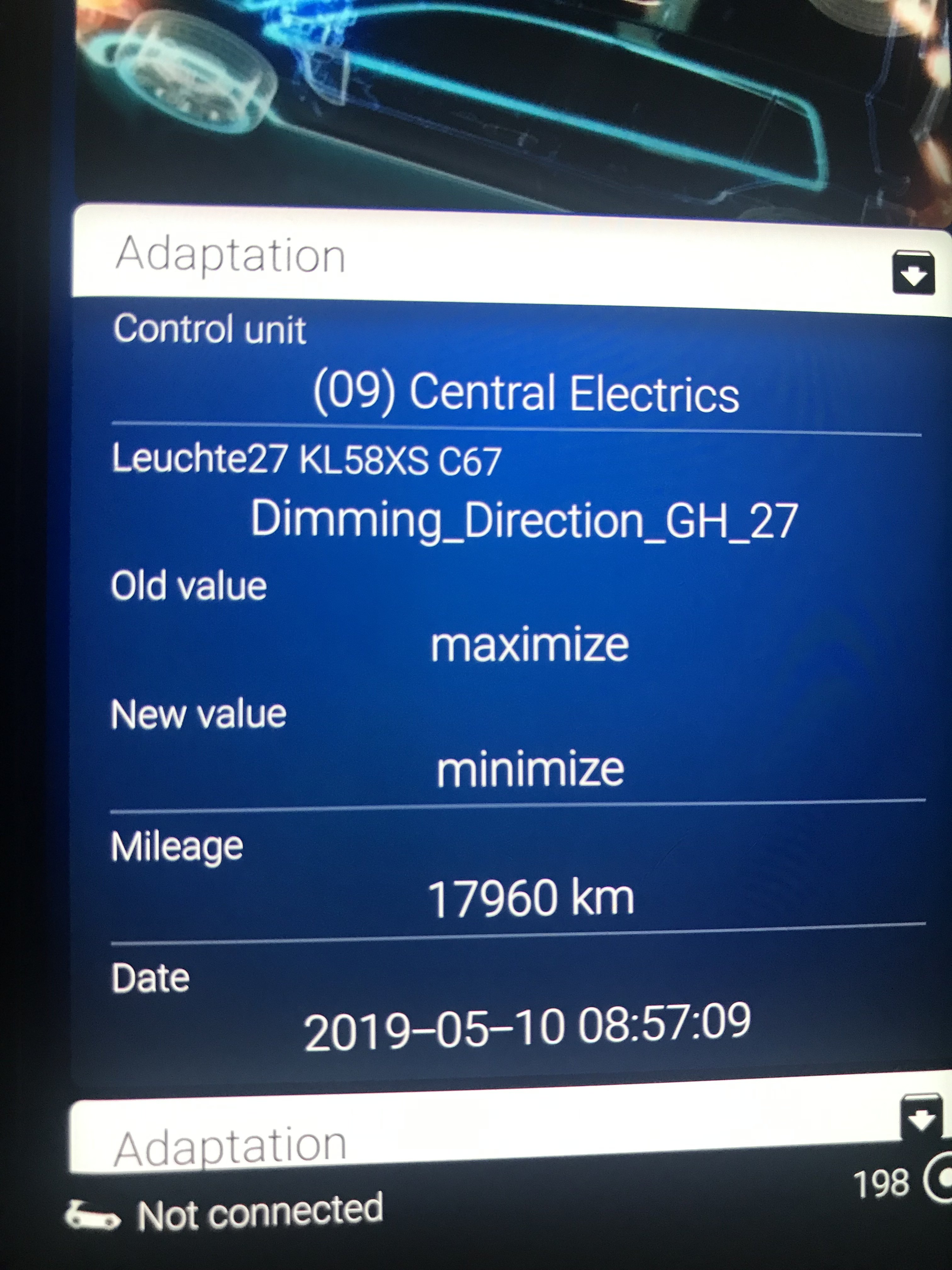

I’ve taken pictures of everything that was changed, do you have an idea now how to switch them 3 dots off
Thanks
(Screenshots are over two posts)
View attachment 7041 View attachment 7042 View attachment 7043 View attachment 7044 View attachment 7045 View attachment 7046 View attachment 7047 View attachment 7048 View attachment 7049 View attachment 7050
Check your settings in leuchte 24 and 27. This is die the right unit.
Also the lepn 5F has 23,24,26 and 27. Leuchte 23 and 26 is left unit. 23 outside and 26 inside unit.
For right unit 24 is outside and 27 is inside unit.
The ibiza 5F dont have this.. trie to set leuchte 27 blinken rechts to not Active. And then leuchte 26 etc. Til the light is off.

No thanks! I code this options a lot to vw, audi, seat and skoda..Thank you, you’ve been a great help I managed to get it turned off by switching off G and F value to nich aktiv for both Leuchte26 & 27 and then it worked
I left everything else the same I.e dimming, dimming direction
That should be okay I imagine?
Yes that is no problem. You also could set dimwert to 0% if you put this to 100%(output)
But with not Active this is the same. Only for some functions. You need dimwert. Like with us lights etc.
Problem with coding leuchtes not all the cars are the same... ibiza 6F have other leuchtes, then a leon 5F etc. I always check them before coding.
