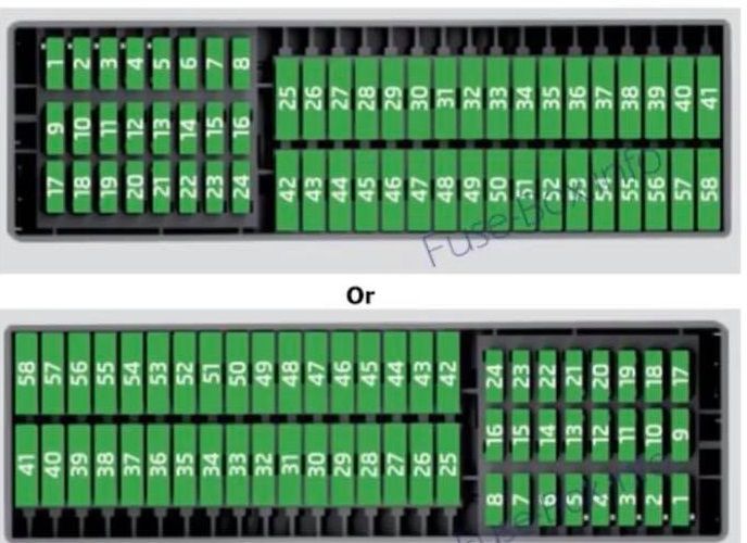

I keep struggling to find the fuse box diagram for under the drivers steering wheel (RHD) as they all appear the wrong way. I have finally found one that actually has it the right way round (at least on my 2010 Ibiza it is the top one) so adding it here to help others.

Hi, can you advise which fuse is linked to 12v socket please - 1 source i found says 27 another 41?
On my 2010 it is 27 (I don’t have anything in 40) but pulled out 27 and cigarette lighter stopped working.
