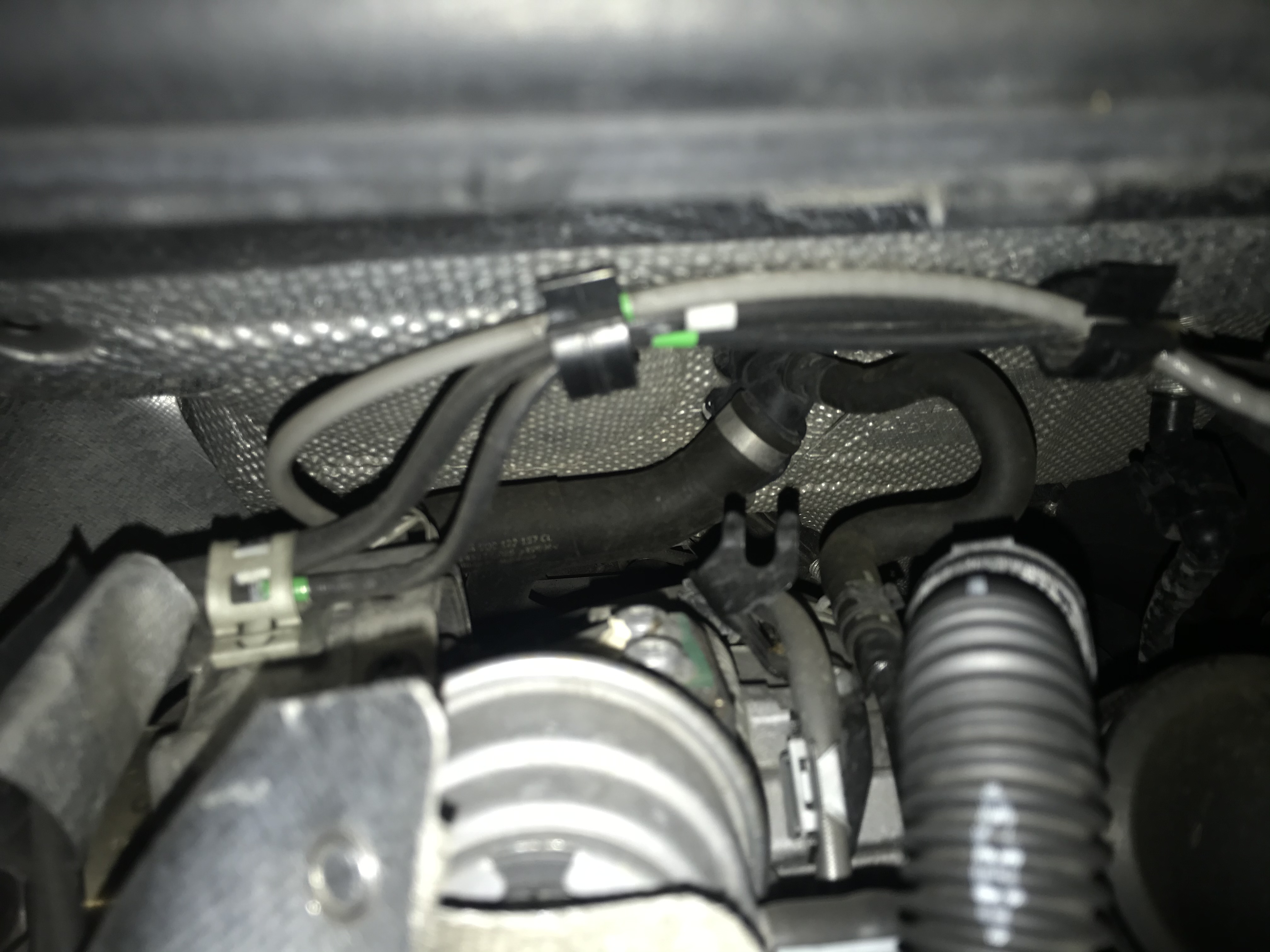

Thank you for both replies. These pipes? Both were warm and not hot (could keep fingers on them)
Coolant was at 90c after 50 min commute heat on max it was next to no heat inside.
Trip to garage then and a hefty bill

That's the ones, correct.
If you go to an independent garage, not a dealer, you could try suggesting they remove the matrix through the glove box - which would save several hours of labour costs.
