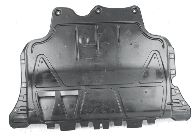

Recently thought about getting an engine under tray for my Seat Leon Cupra 290 (Year 2020) Mk3, with it coming up to winter conditions again. It didn't have one when I purchased the car last year.
I believe the part number for the Under Tray is SKU reference: 5Q0825236N? Let me know if incorrect.
Are the following codes correct for the fasteners used to fit the under tray?
  • WHT000729A - Self locking hex head bolt (not sure how many are used)?
  • N90335004 - Starlock washer (again not sure how many are used)?
Or is there any specific code for an assembling kit to go with the tray?
Final question: Is it worth buying the parts and getting a local garage to fit or get SEAT to complete the whole job (get the parts from stock and fit)?
With thanks to @Craig.
- Undertray: 5Q0 825 236 Q
- Will need 3x WHT 000 729 A (to secure the undertray at the rear just by the sub frame)
- The existing undertray has the other bolts/screws required.
Undertray has 4x/3x 2x torx on each side and 1x screw/bolt at the front in the middle

There's actually 4x on one side and 3x on the other, plus the 1x in the centre = 8 screws
N90974701 x8 Torx screws
WHT000729A x3 Torx bolts M8X20
