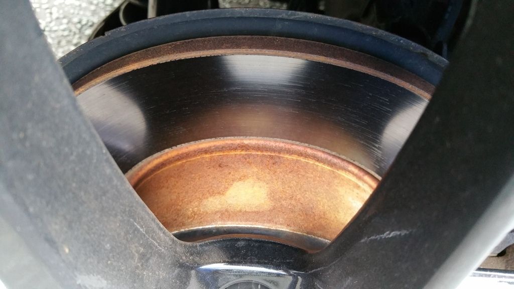

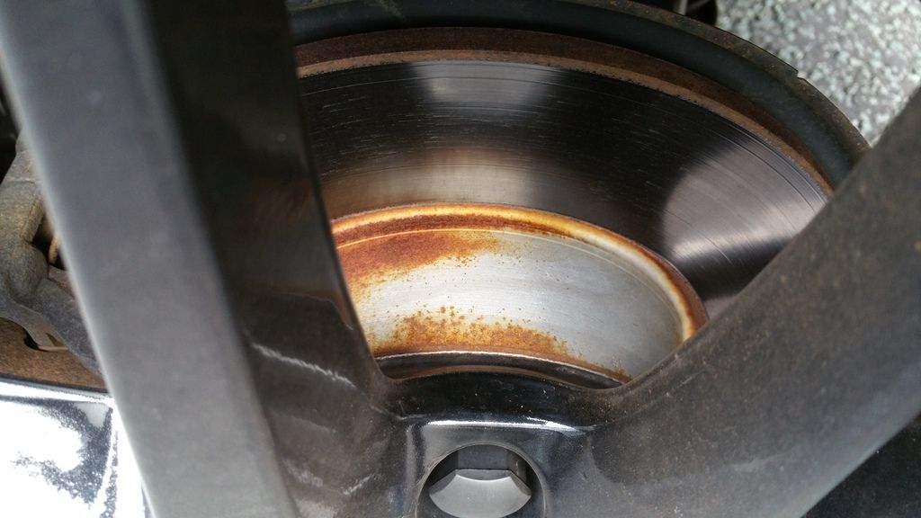

I was going to paint them, but so far (8 month & 4,000 miles on) they don't seem to be to bad:
Rears.
Fronts (after a clean).
Rears.
Mine also look ok, year old and 6000 miles, do wash right into the hub area using zip wash which has wax in it, so maybe that helps. This is my 7th SEAT and never had rusty hubs.
