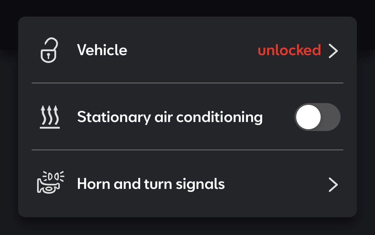

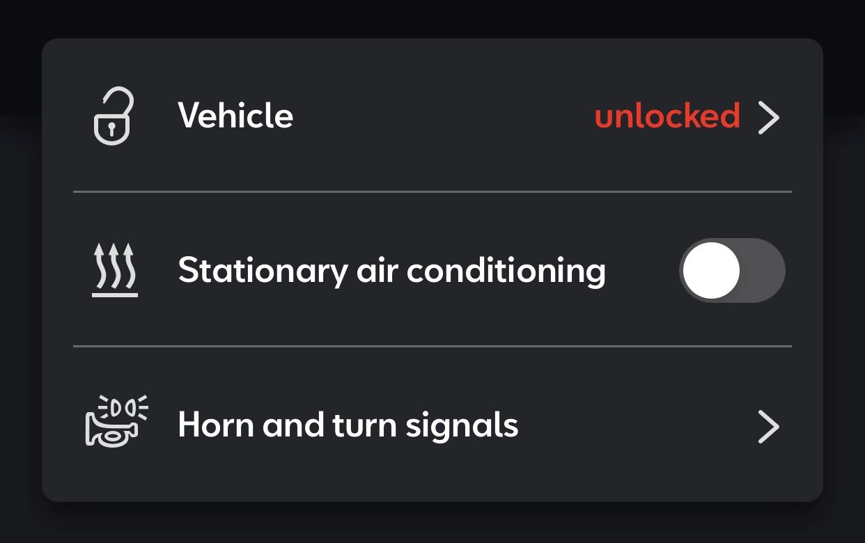

Regarding the application. eTSI motors only equipped with additional heating (webasto) have a heating/ventilation option in the application. Yes, I know, the information brochures say that this is an option available on all engines, but apparently they forgot to write that it requires webasto.
Don't look at the description, the option is wrongly named. Only PHEV has the option of parking air conditioning, for me it activates parking heating when it is cold or ventilation when it is warm outside.
