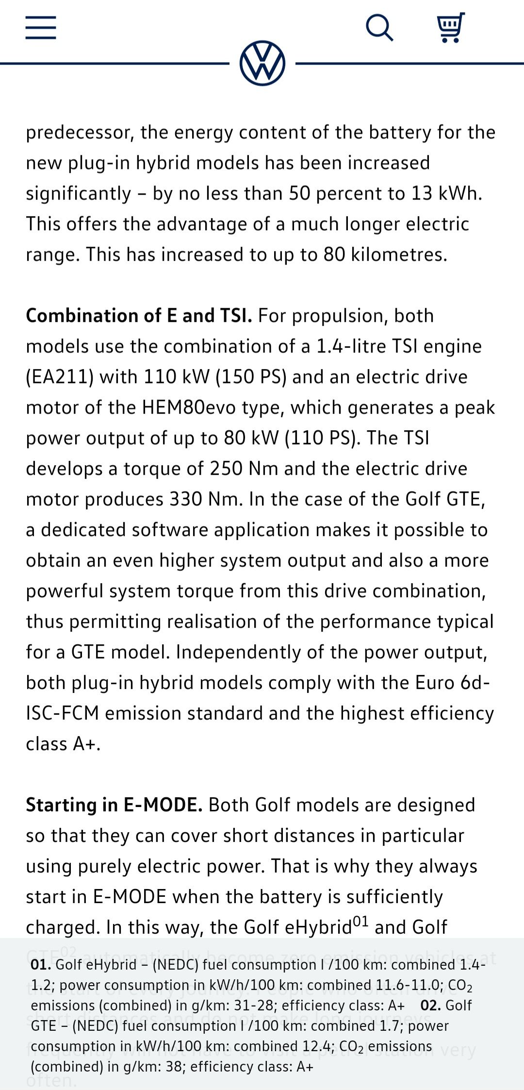

I'm also looking into this. And here is the official confirmation from VW that it's just a "dedicated software application", no extra hardware:

Just be aware if you do this via a remap you will have to have your ecu physically removed from your car and have the ecu mapped via bench / boot as the ecu in the mk4 leon / non gti / r mk8 golf has not yet been unlocked for obd tuning, and the ecu is riveted in place so their will be an amount of drilling / cutting required.
