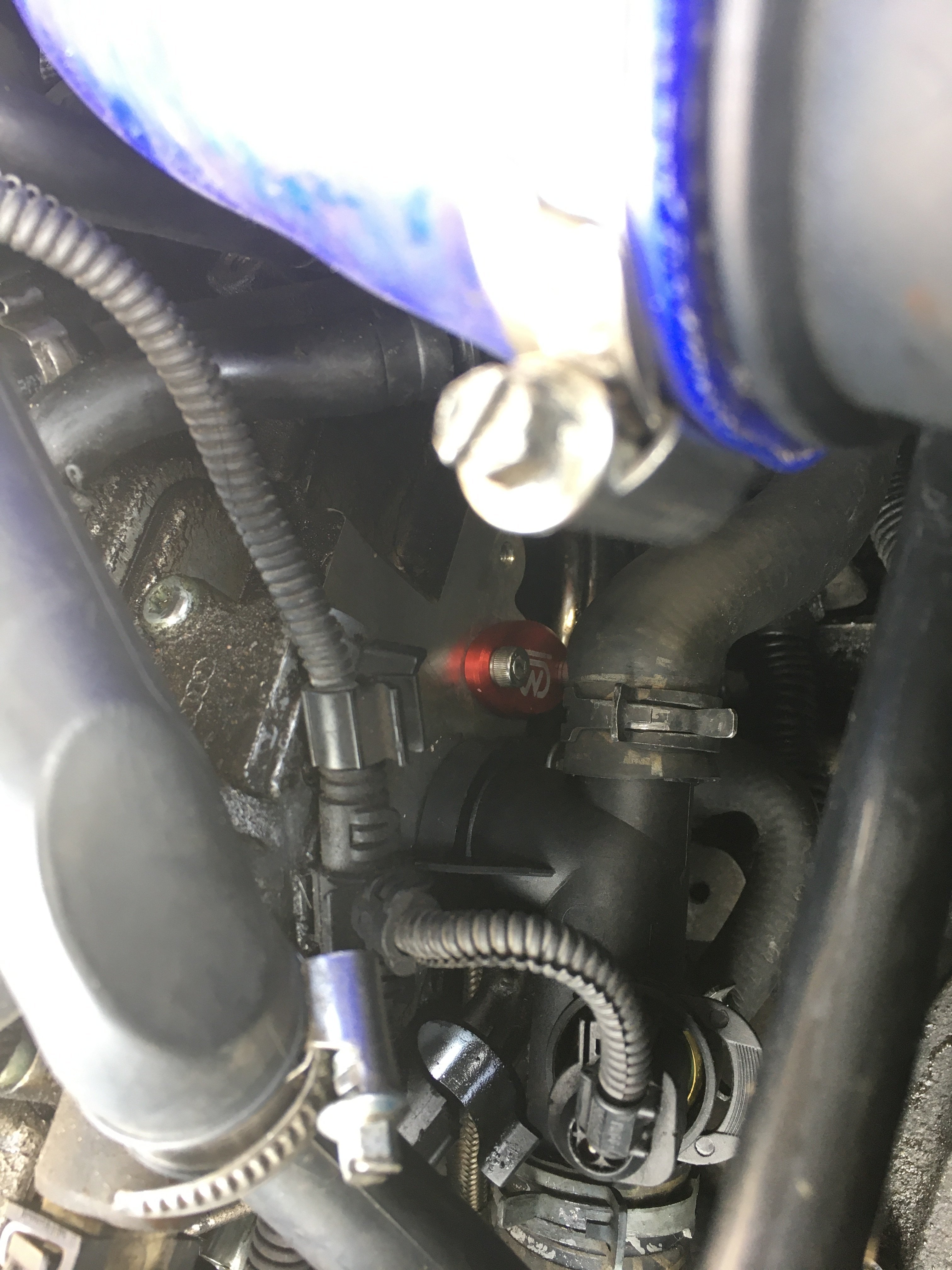

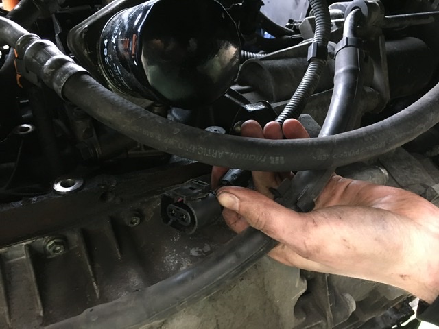

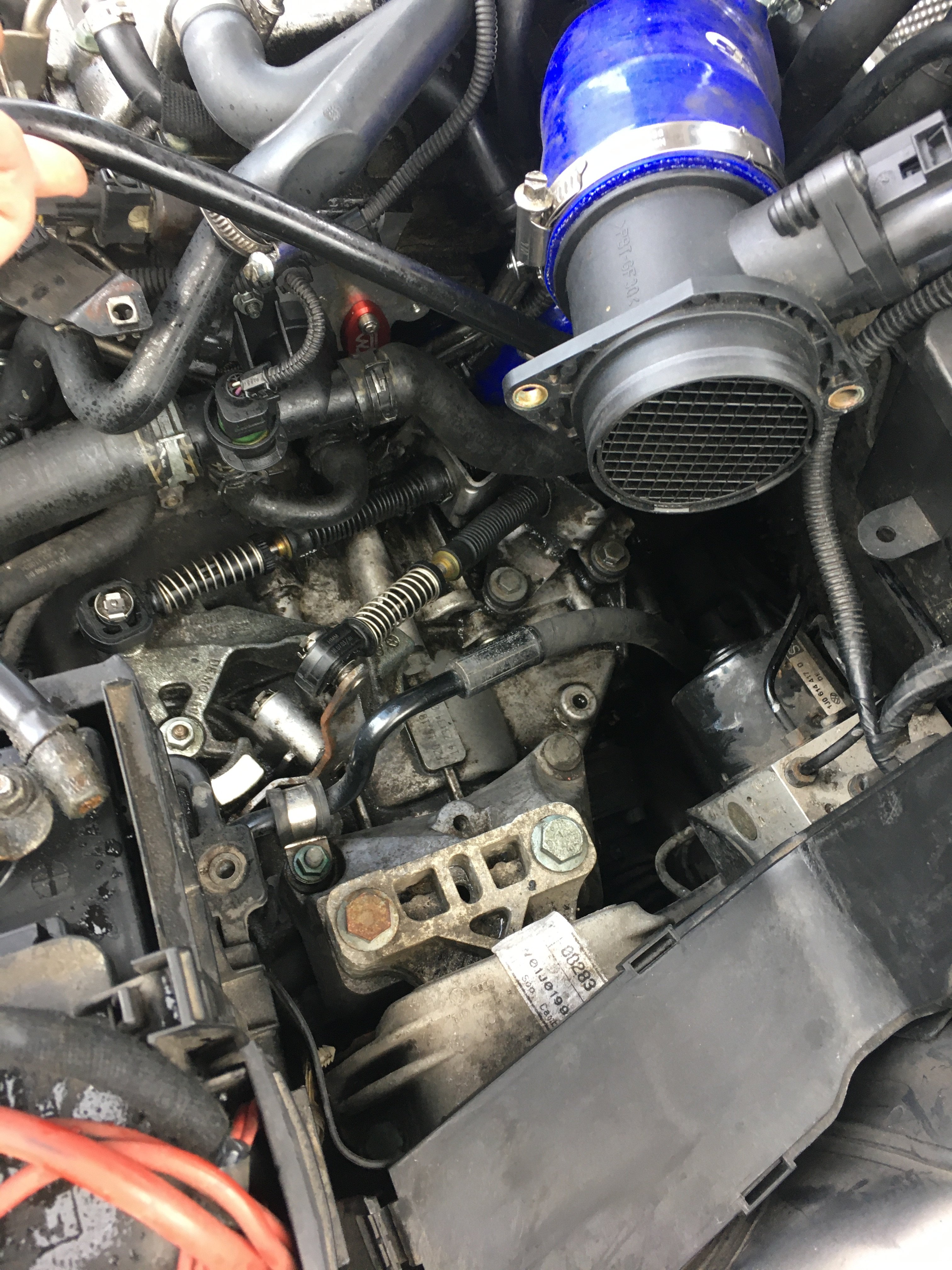

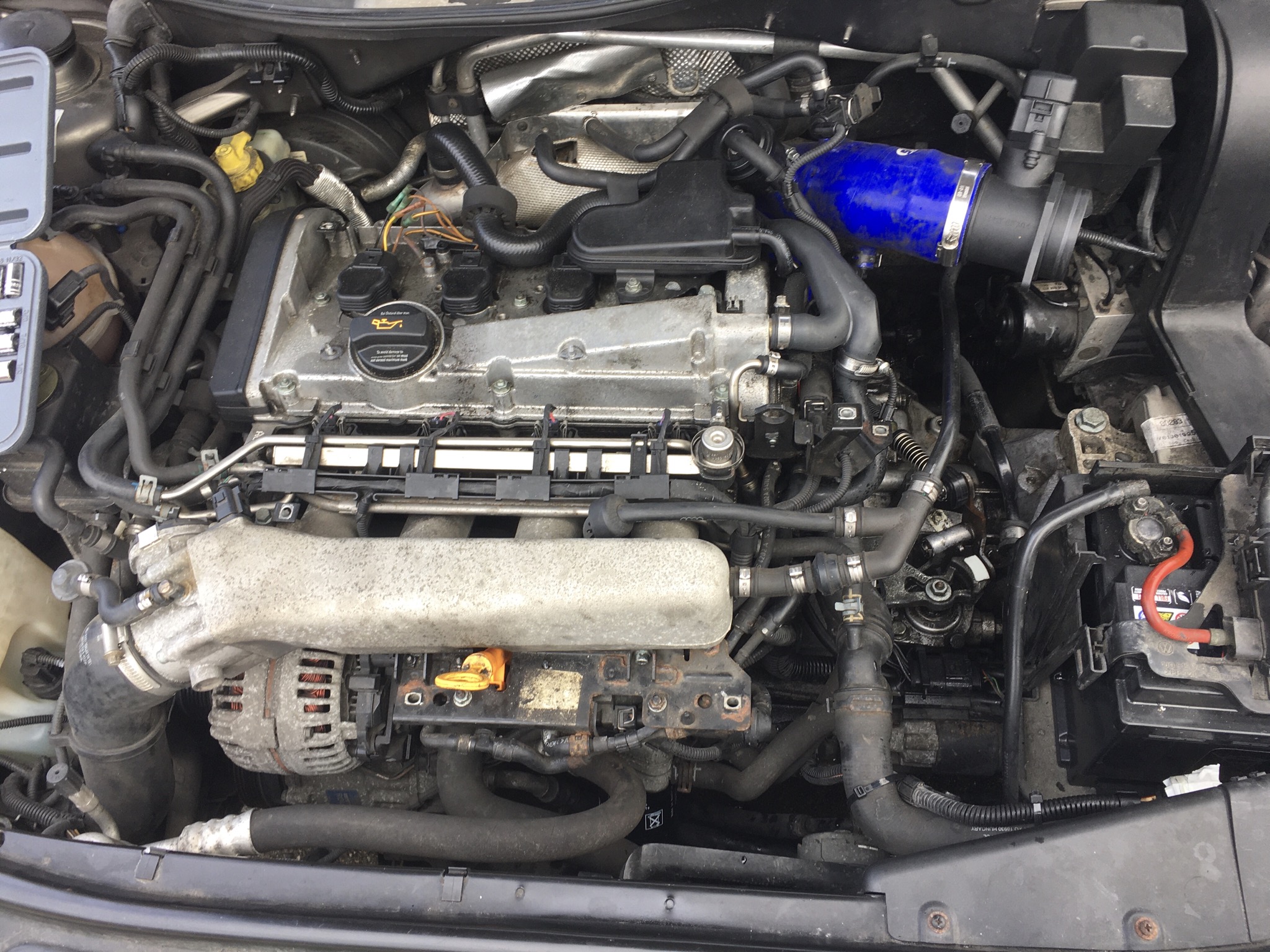

Well today i finished the job. Ended up buying a mk4 golf water flange, and a random Febi o ring from euro car part. With the aim of switching the o rings over from the new flange to the old one.
well the old flange was different internally to the golf one, plus the golf one doesn’t have an elbow in it so I feared the worst.
None of the o rings worked but we fit the golf coolant flange as now the combi valve is removed the elbow in the pipe wasn’t needed. What luck! Thanks to those that helped. Here’s some pics after I cleaned the centimetre of grime and gunk our from around the gear linkage.
