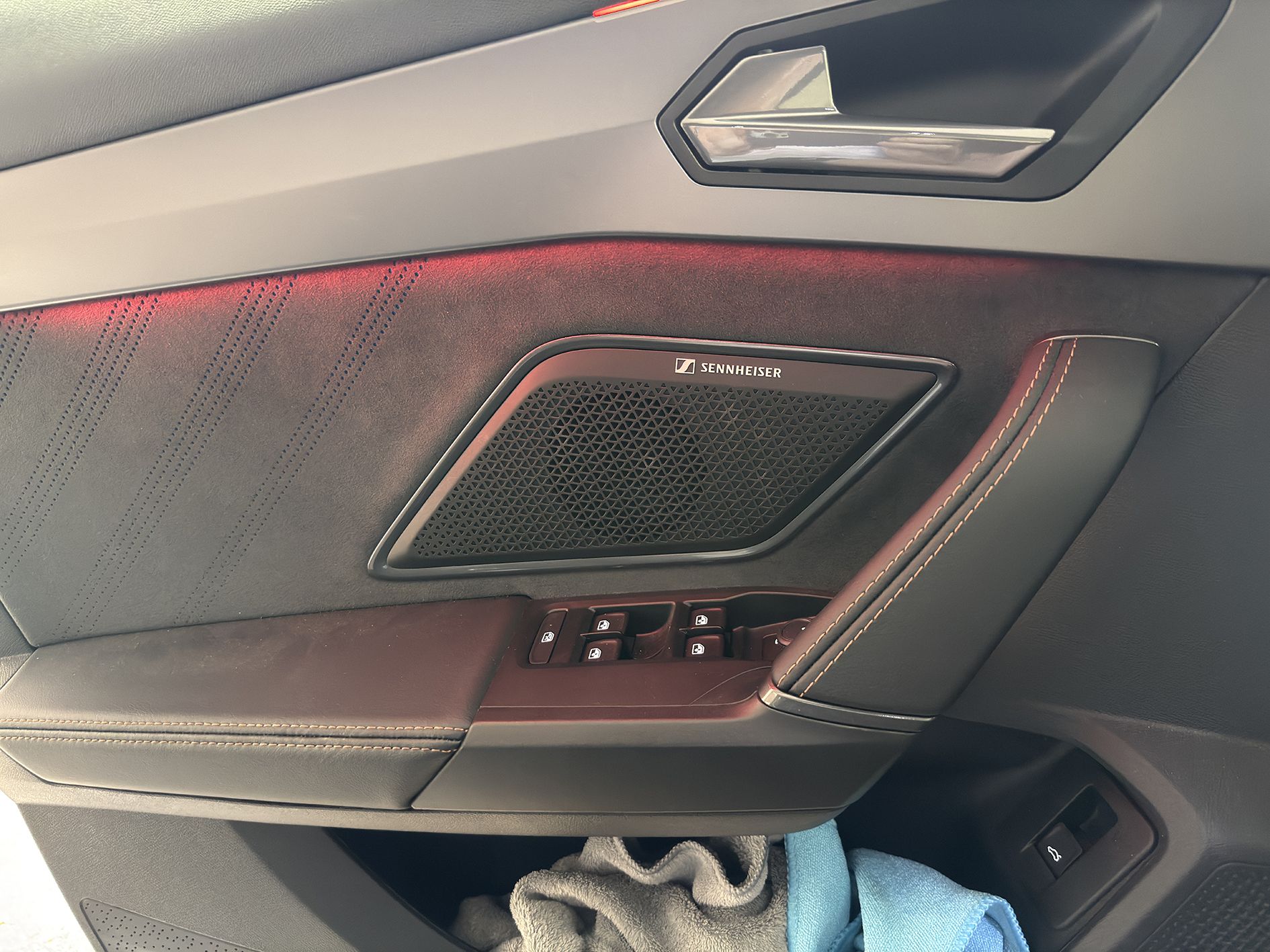

Original "premium" Sennheiser sounds like a Chinese rattle

three-layer sound insulation of all doors

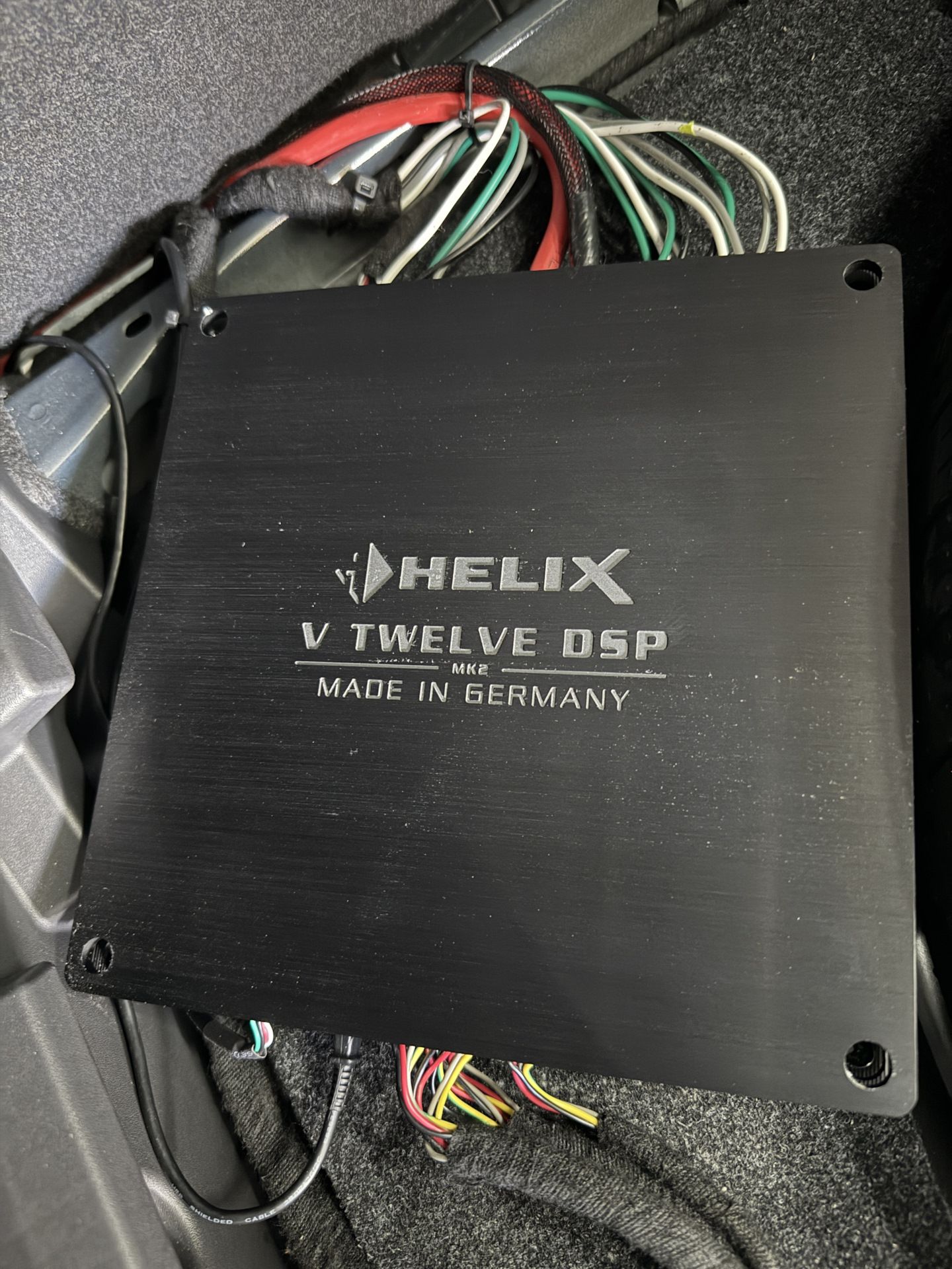

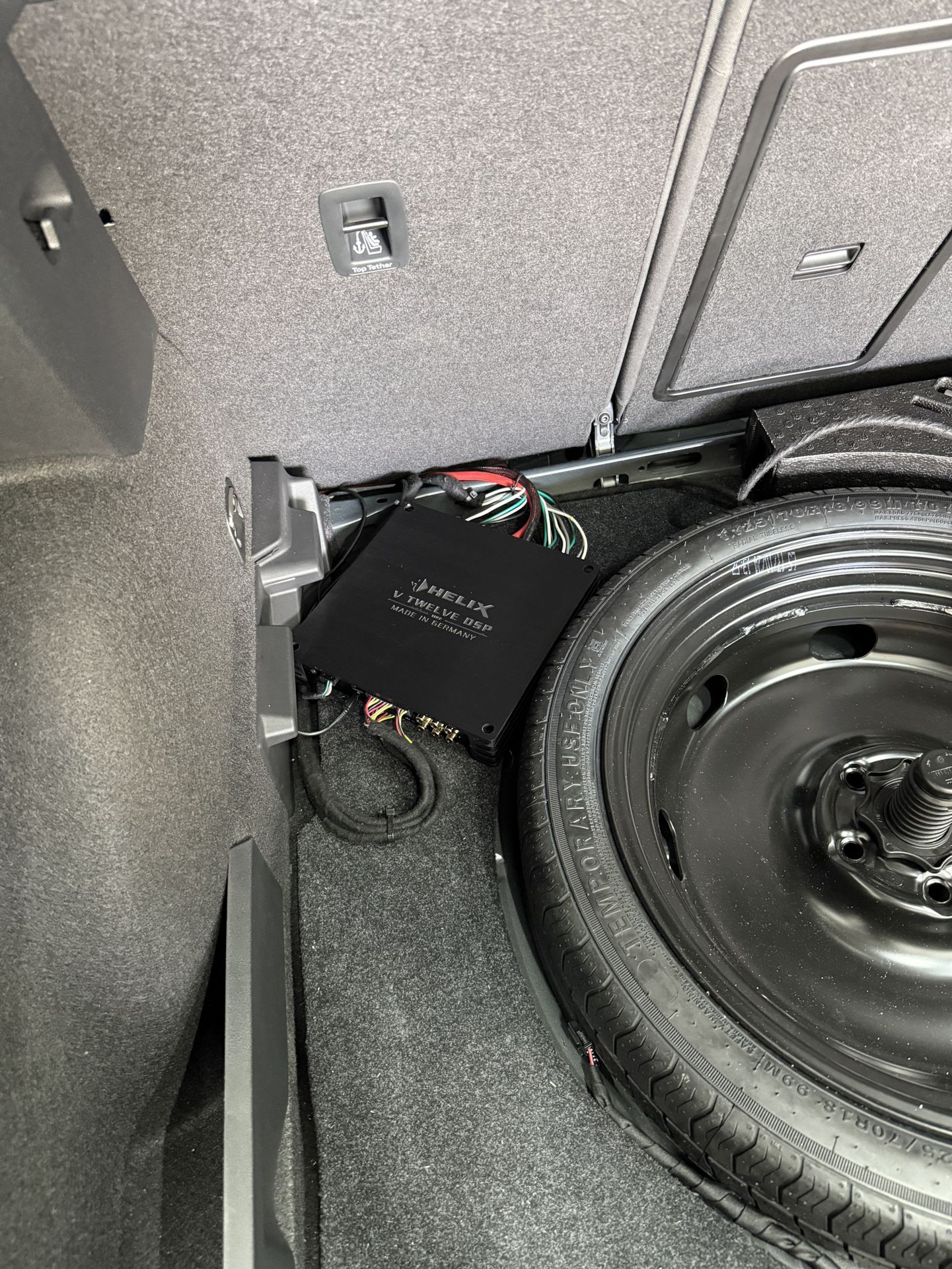

amplifier/audio processor 12 channels - HELIX V TWELVE DSP MK2

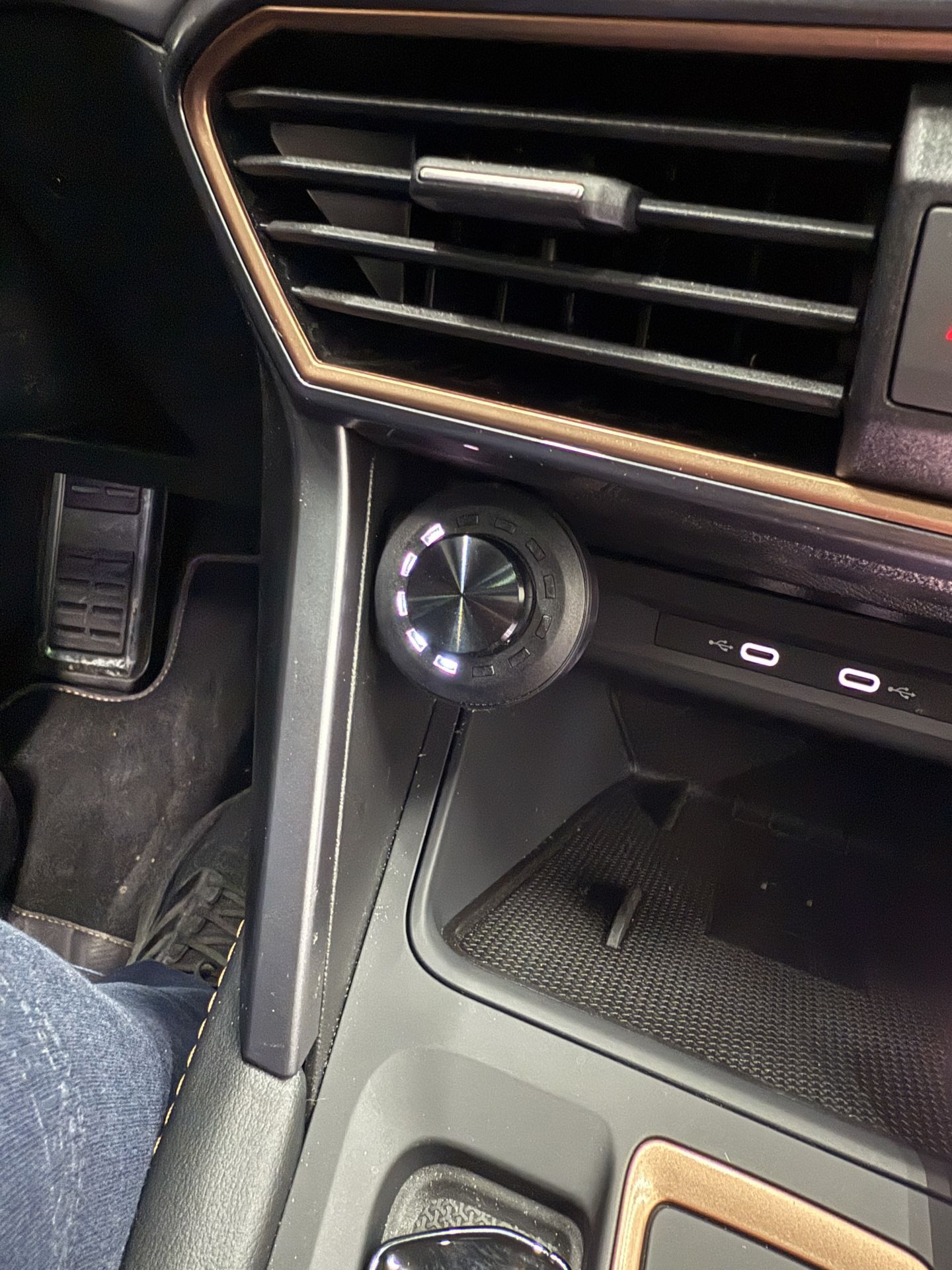

to adjust volume, subwoofer level and frequencies - Audiotec Fisher conductor

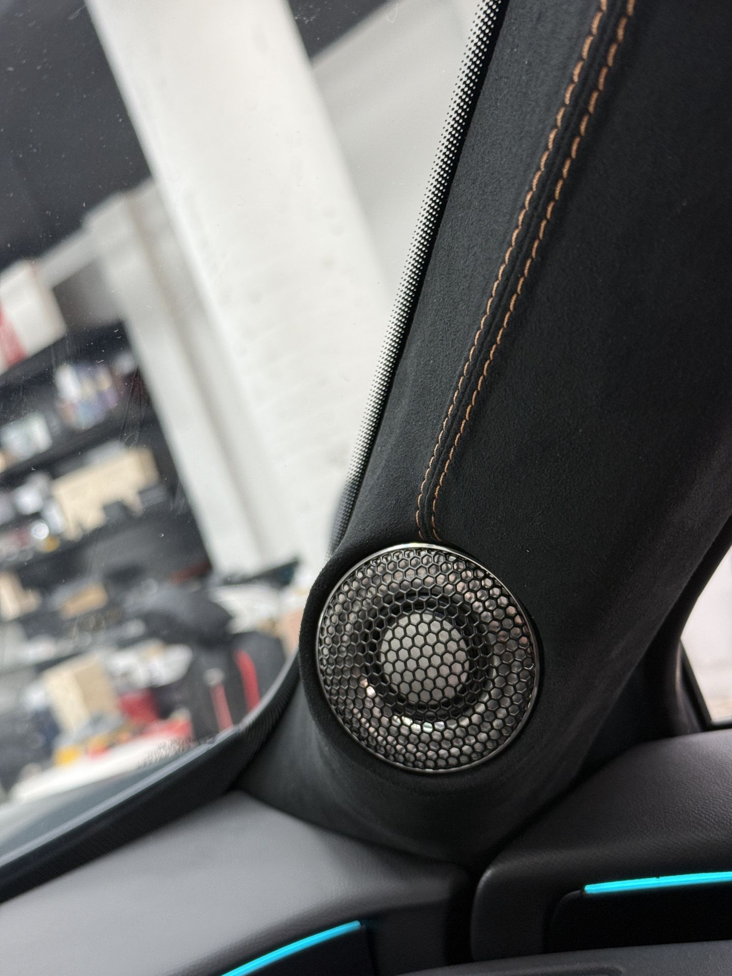

customization of the front pillars so that tweeters would fit in and look at the listener

Possible only play music well via a wire directly to the audio processor. Via CarPlay through original head, the sound is terrible. It has its own audio settings and it is very difficult to change them.
But all control of tracks and pictures is of course through Carplay

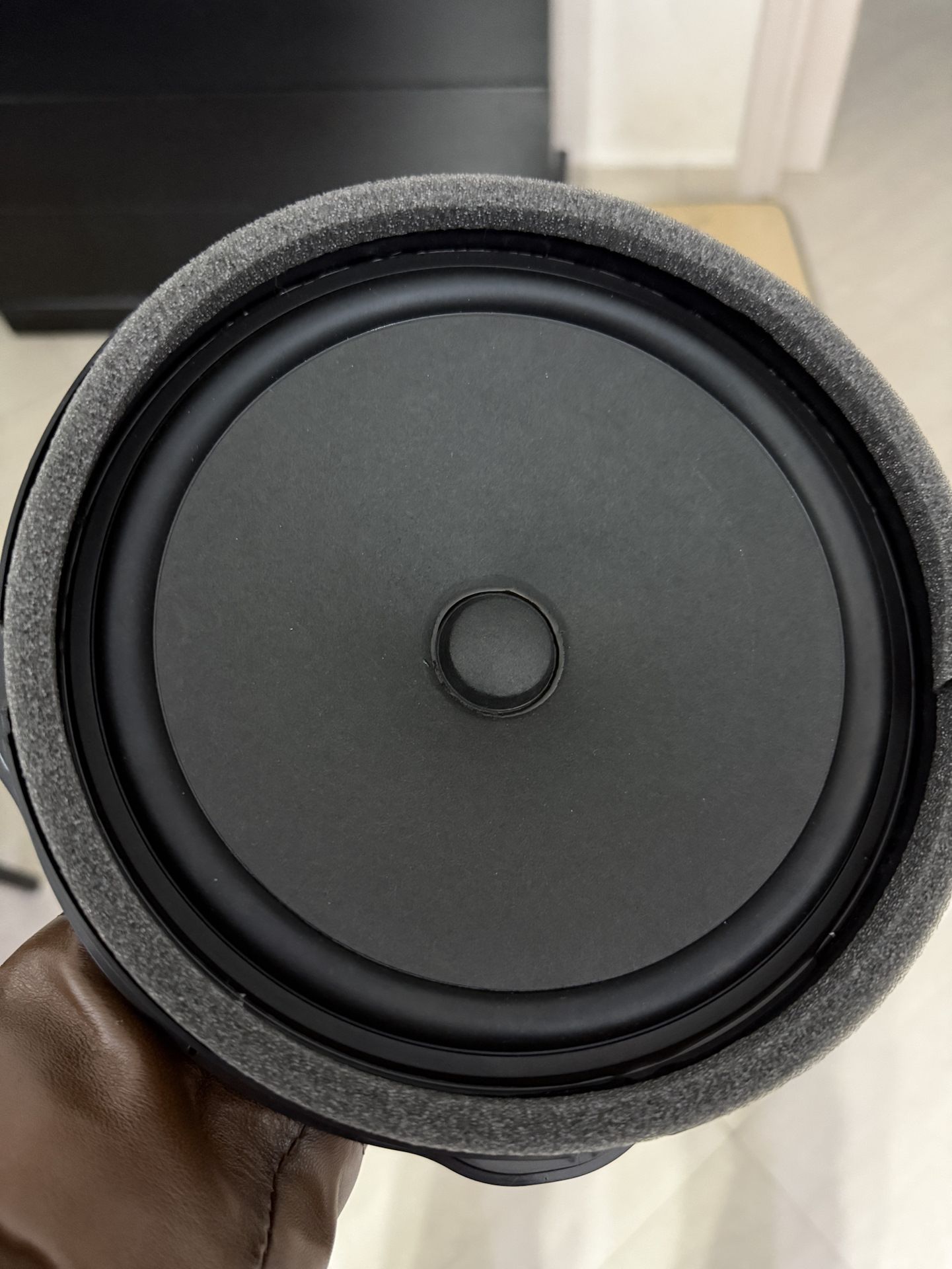

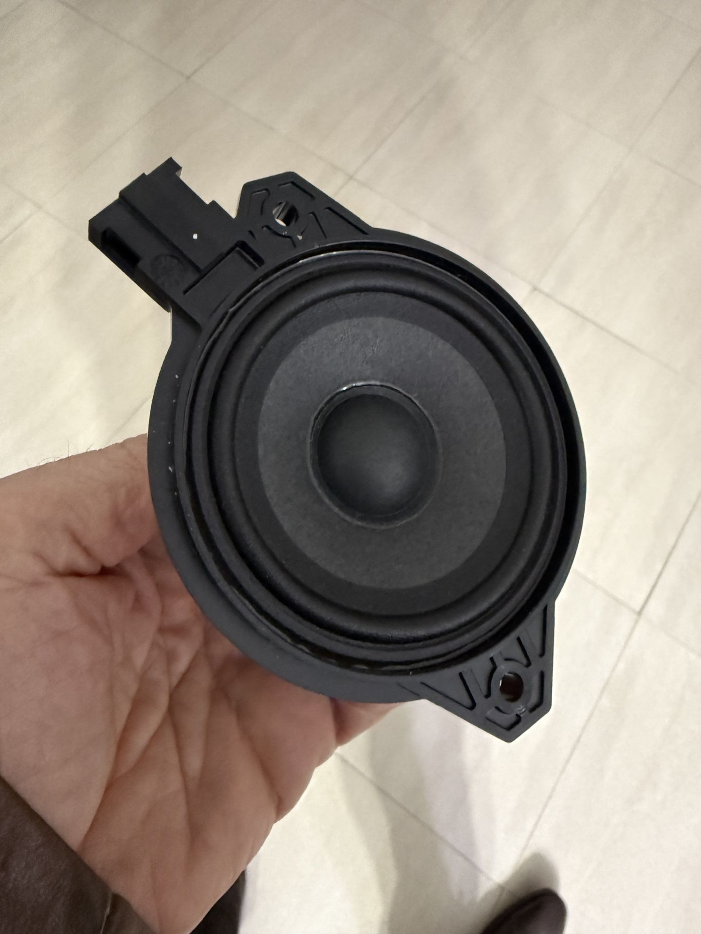

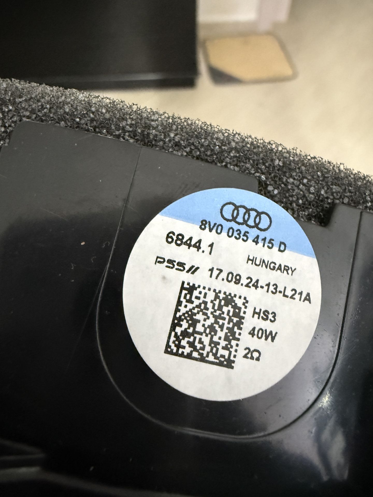

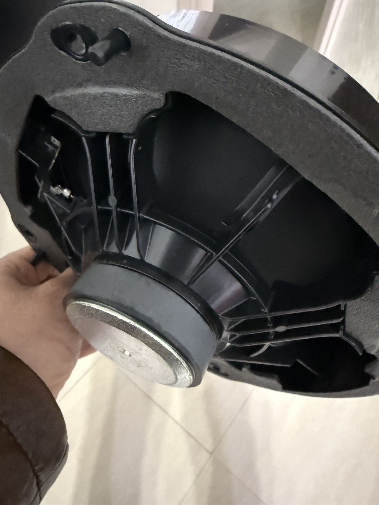

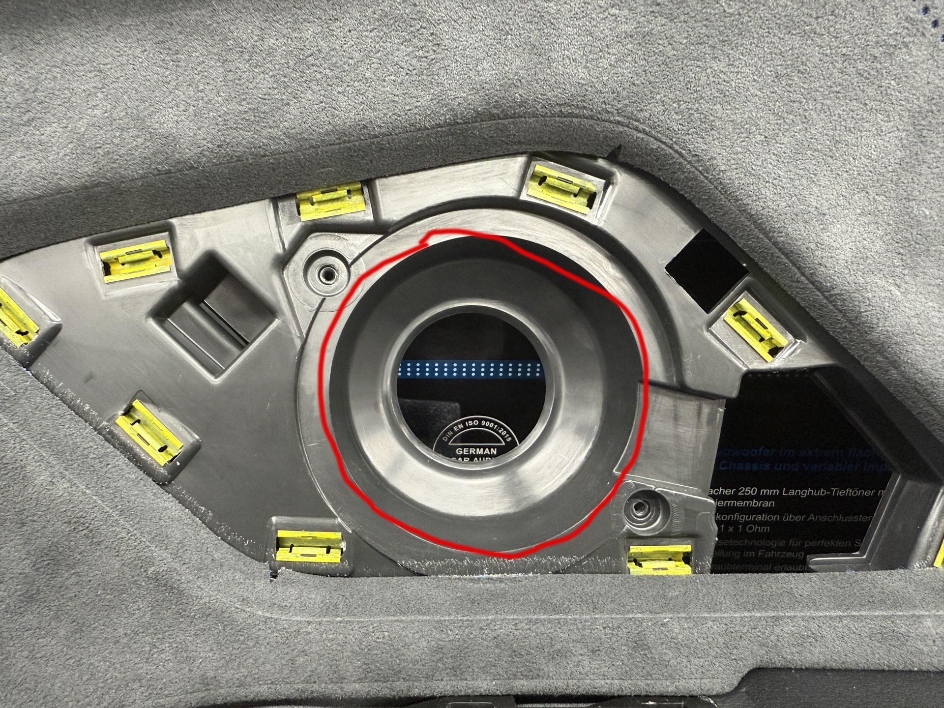

I don't have any photos of the installation process at this point, but this is the model on the picture

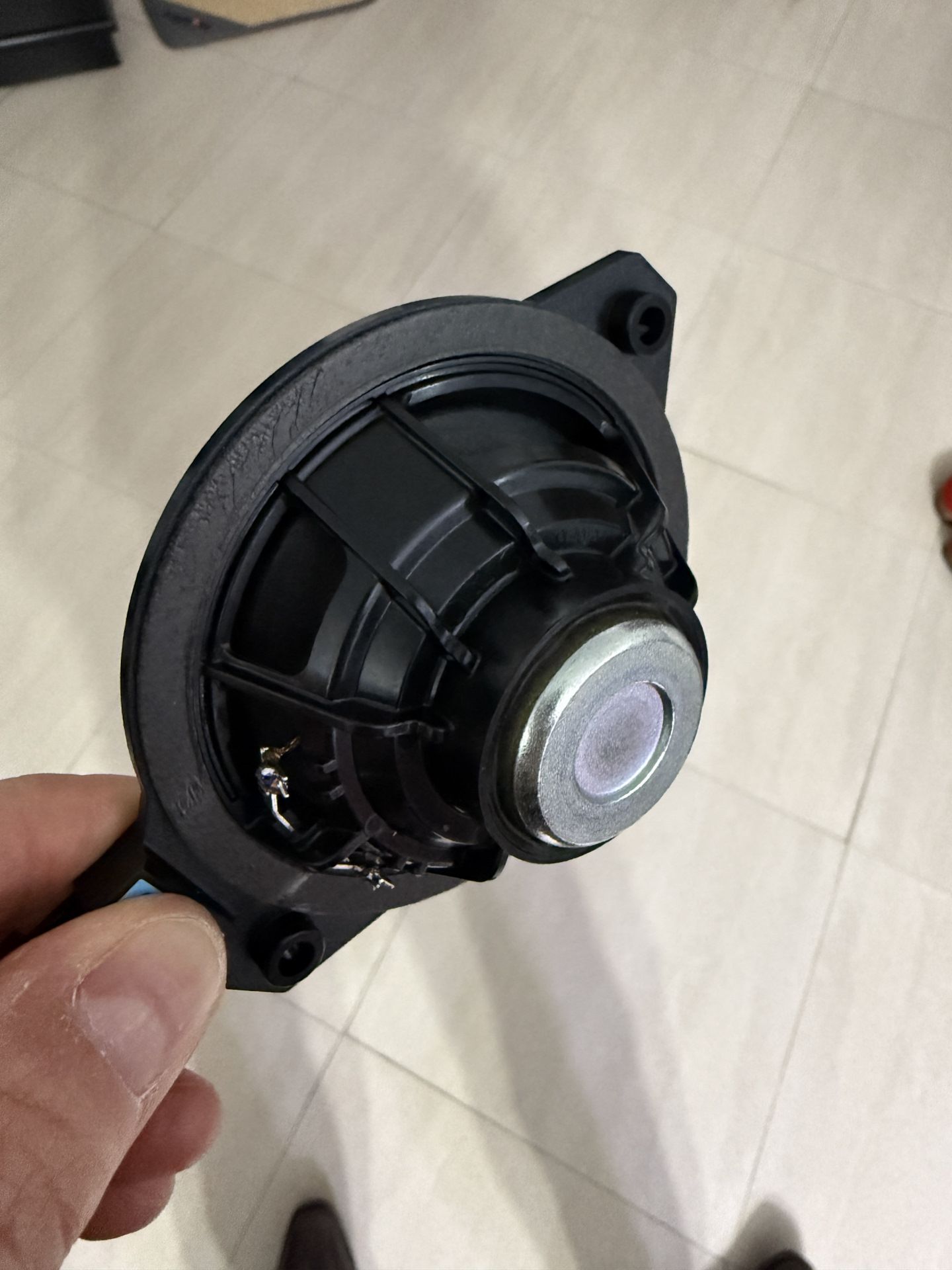

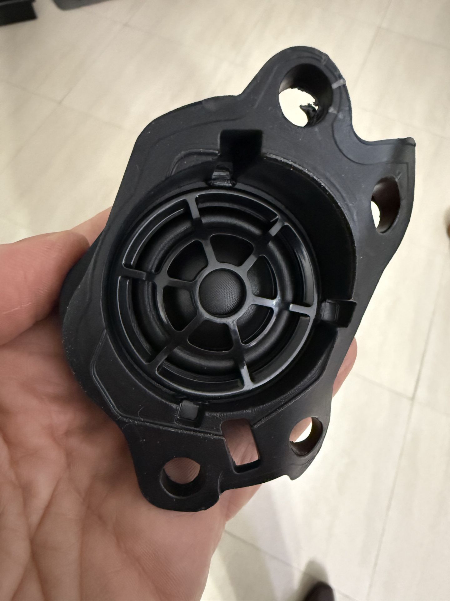

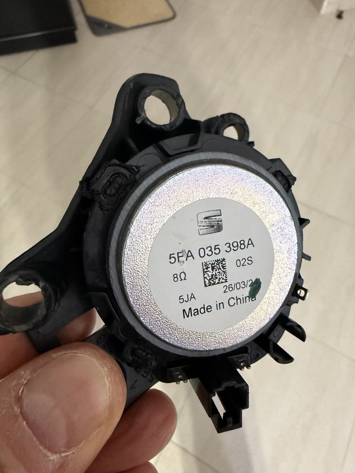

I had to cut out the back wall of the glass from the original midrange speaker because in the original it was probably necessary that it would not play in the door, in my case it was just the opposite. But there are photos of funny speakers that were pulled out from there, they are not premium, they are really funny
this is twitter

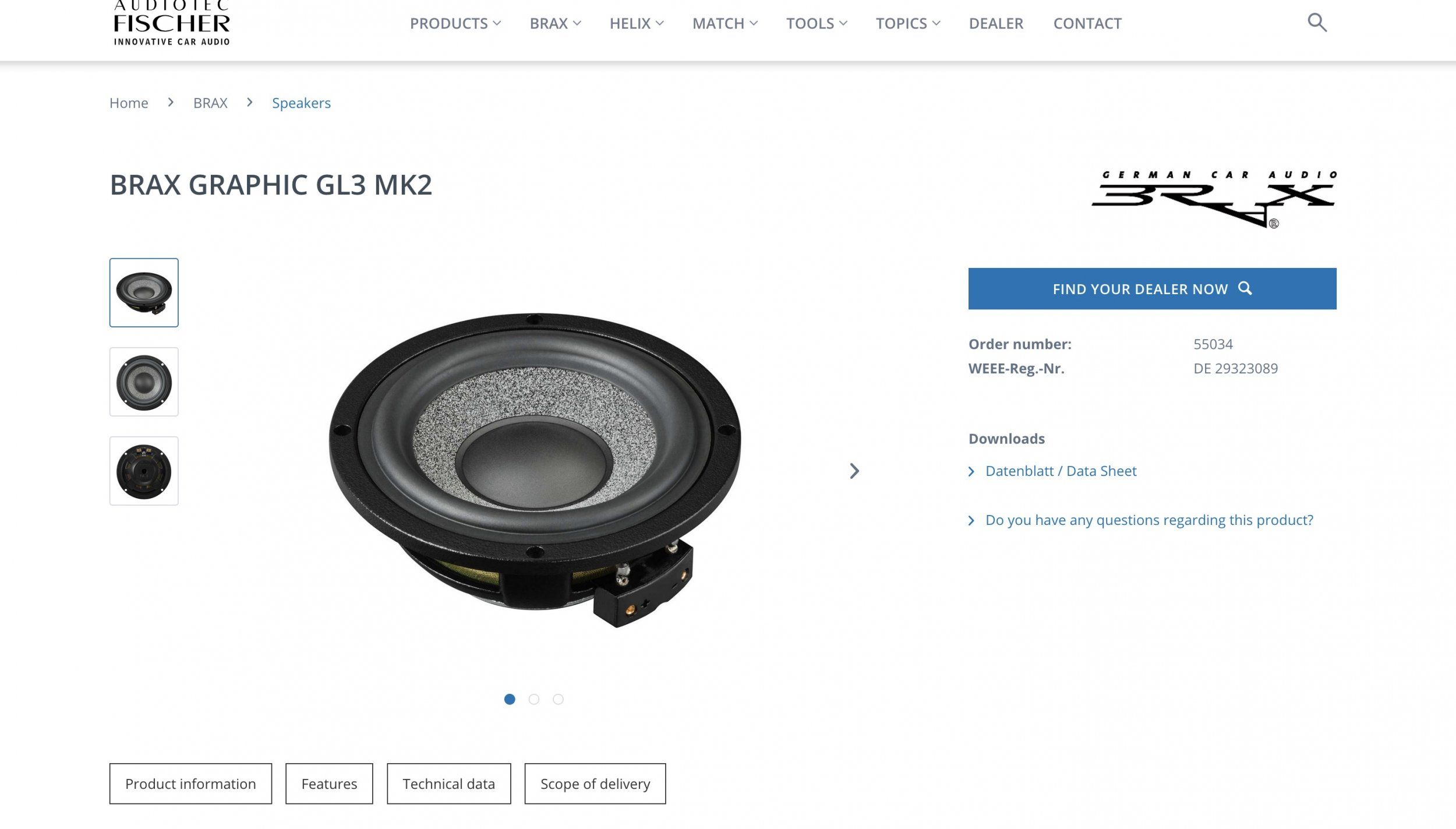

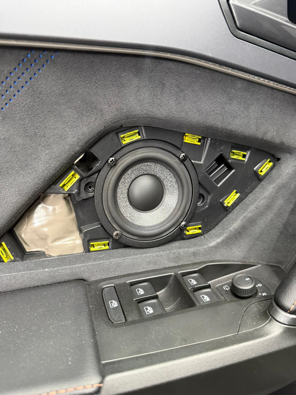

this is midrange
this is midbass

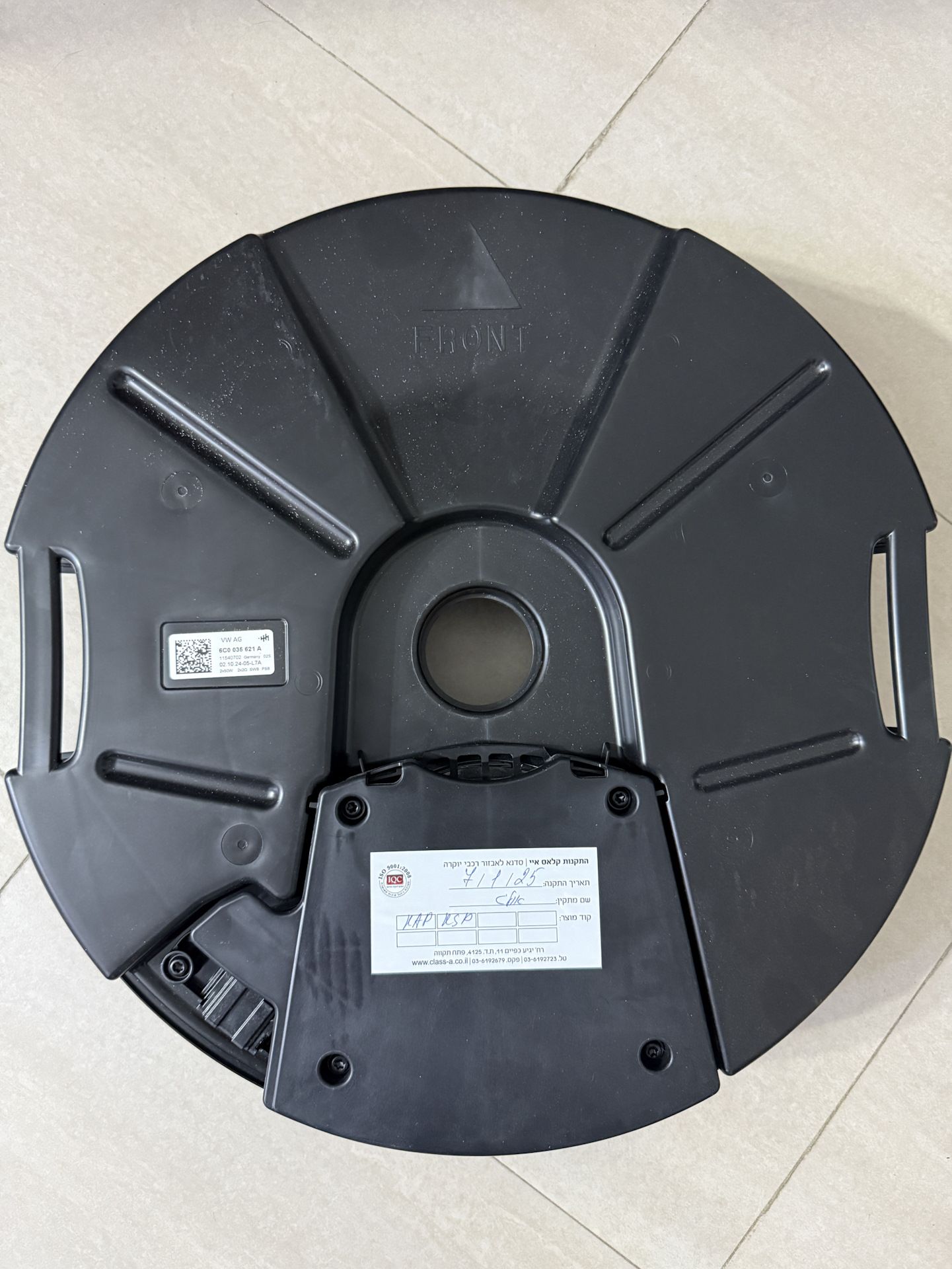

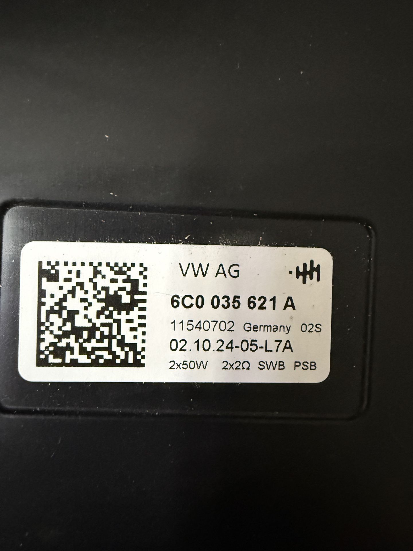

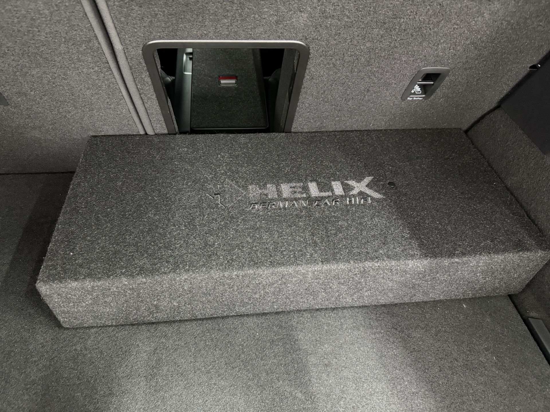

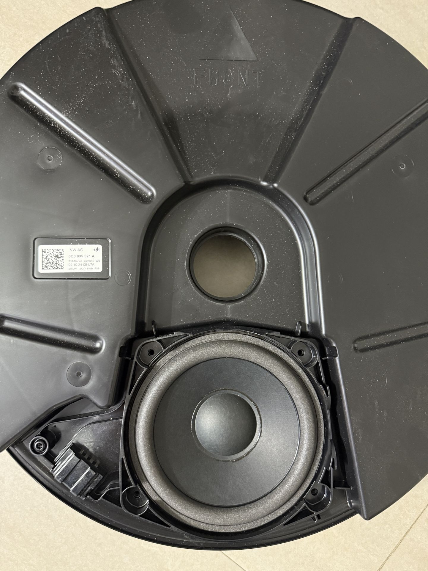

and the sub
this had to be cut because the midrange didn't fit

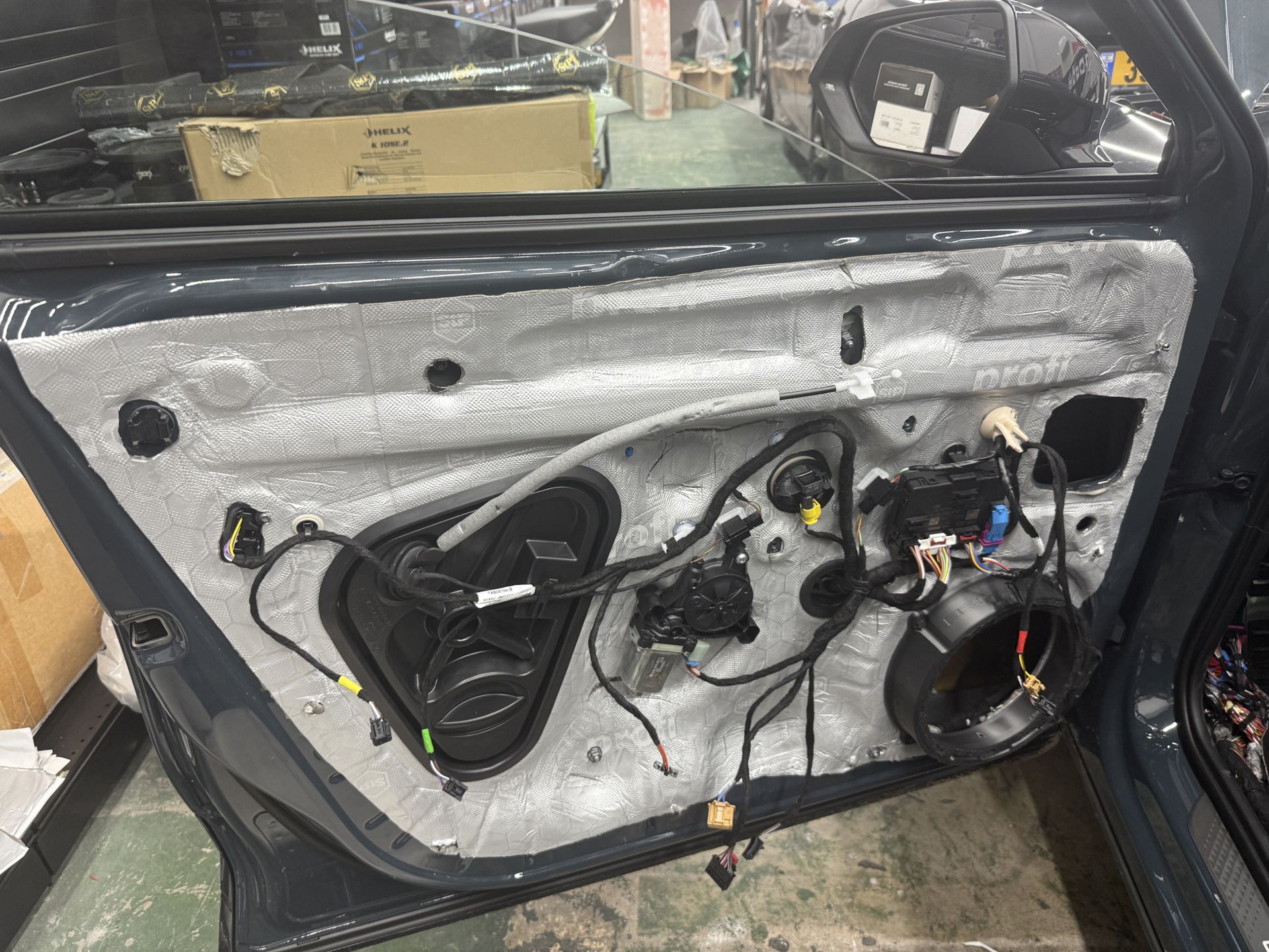

a little bit of the soundproofing process
video of ready new stands for tweeters because they are big plus they should look at the listener and not at each other
this is new midrange
