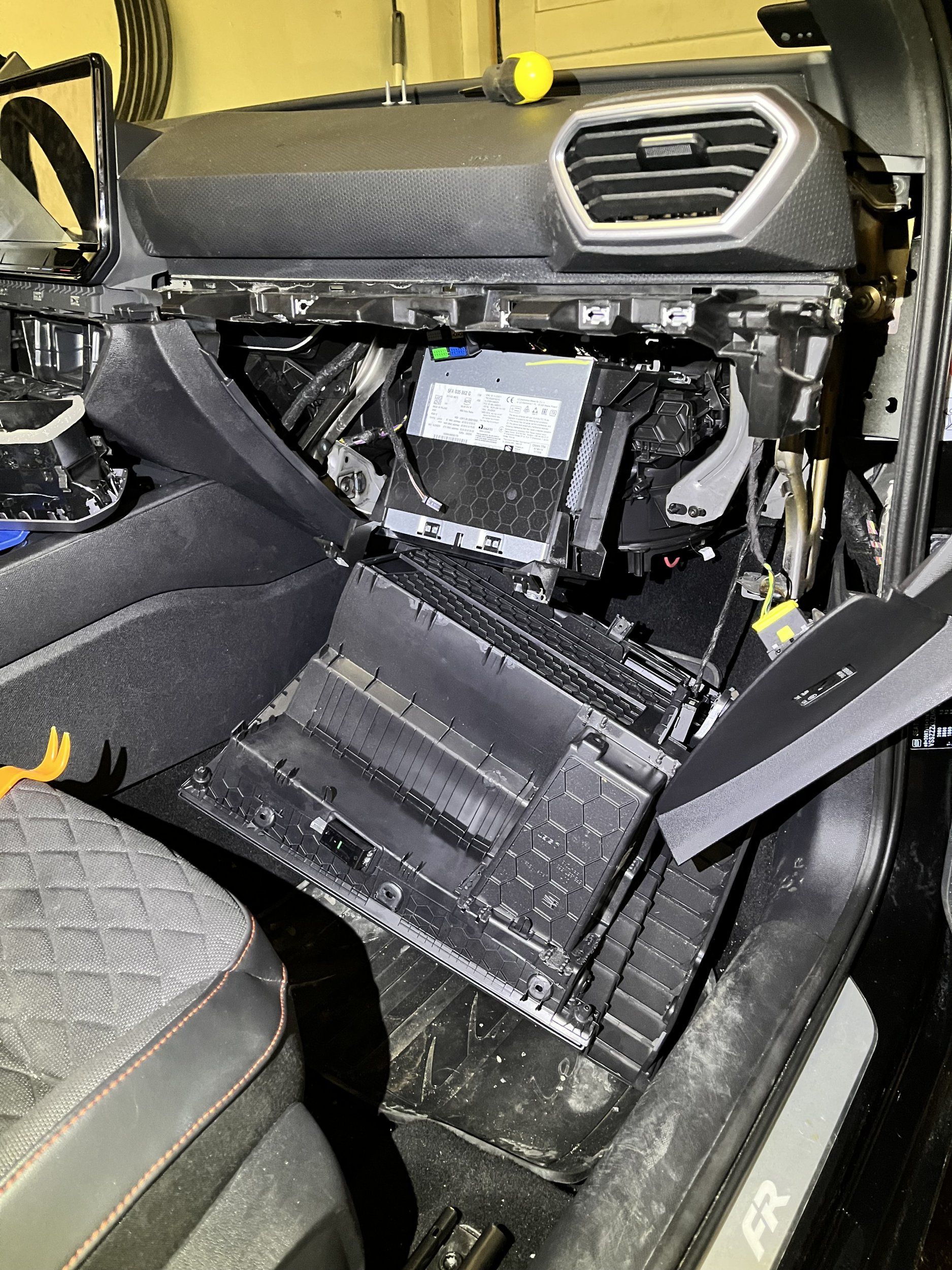

I just installed the amplifier. Took 2 hours. Needed to remove the glove box to get my hands on the MIB3 system. Amp came with plug and play harness, so connecting is was very easy. Hardest part was getting the long silver plastic trim back on, as i removed it all. Easier would be just letting it hang in there like in some YouTube videos.

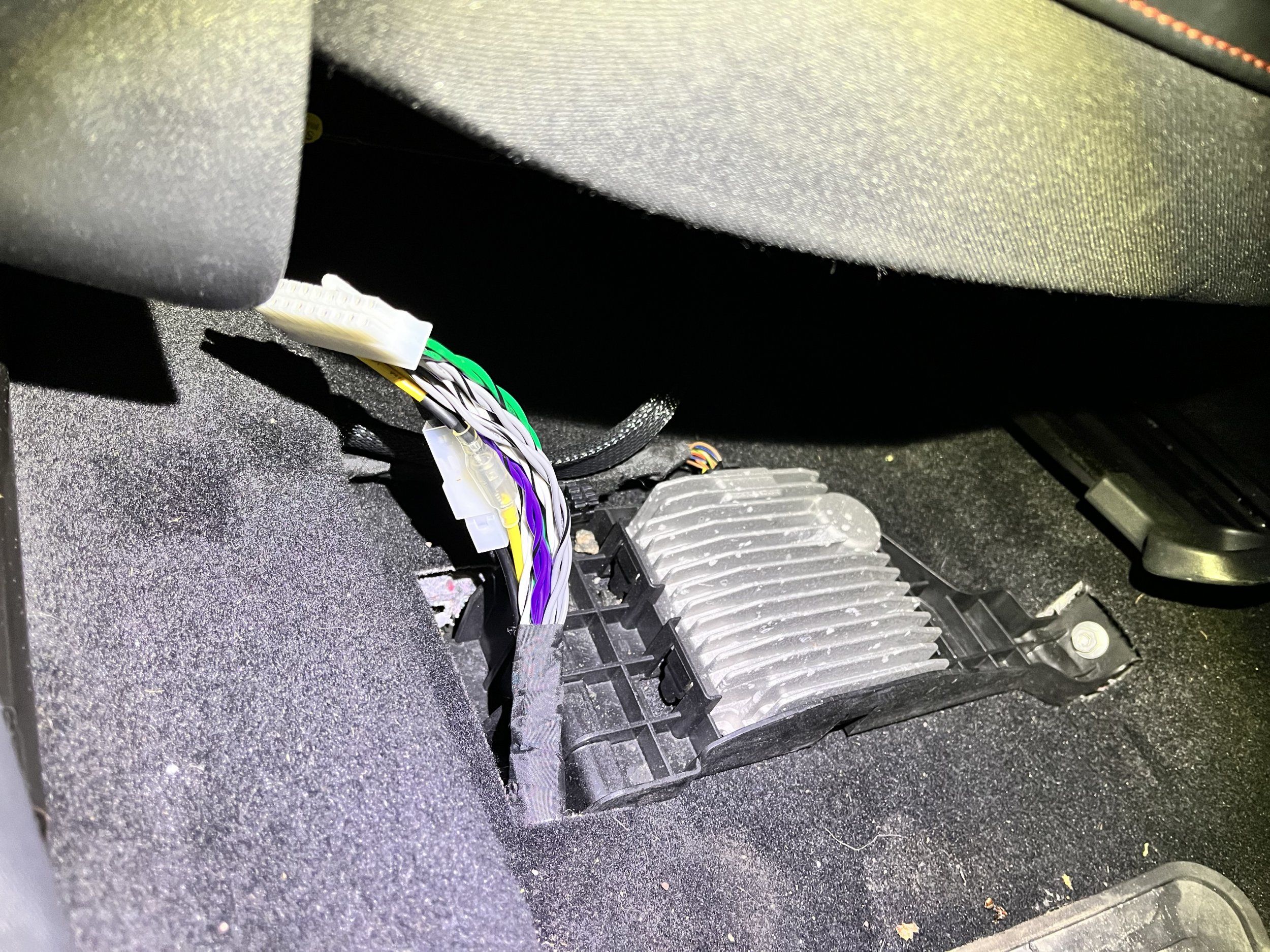

Took the wire harness under the passenger seat (left hand drive here). What is that metal thing under there? Some kind of voltage converter maybe? Is it missing some cover or so?
Still have to build some sturdy case for the amp somewhere there. And still waiting the subwoofer to arrive.

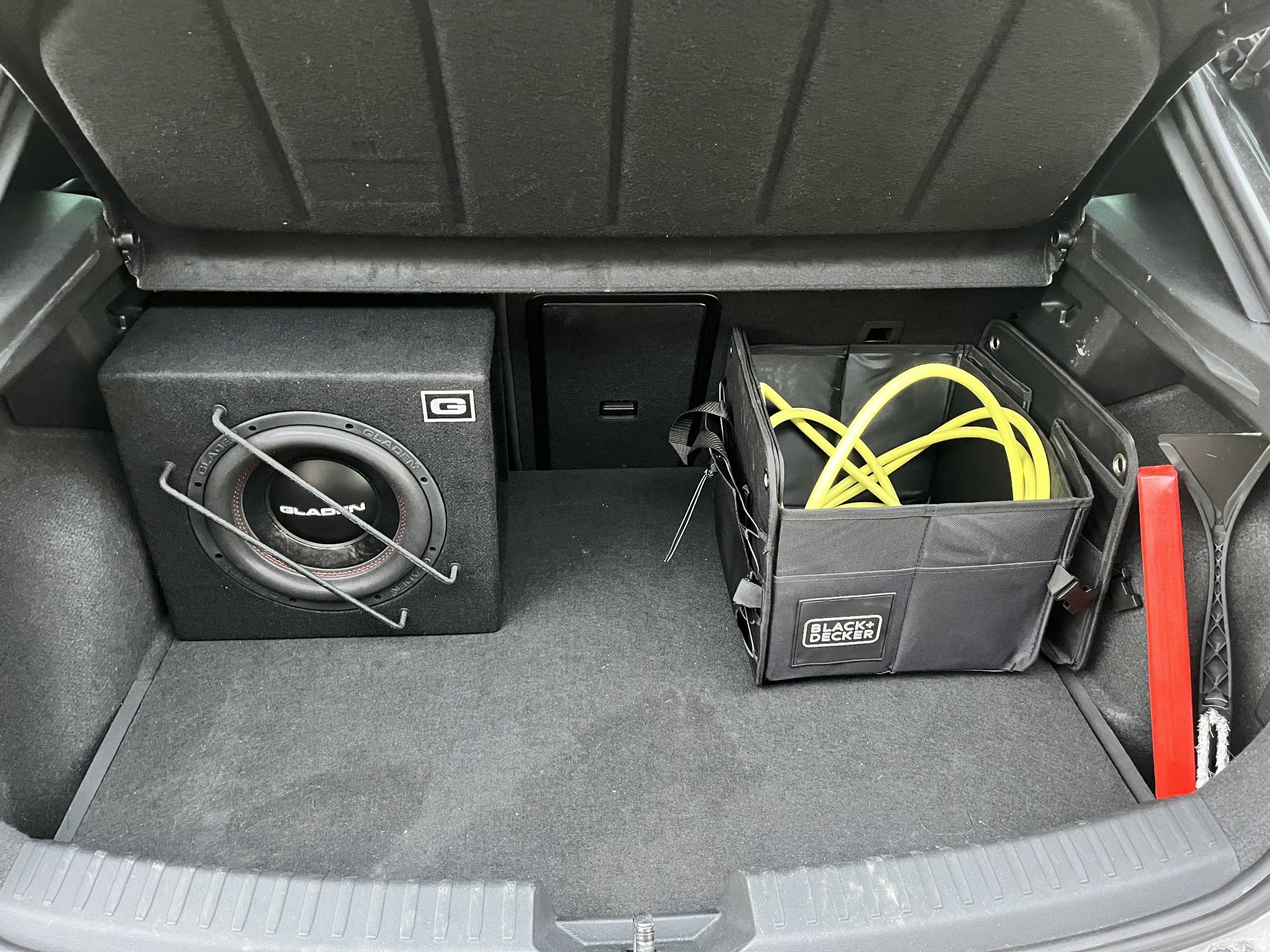

Succesfully installed an subwoofer to my Jayks amplifier. Gladen RSX10SB.
Quite pleased with the sound now. Mids are a bit off but i think putting some insulation to the doors would help a lot with that. That would be the next step, maybe while on it, some new speakers / mids would be easy to be changed at the same time.
