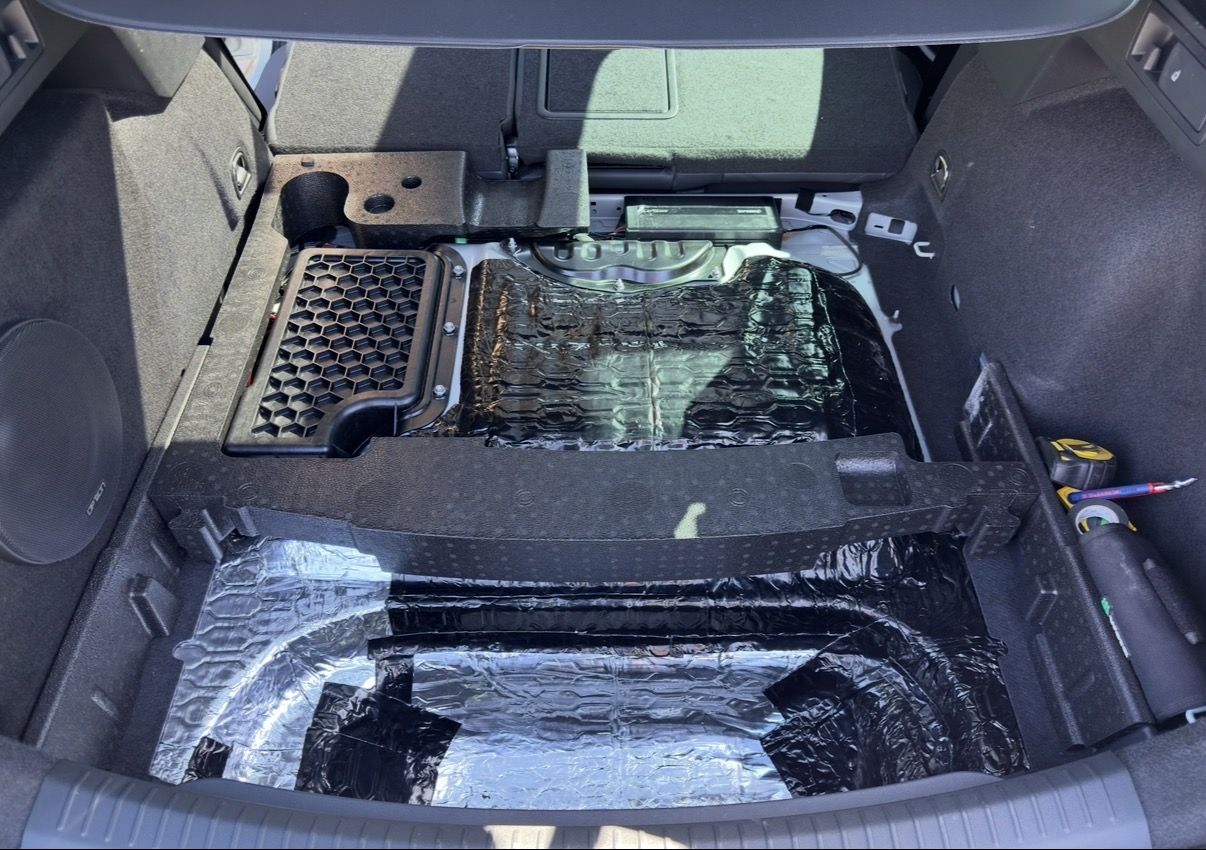

1st Improvement – Subwoofer Upgrade
  • Installed: new enclosure with Option 8-Air D2 subwoofer (210W RMS)
  • The standard L-shaped subwoofer was simply not powerful enough
  • This new enclosure is custom-made for the Cupra Leon Station and fits perfectly on the left side of the trunk
  • Plug & play using the original wiring
Result: Immediate and clear improvement over stock

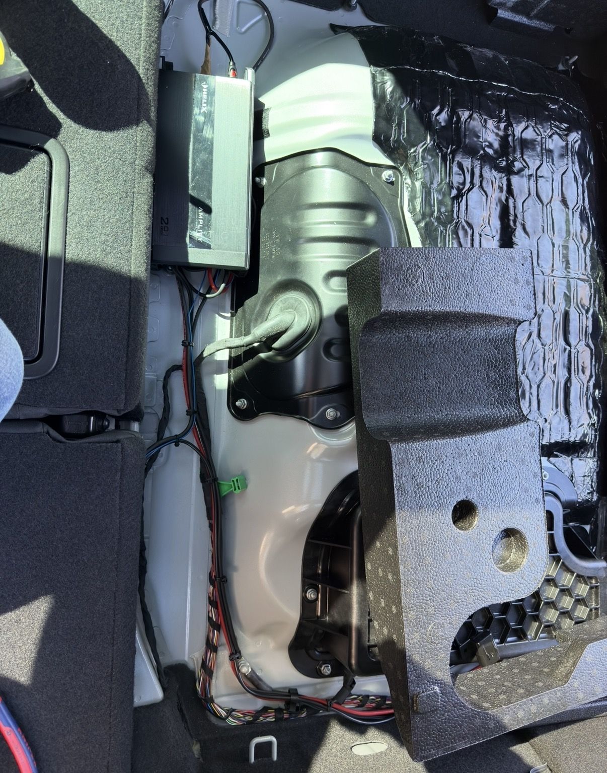

2nd Improvement – Additional Amplifier (Helix)
  • Installed: Helix One Amplify 201 with crossover
This provided approximately 400W of power for the subwoofer
Result: Another significant step forward in output and power

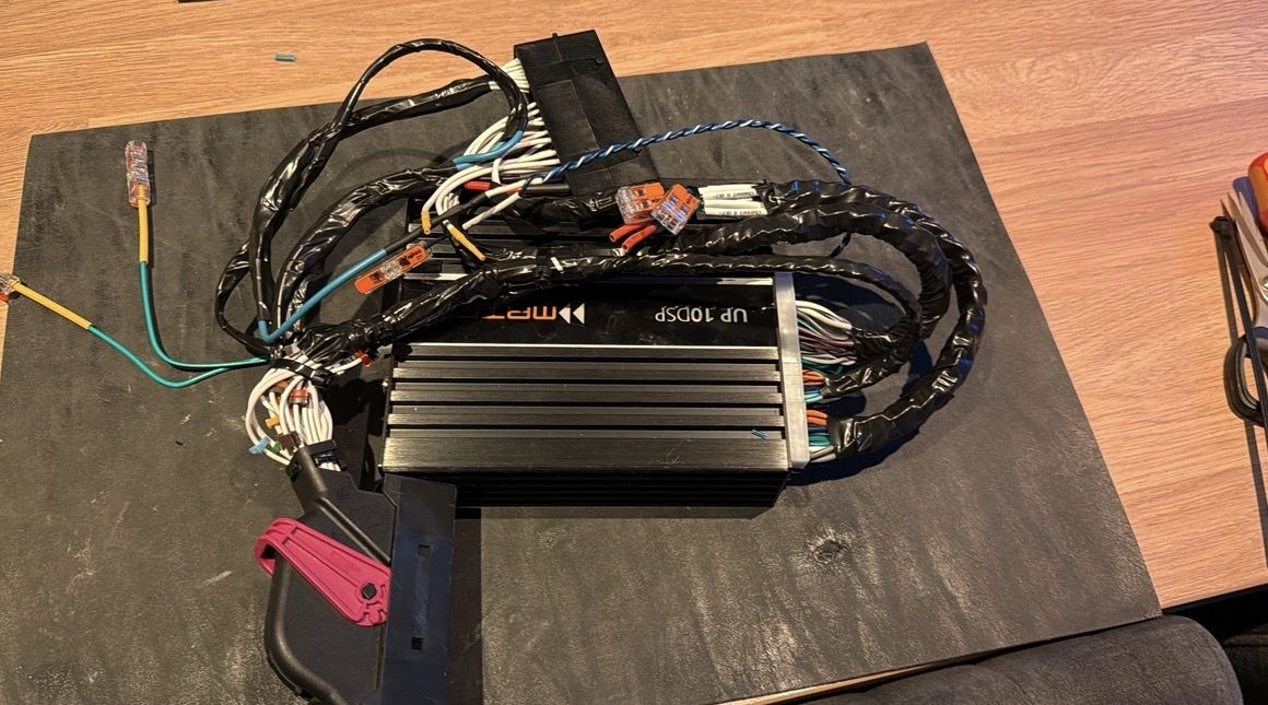

3rd Improvement – MATCH UP10 DSP
  • Installed: Match UP10 DSP (8 inputs / 10 outputs)
Challenge:
No standard wiring harnesses are available yet for this setup
MATCH UP10 DSP (Expansion)
  • The original Panasonic amplifier uses 12 channels
  • Based on advice, I chose the Match UP10, but it only has 8 input channels as standard
  • Therefore expanded with a MEC Analog Input module (+2 inputs)
➡️ Effectively, this becomes a UP10.10 (same device, but normally with the module built in)
Channel Layout
  • Front: 3-way system (High / Mid / Low) → 6 channels
  • Rear: 2-way (left/right bridged) → 2 channels
  • Center speaker → 1 channel
  • Subwoofer (via RCA out) → 1 channel
WIRING – Helix
  • Since the Helix was already installed and provides more power:
    • Controlled via RCA output from the Match DSP
    • Remote signal from DSP (on/off)
    • Power and ground from the rear battery
    • Subwoofer connected via speaker cable

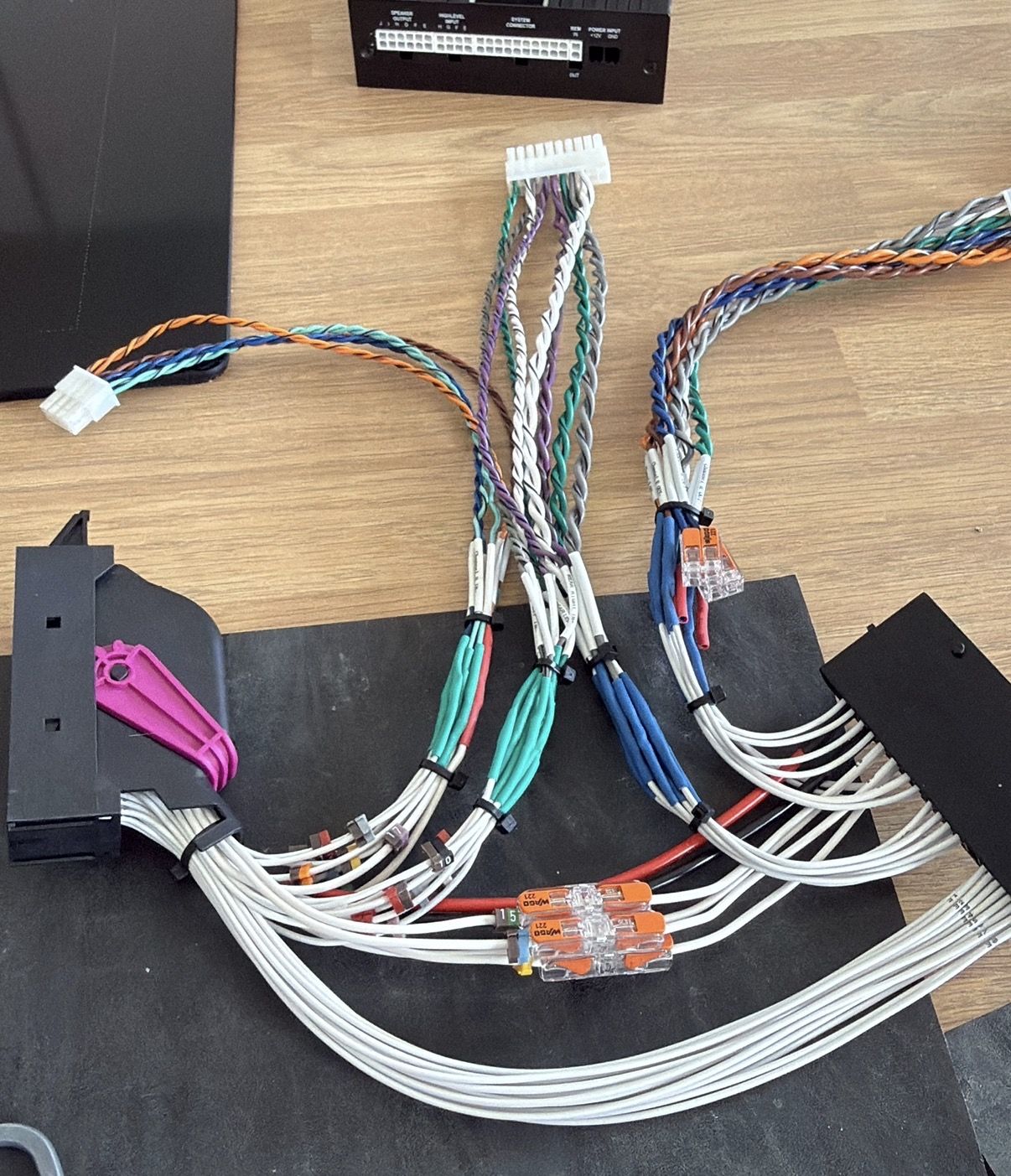

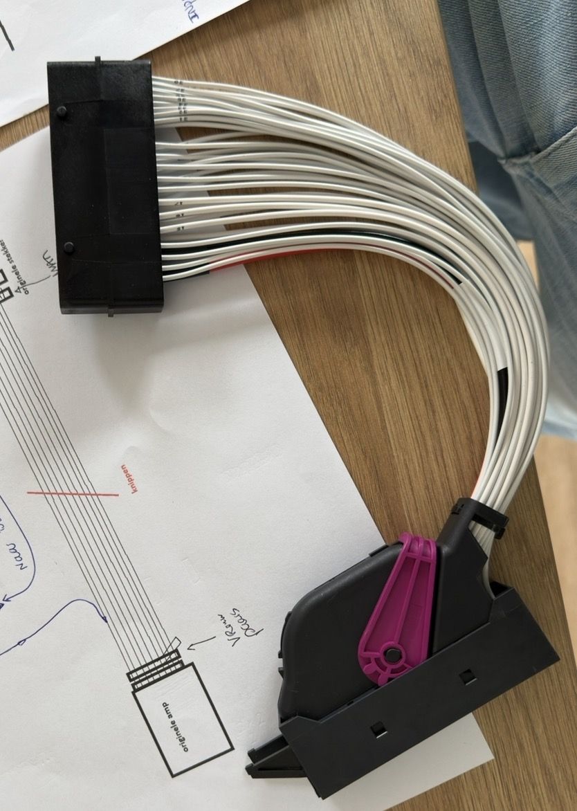

WIRING – MATCH UP10 DSP
  • Ready-made solutions: not available or > €500
  • So I went DIY: ordered a 38-pin Match extension cable and modified/soldered it myself
Additional wiring:
  • 4-pin cable to the center speaker (not amplified as standard)
  • Conductor Pro installed near the phone charger, cable routed to the front via door seals
  • Power: from rear battery, ground to front grounding point

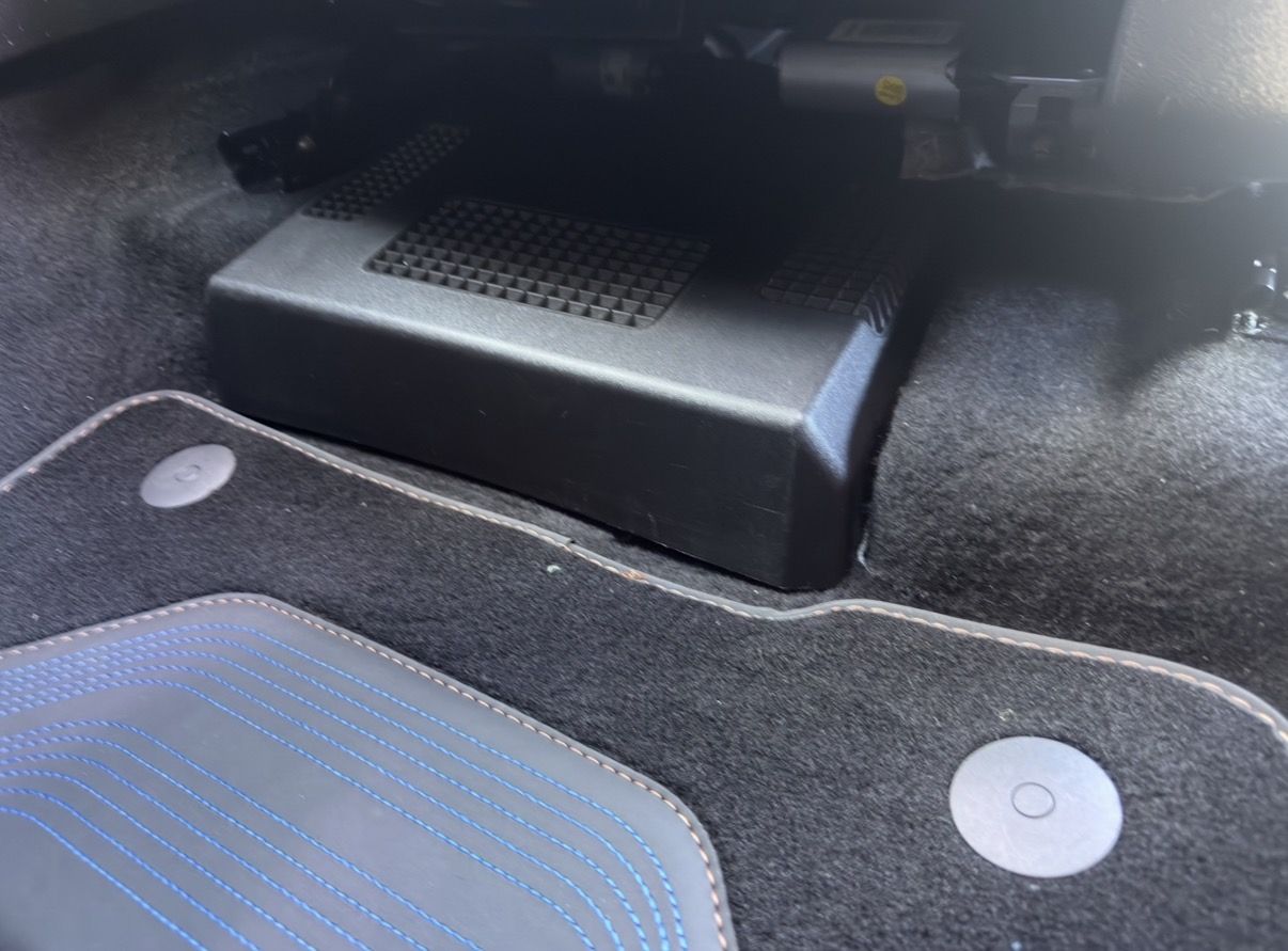

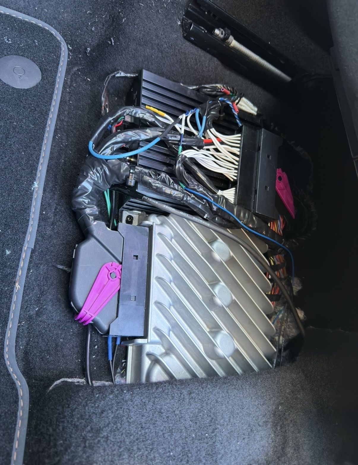

DSP PLACEMENT
  • Mounted under the front seat; space is very limited
  • Cables are stiff → difficult to route cleanly
Alternative locations were considered, but would require longer cables and be harder to hide.
Under the seat just fits, and with the cover installed it still looks neat
