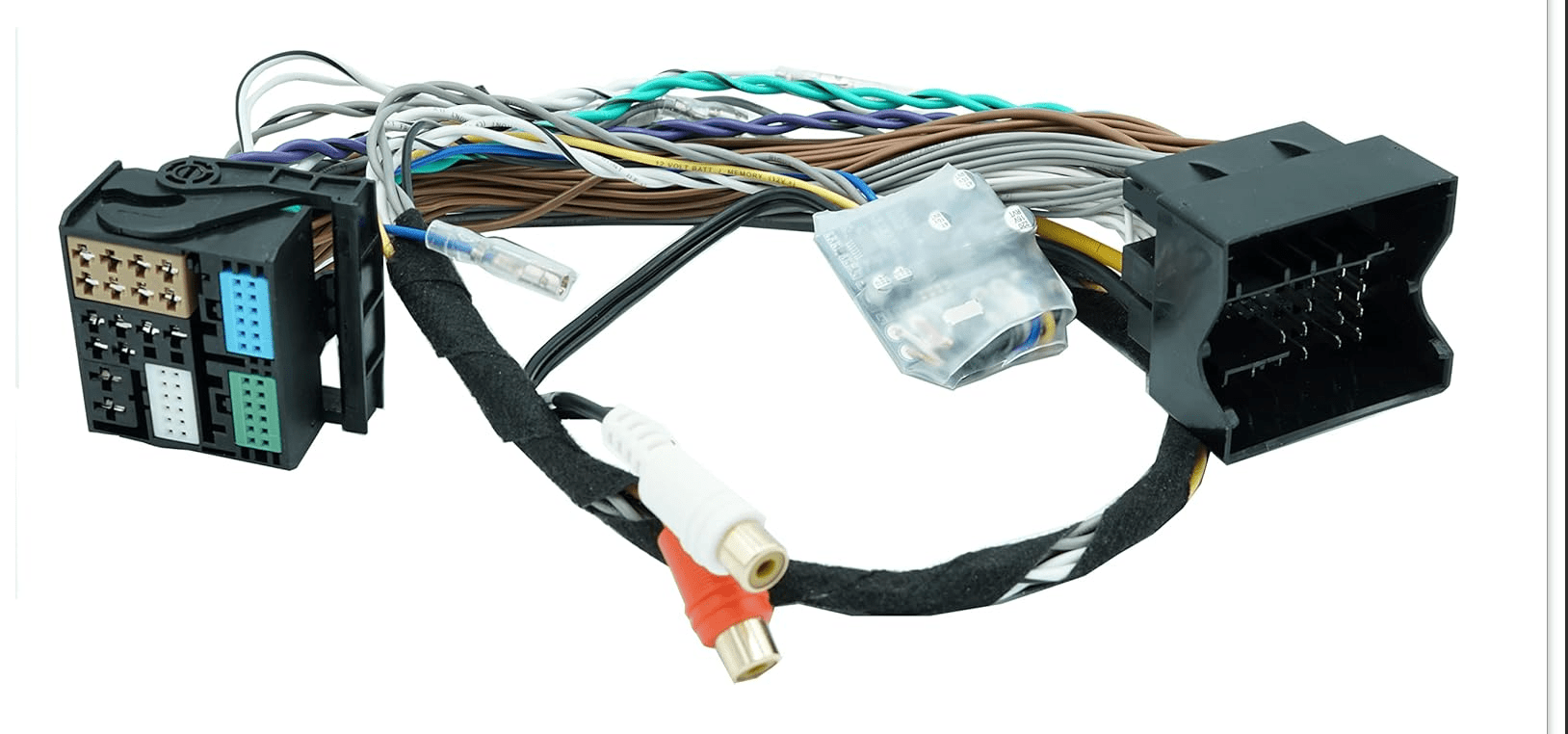

I have a 2019 SEAT Ibiza and I'm trying to install an amplifier and subwoofer in the trunk.
I've already run the power cable from the battery to the trunk. Since I didn't want to cut into the car's original wiring, I bought a plug-and-play adapter with RCA outputs and a remote wire that connects directly between the factory head unit (located in the glovebox) and the original wiring harness. I also ran the RCA and remote cables to the trunk.
For the ground connection, I used a bolt located underneath the rear seats.
The amplifier and subwoofer were previously installed in my Mk1 Leon and were working perfectly. The wiring kit is from Focal and is the same one I used before without any issues.
Everything seemed fine during the installation, but I'm having a problem: the subwoofer doesn't produce any sound at all. The factory speakers are working normally, and I have both power and remote signal at the adapter and at the amplifier.
If I disable the LPF (Low Pass Filter), I can hear music coming from the subwoofer, but it's extremely quiet. As soon as I enable the LPF, there is no sound at all.
I've also connected the subwoofer in bridged mode on the amplifier.
What could I be doing wrong? Is there something I'm missing or overlooking?

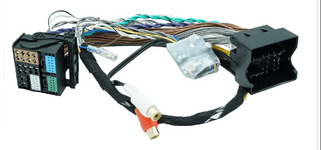

PnP adapter in the images
Any help would be greatly appreciated.

You don't need to change the coding
Your unit is configured to power the speakers directly. You've connected a high level to low level converter to the speaker outputs
If you reconfigure the unit for us with an external amp then it won't output a high level output
Original external amplifier communicates via BAP/MOST. Your amplifier doesn't communicate at all, it just gets fed a low level signal from the adapter

Hello everyone! Just came here to give you guys an update.
So the adapter showed in OP came with the "wrong" pinout, since it was getting the signal from the twitters and not from the main door speakers.
When to a specialist here in Portugal, that I give a huge shout out, Ignition Vortex, they figured out the pinout of the OG cables from the car and switched the adapter ones to match the correct pinout.
Tested everything and everything works perfect!
Using the RCAs of course.
So, tip of the day, if you order aftermarket adapters, always make sure they are the correct pinout for your car!
Thank you to everyone who replied and tried to help!
