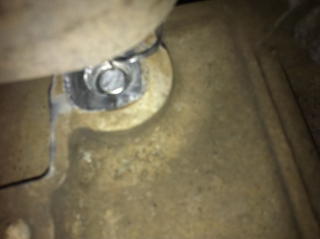

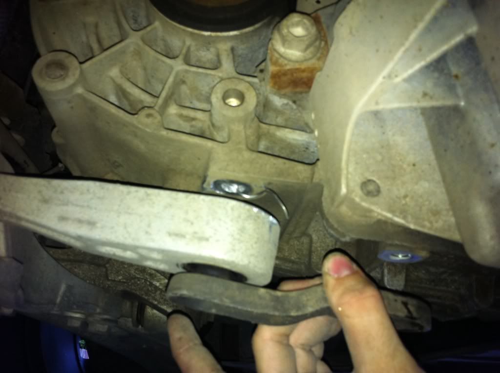

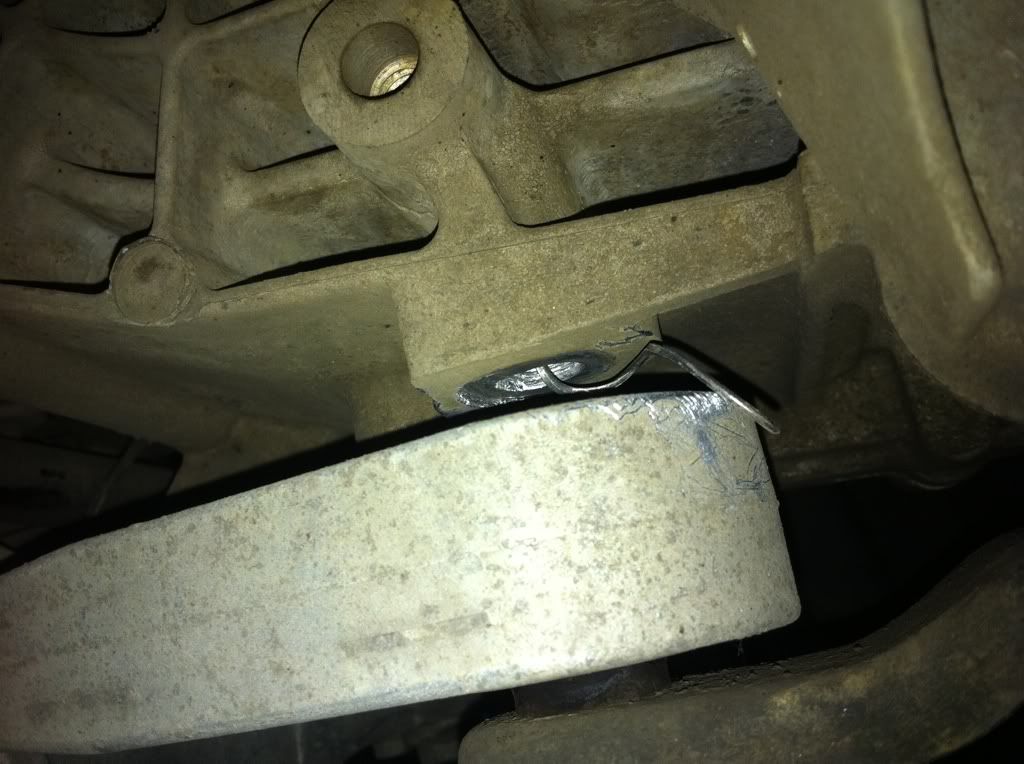

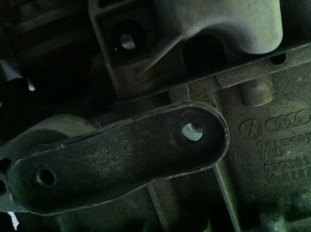

Well it's looking a bit more positive. Car is booked in and parts ordered. The damage doesn't seem too bad
Pics:
It seems that the rattle that I've been sending it in for since October, and that seat though I was making up!
It was the 1st bolt coming loose. Then eventually falling out. This then put added strain on the remaining bolt which sheered off. Leaving half the thread still inside the hole
