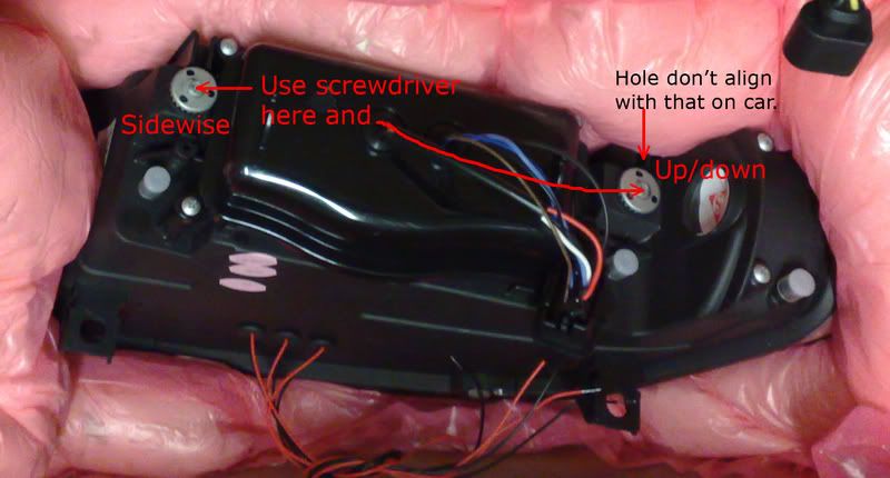

I removed the headlights and removed the levelling motors, put the motors back on again and put everything back together.
I can somehow now use the adjuster wheels, but not while they're (the headlights, that is) on the car. Strange.
I've no idea why they works the way they do.
The adjustment will have to be done by taking them on and off the car. Not very accurate.
Crap design if they don't line up when on the car, and a right ball ache to keep taking them of to adjust.
My sonar were a lot different to that.
Like this
Two little screws nothing to to with alignment.
That's done by the 4 screws you can see and each lens was adjusted separately, not in tandem like the Leon is.
