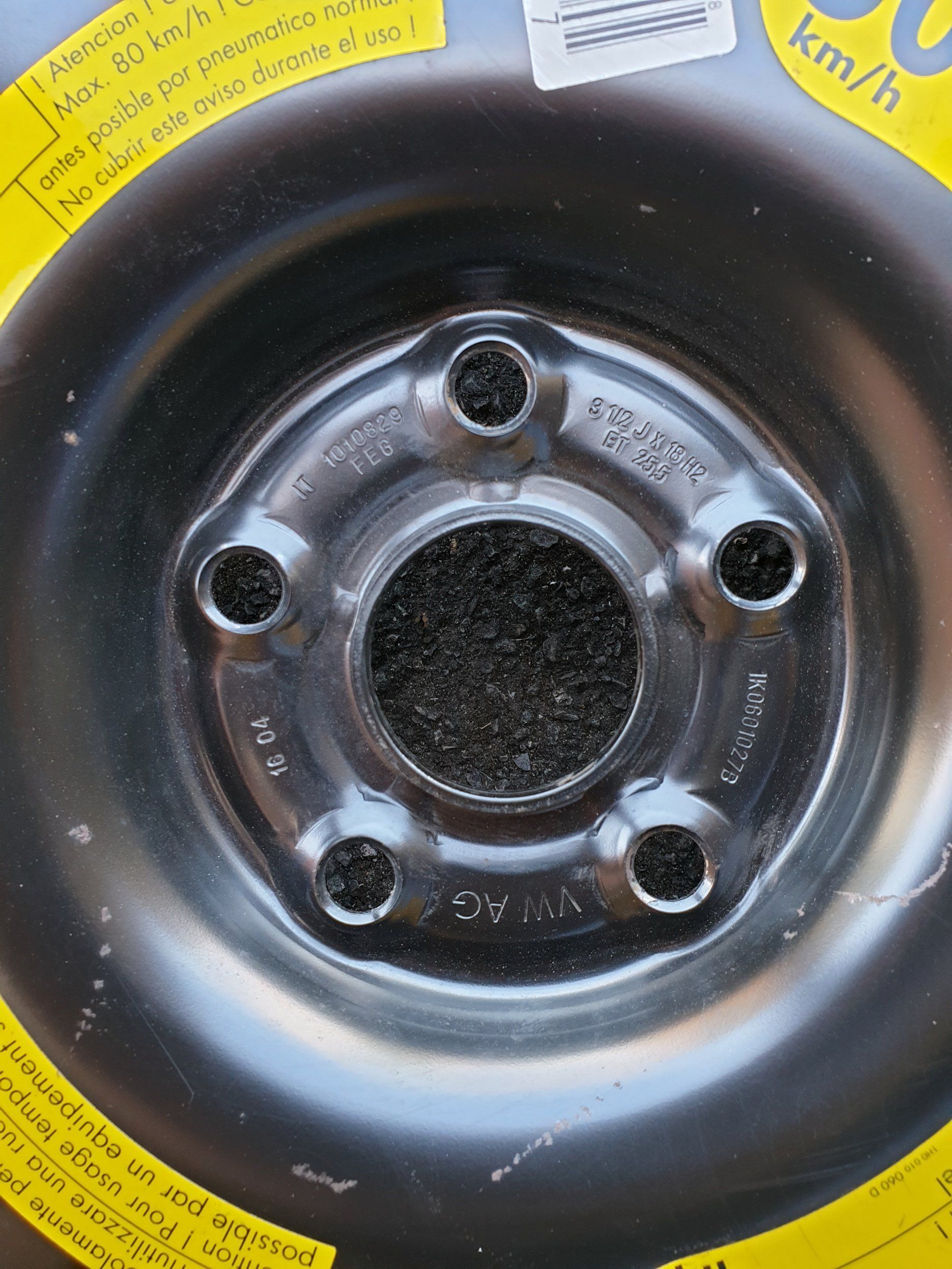

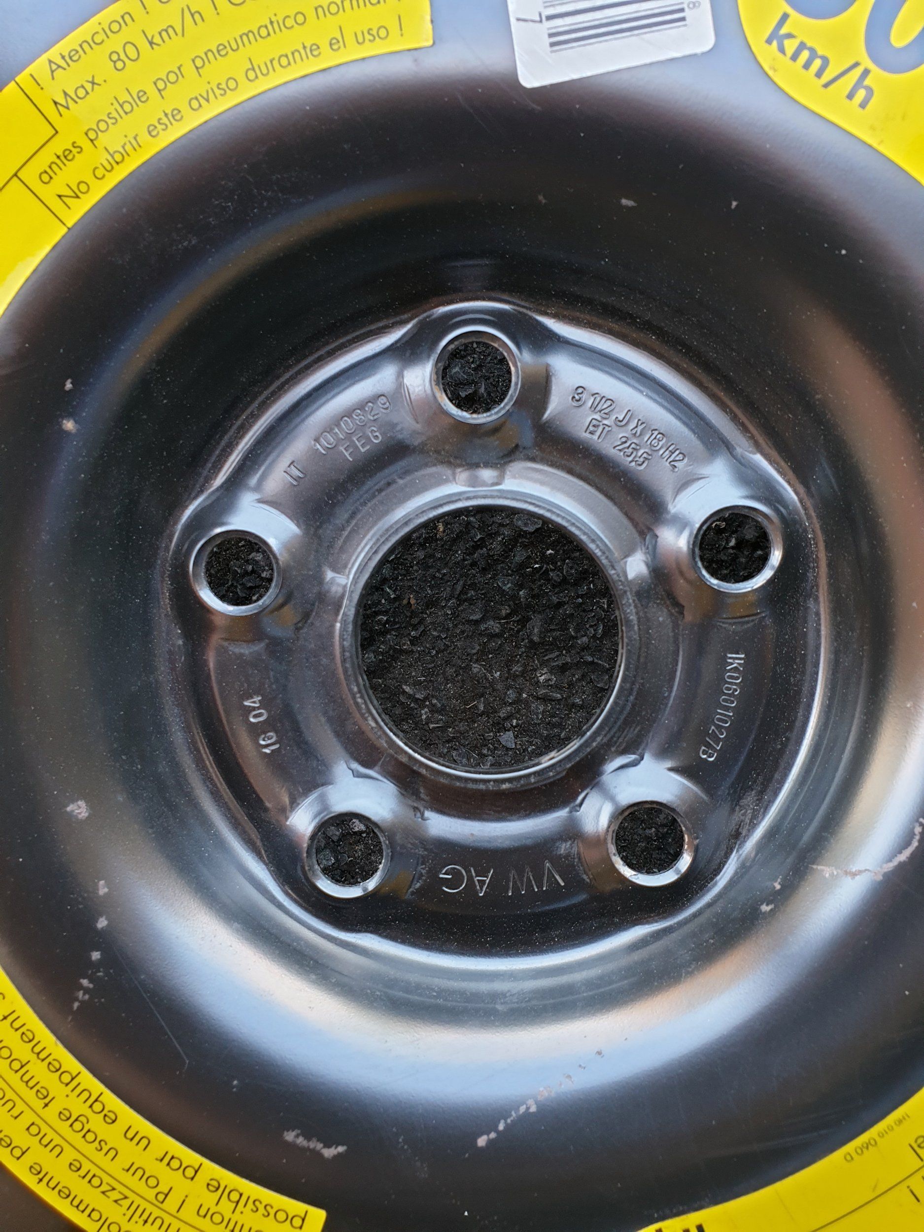

I’m going to keep an eye out for one of those, hopefully something relatively recent so that the rubber isn’t too perished. Have you ever fitted yours?
I've not fitted it, I bought it to replace 16" space saver so I could fit Seat Sound System subwoofer plus the added bonus of being very close to the 17" alloys rolling radius. I know it will fit as the PCD etc. is the same as my 16" space saver.

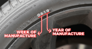

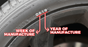

If you're getting second hand spare - make sure the tyre manufacture date isn't too old -
