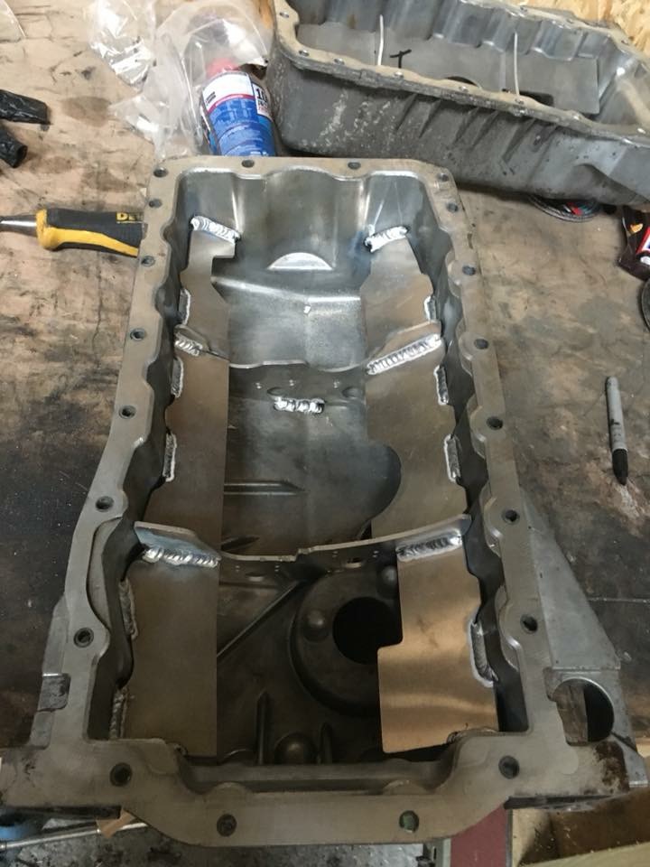

Took it to Bedford Autodrome for a track day and the car performed well but was sliding and dipping in the corners.
Fun to drive like that but expensive on tyre wear.
Also the car is pulling G’s in the corners and a baffled sump pump as called for.
Met a guy called Oliver Beaumont. He makes up sets of baffles to sell and also has fully assembled versions for sale too.
One baffled sump later and another oil change and it was good to go.

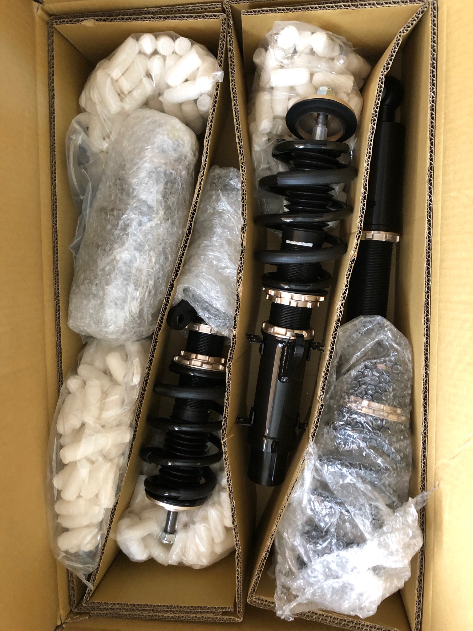

Next up was the need to address the handling.
The shocks were probably there from new and every bolt was seized and needed cutting out. New bolt set from SEAT.
Once out it was all replaced with a set of BC Racing coilovers. ( when buying you need to order the Audi TT 2 wheel drive version )
While it was all being fitted I was advised by Julian from Balance Mtorsport to fit Whiteline control arm bushing that increases the castor by .75 degrees.
It makes the steering more positive and allows power to be laid down earlier in the corners.
So I took his advice as it was a 40 quid part.
Went back o the track a couple of days later.
What a difference. Turn in controlled,feeding in more power earlier when exiting the corners, it all came good.
Reduced slip and much more grip.
So surprised at the difference. I can’t wait to be back on track.

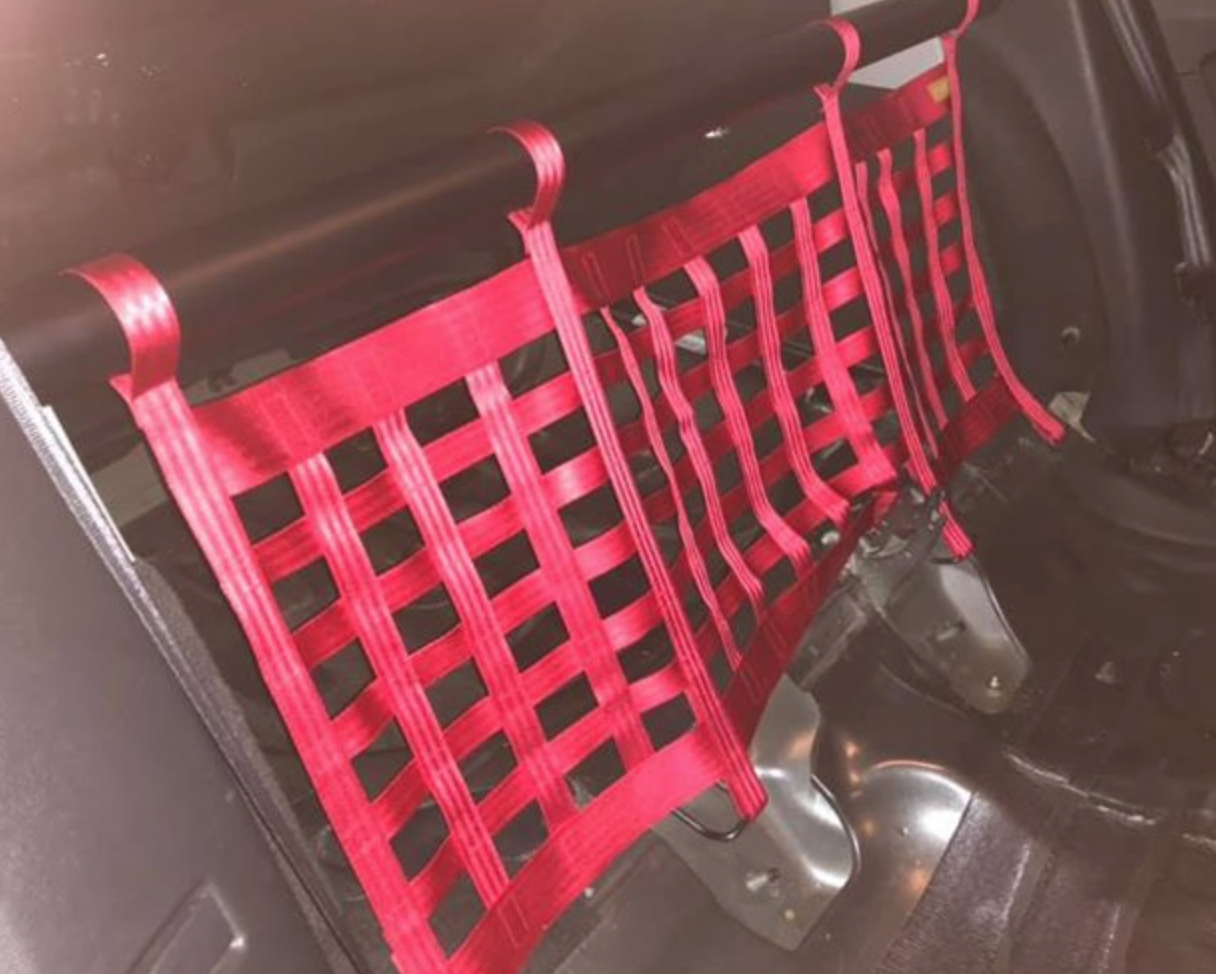

Are you going to leave the passenger seat in as well and do you have to get one of these fitted
