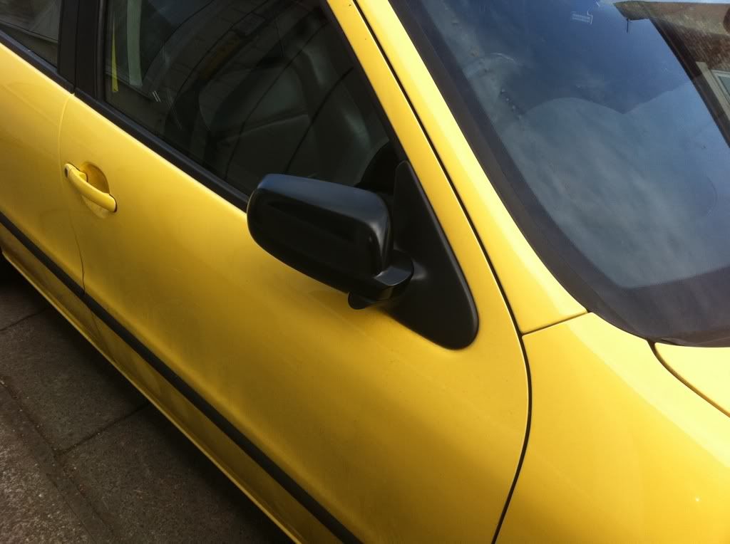

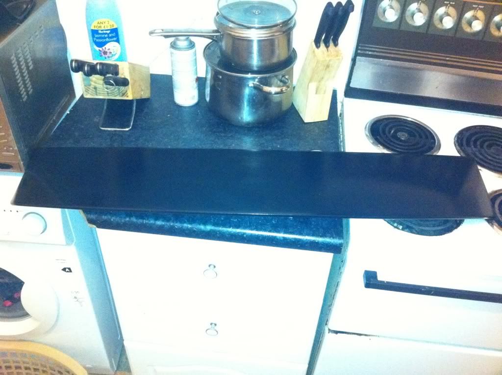

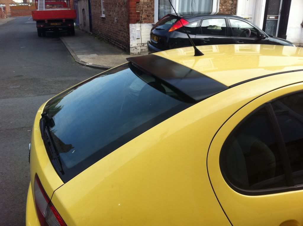

Hi all further to my previous thread about wrapping or painting my spoiler and wing mirrors, i bit the bullet today and painted them gloss black, i managed to impress myself haha, no paint running nice and even coats and a lovely shiny finish, heres a list of what i used:
1 can of plastic primer
few sheets of 180 grit paper and p1200
Few tack rags
1 Can of Plastikote Gloss Black paint
1 can of clear lacquer
and spaced the job out over the full day, only put last coat of lacquer on about 25mins ago, overall i put a base of 2 coats of plastic primer once sanded, and to be honest i think i put 5 maybe even 6 coats of black but real thin coats to prevent any running of the paint, and 2 coats of lacquer and im absolutely stoked with the finish, (wheels tomorrow haha)
What you think?

Good job mate, I used the plastikote myself.
How hard was the spoiler removal?

Absolute doddle mate 3 small nuts hold it on and the 3rd brake light is held in with 2 phillips screws, but unplugs under the headlining, took me about 5 mins once id located the bolts, should go well aslong as the diy roof carbon wrap goes as sweet lol

Small nuts the middle one is hidden under the plastic on the tailgate just pull it away and get a small spanner on it saves messin on taking the plastic off, Im planning on using the plastikote gloss black on my wheels tomorrow, ill post a thread of them when theyre touch dry

I gave two coats of lacquer, and i didnt wet sand, may do if the paint dont last, but then again if it dont last ill be wrapping in carbon vinyl :D

Have you got any pics of them back on your car?
Are you having the roof wrapped as well?
