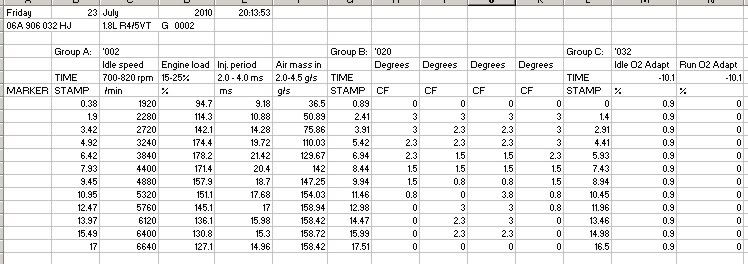

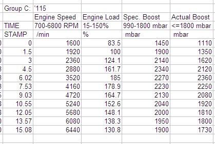

Anyway here are the logs:
The maf reading is lower than I would have expected. Actual boost looks a little low, and why is the Run o2 adapt at 0% all the time?
