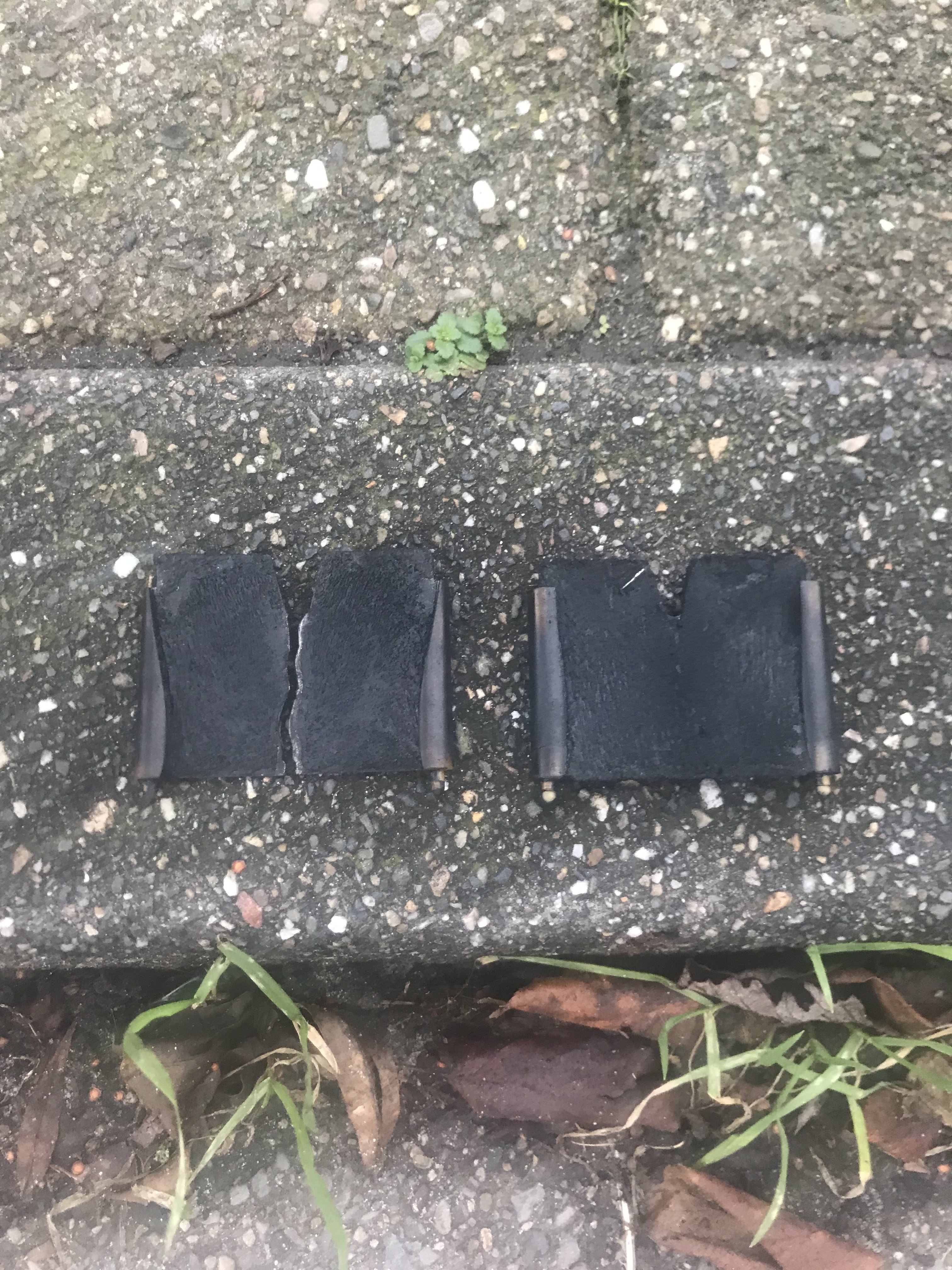

Oh and i removed the metal inserts from inside the head as one of them had snapped in half from excessive carbon build up!
Must of been very lucky tbh!

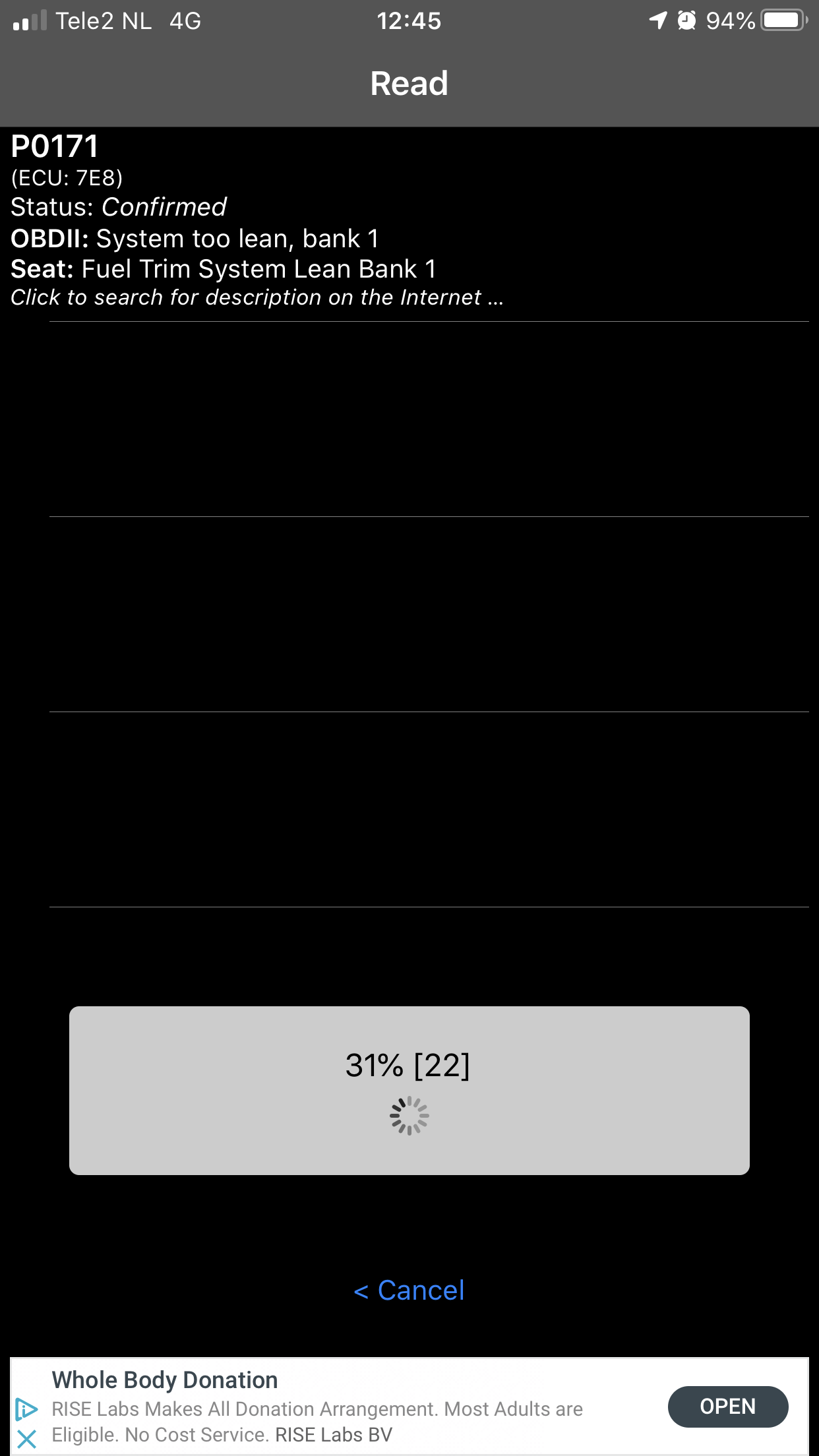

Started doing it again and now I have this code can anyone help the hpfp is new and the lpfp is new from VDO 4.4 BAR thanks in advance

Oxygen sensor (again) or vacuum leak. If you've had the injectors cleaned and assuming the fuel filters ok. It must be too much air getting in. You could probe the oxygen sensor, make sure it's within tolerance.

Thanks I just done the test and got 0 back from the oxygen sensor side trying all pins and the other side of the clip was between 0.24 and 0.35

That looks about right to me (in tolerance and on the lean side). Vacuum leaks can be hard to find. Maybe check over the pcv system next?
