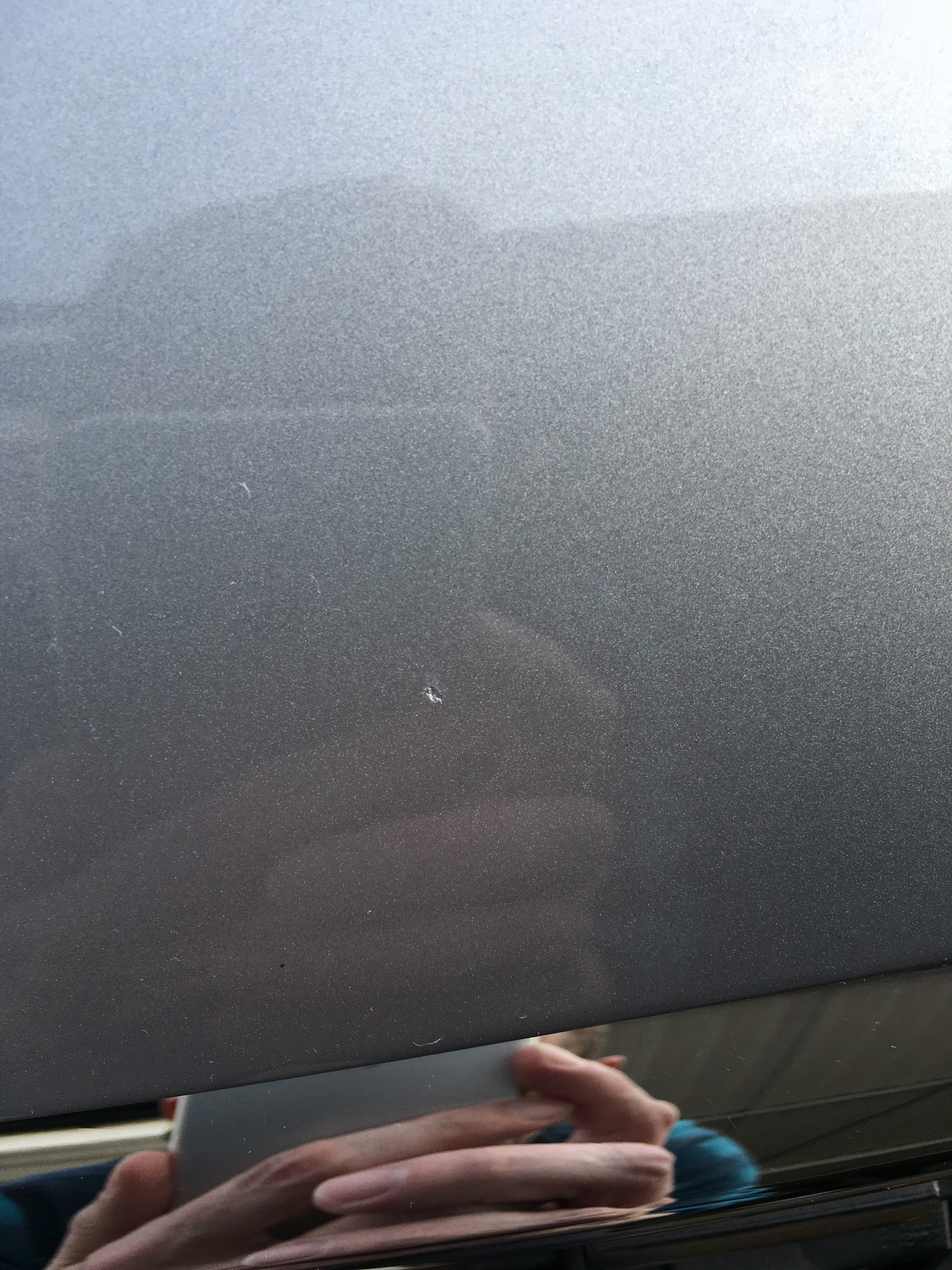

nokiauk
Full Member
Feb 9, 2003
524
25
Edinburgh
Not the best pic and its the only chip I have, colour match with Chipex seems good though I do need to build this one up a bit.
